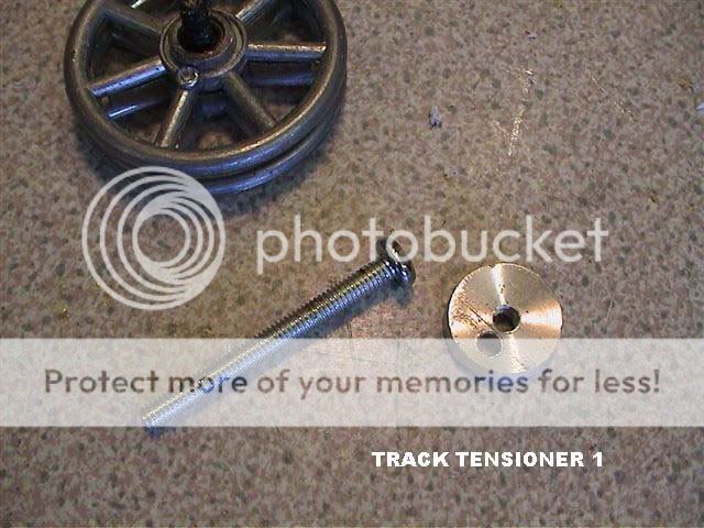

Managed to get some more work done this week. Zimmed the hull and turret front. I had some bolt-heads left over after I zimmed my HL StuG III so decided to use them on the driver's/co-driver's front plate. I never throw anything away - you never know when it will come in useful! (Mind you, I can rarely find anything I do keep!)
Made up some track tensioners (blatantly copying the ones on Tank-Modellbau). They seem to work just fine.
