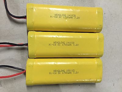

What kind of Battery are you currently using ? ...From your videos ..looks like they have plenty enough juice

ALPHA wrote:What kind of Battery are you currently using ? ...From your videos ..looks like they have plenty enough juice
I am using a Heng Long Ni-Cd 7.2v 1700Mah battery. Picture below
1700mah batt.JPG (18.25 KiB) Viewed 1904 times
You might consider getting at least one stronger one...those Batteries are ok...but may not be giving you the power you need.... ;)

ALPHA wrote:
I ordered a 2800mAH battery, is this going to be enough?

NGKGTATT wrote:
ALPHA wrote:
NGKGTATT wrote: I am using a Heng Long Ni-Cd 7.2v 1700Mah battery. Picture below
LOL...Anything is better than the stock batteries lol....I think the real test is when you get your gearboxes back...You might want to make a set of test leads and test the gearboxes before you install them ;)

ALPHA wrote:
NGKGTATT wrote:
ALPHA wrote: You might consider getting at least one stronger one...those Batteries are ok...but may not be giving you the power you need.... ;)
Changed the battery to 2800mah, my KT is running fine with the new gear box. Well, surely it is the old 1700mah battery's fault(worn out maybe). :haha:
