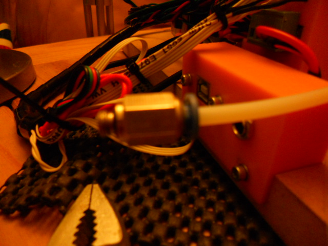

Well something has stopped me, lol, the filament tube goes into the hot end through one of those cap things that are a push to fit and then it never comes out. Grrr. I am now left with a short piece of filament stuck in there and there is no way to get the tube back out that I can see, so I will have to see if that comes as a spare part.

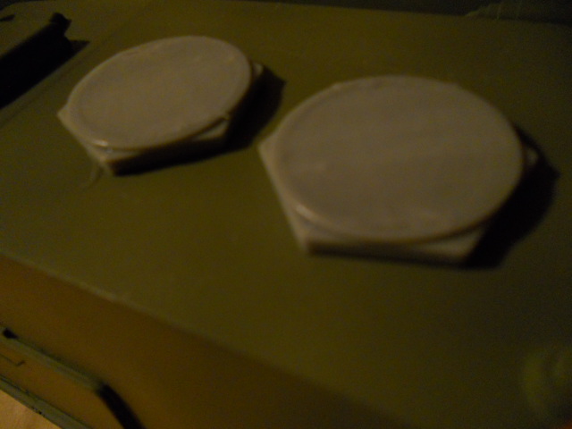

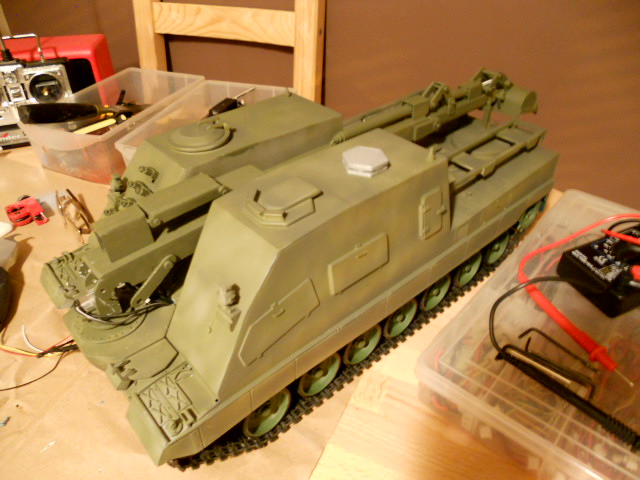

Anyway just before that happened I printed these two halves of a hatch for the Kodiak.
Very impressed with the quality and speed of printing, and soon as it is up and running again I will be back seeing what I can design and print.

The rod and bowden cable was next. The Bowden cable socket was a write off as they are push fit and one use only. Not a problem as these are only a couple of pounds on Ebay (they are just standard air hose fittings), so ordered two for good measure.
