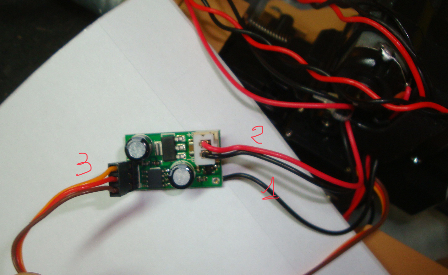

I think there is confusion? the video shows a modification of an Asiatam system? which is not the case. the concern is that it is the new system from Taigen, which in order to make disassembly easy, used connectors instead of soldering as originally. This must work on HL, but in this case, not simple without taking part of the wiring
wiring,
1: signal wire, taken from the barrel recoil switch, rearmost pin
2: platinum power supply, from small inter-general plug
3: link to the reversing servo,

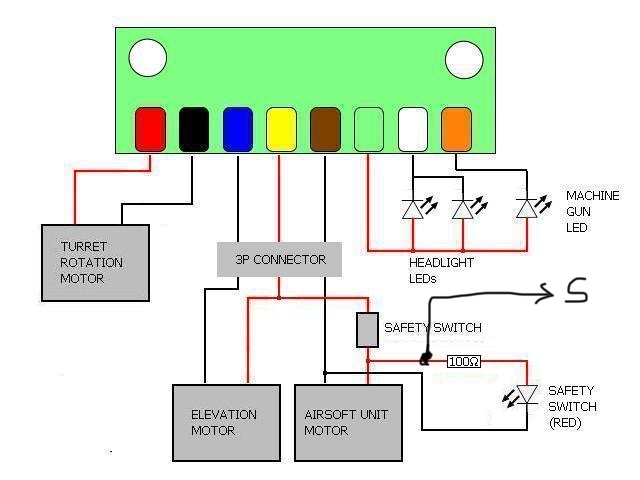

Operating principle: during the barrel recoil it is sent more than 5 volts on this plate, which converts this into a signal for the servo. the 3-pin plug (red, black, black) is the gun elevation and firing motors, the red one Being common and black each engine, schematic attached. Hope I'm clear, and sorry for my poor English.

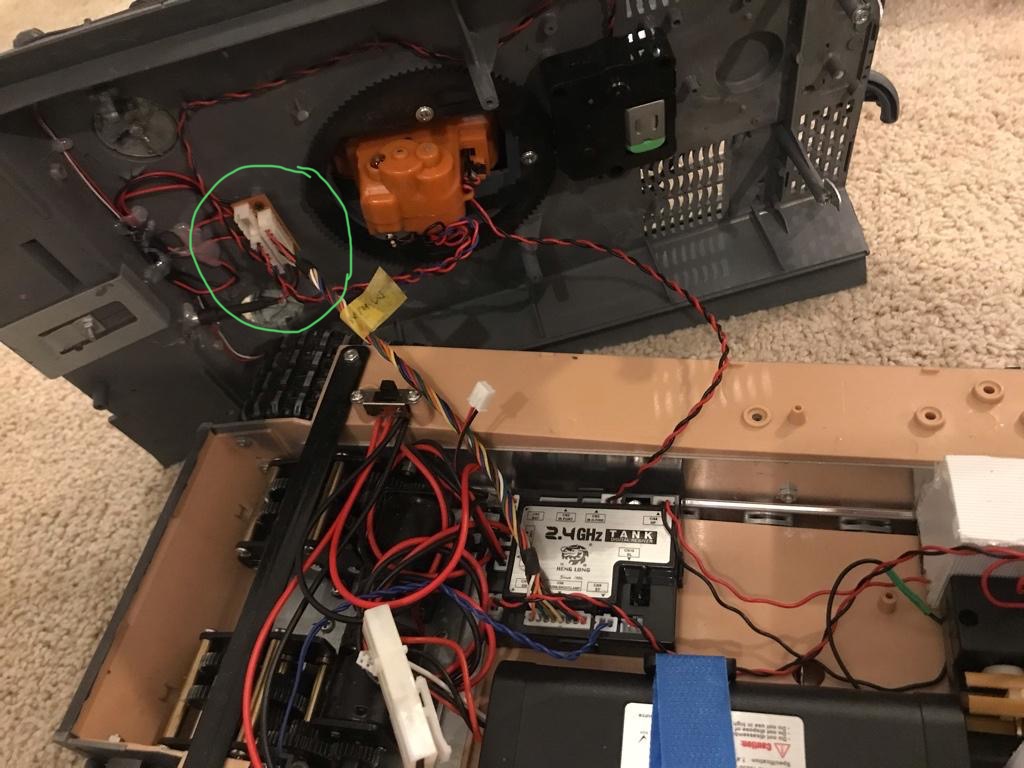

can you do this photo again? clearer and sharper, in order to better see the existing connector? is that your top frame? there is only the turret which is Taigen? if this is the case, should be simpler for the resumption of the wiring

Hope these help?Image
