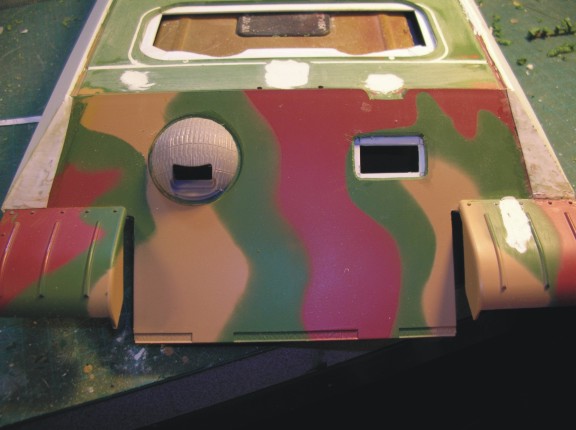

When last we met I had shown how leaving the skirt armour ledge on the G let me make the 40 degree angle perfectly so we attached the sides and I closed off the front spaces with some styrene and then ran superglue around all the edges and taped them up to seal off the hollow triangular part. I also at this time refined the hull fit a little more with some tedious sanding of hull meet locations... Then I had the brilliant idea to pour resin into the hollow space to make sure it bonded to the hull and it would add firmness to the structure as well. Problem was I thought I had it all sealed but I had a couple of little spots that it leaked!
But I dealt with it and the nice part is where the resin ran onto places like the front fenders, and down the sides a bit you can work it off carefully with an xacto knife. I didn't take any pics of the mess just this one looking down the hollow.

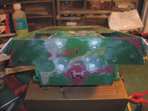

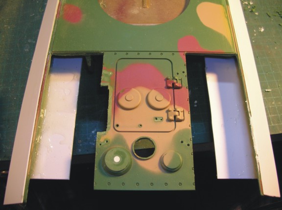

After a couple of days the resin has set up enough that I can handle the hull no problem. So I turned my attention to the back engine deck and cut out the outside panels which are going to require a complete makeover. I also started putting in the styrene support that will hold the new panels in place.
I then put the back plate back on and tightened it down in preperation for doing the rough finish of the rear hull...

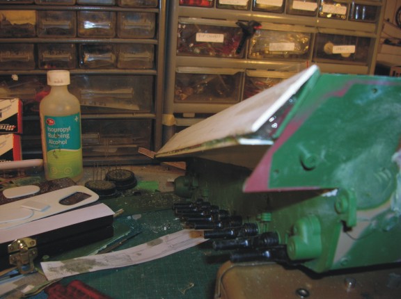

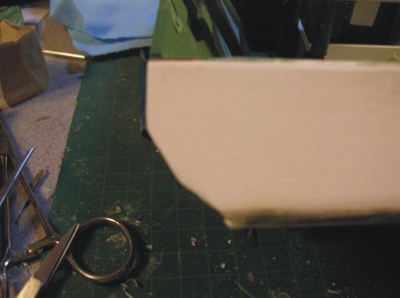

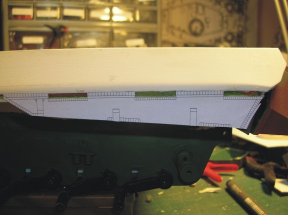

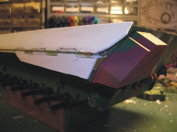

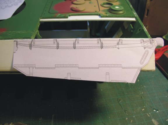

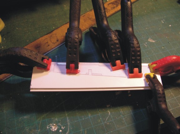

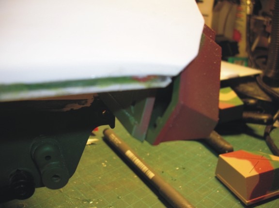

so to add the vertical piece of armour at the rear, first, I again used my drawings and cut out the whole side piece and tacked it on the side in position. Then I drew the cut out edge on the styrene and cut it. I elongated it a little because the paper is only 2D so you have to extend the cut lines a little to compensate for the real thing. I pulled it off and reversed the paper to do the other side. Then did the cuts Next I test fitted the rear storage boxes to check fit I then cut out the actual lower vertical plate by itself and tacked it on to see the fit and position I am going to fill this small opening with styrene no issues. Next tacked 2 pieces of styrene together and tacked the paper on so that I make 2 identical pieces at one time. Cut with a dremel and filed down a bit and then split them apart Marked the lower hull and notched it out and fitted in and glued for the moment. Because this will all be covered by zim it doesn't have to look too pretty...

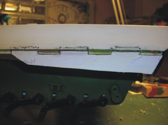

And one more shot I will be building a box behind the vertical plate extending in to the hull like on the real thing and that will give the vertical plate strength against any whacks the vertical plate might take battling.
