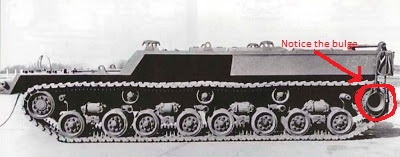

Hey guys I found this pic, which could be the answer, or the question to my build. Notice the bulge on the rear sprocket, it could be the connection between the outer and inner tracks.
What a monster tank!

seejianshin wrote:Hey guys I found this pic, which could be the answer, or the question to my build. Notice the bulge on the rear sprocket, it could be the connection between the outer and inner tracks.
Shin.... there is not connection of the tracks themselves.... four separate rows....Anyway got good and bad news for you.... you remember Sassgrunt... well he dropped off the set of sprockets he built up... as he isn't good with photos... so I'll take them apart and photograph them for you
