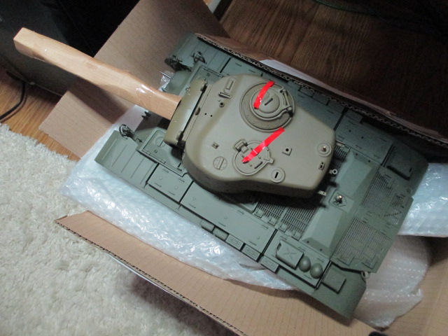

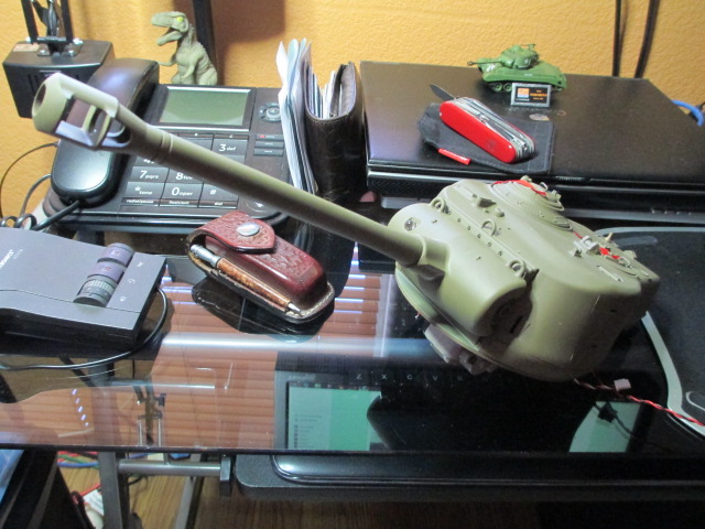

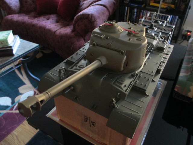

Post was good this afternoon with a modern deck and airgun equipped turret from the inestimable Forgebear Team and Squadron Signal's M26 Pershing in their Walk Around Color Series by David Doyle. This book is amazingly in depth and will prove most useful. Waiting on some detail bits and the MFU and TX from Mato Mart. That will tell me how much of a modern wiring harness I need to come up with. Pics:

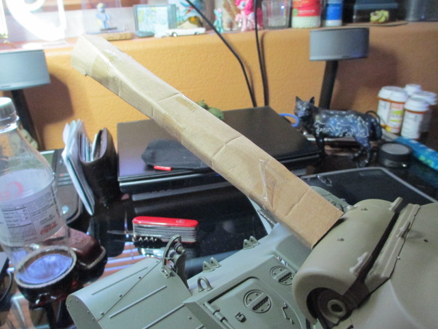

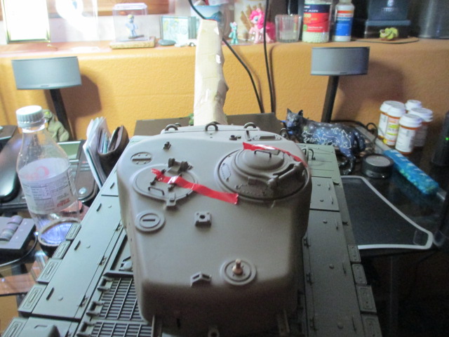

Re: Heng Long Pershing Rebuild
Did HL fix the barrel length?
- Posts: 7864
Alpha,
Heck no. The barrel is the same length and diameter as the original one from years ago. Elsewhere, a little soldering will be required on this replacement turret airgun motor but it has the two pin plugs. ;o) Same with the deck turret rotation motor tho' there is no MG led hooked up to the bow. The old one should suffice with some soldering. There is a refreshing lack of glue globs on these pieces. I'll dig around and find a wiring schematic pic of what goes where like I had to do on 'In The Mood'

Good Afternoon,
Alpha, yes, it came with the small board up front. I found some pics and it looks like the MG wires in there. The three pin plug from the main gun goes there as well as the eight pin to the MFU. I will need a wiring harness to get the eight pin cable and a new pinned battery hook up but they are available and not very pricey. All is good. ;o) When your barrel comes in, it should work with either mantlet, shimmed or not. I'm looking forward to seeing it on the tank and dropping the fat, stubby one it has worn all this time.
