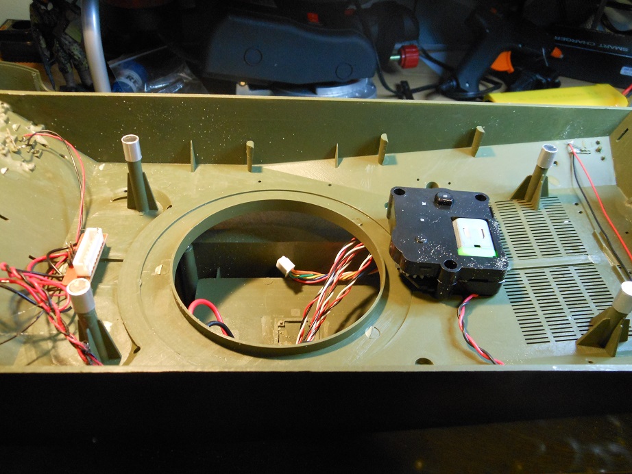

Re: Marc780 KT Part 9 Adding a Fan to the RX18 Box
Cooling always is a good idea, unique mounting location for your Rx-18 unit. First time I have seen that location used.Well done.
Well the tank was not a smoke and sound unit. I made the mistake of assuming they all were, this one was from hobbytron and came without s and S, and even worse, the old TK-01 circuit board (which burned up after an hours use). So thats why i upgraded.
Without the smoke gear and speaker that would normally occupy that spot it left me enough room to glue velcro to affix the box to the rear of the hull conveniently, right below the engine vents. I thought of fitting another fan in the inside of the upper hull, rightbelow the vents (not sure whether it should blow air in or out) but that idea may be just overkill... if the one fan doesn't help circuit reliability (this tank came with the crummy old TK 01 board like i said, and the mosfets that enable the tank to turn, burned up in an hours use) its not likely adding another fan would after all although it might be worth a try.
