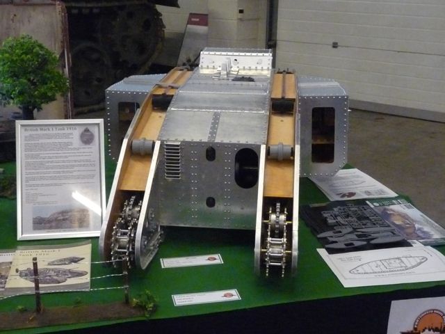

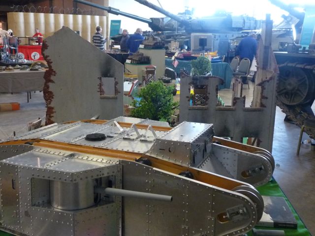

Hi Guys,
Some more fiddly bits have arrived and managed to get a few of them on the model before the show on yesterday. I went to the Model Show at the Fleet Air Arm Museum and talked tanks all day. :)
The photos aren't brilliant, so I will try and get some of my friends. I should get the rest of the parts on this week and will try to get some photos up for you to look at.
Helen x

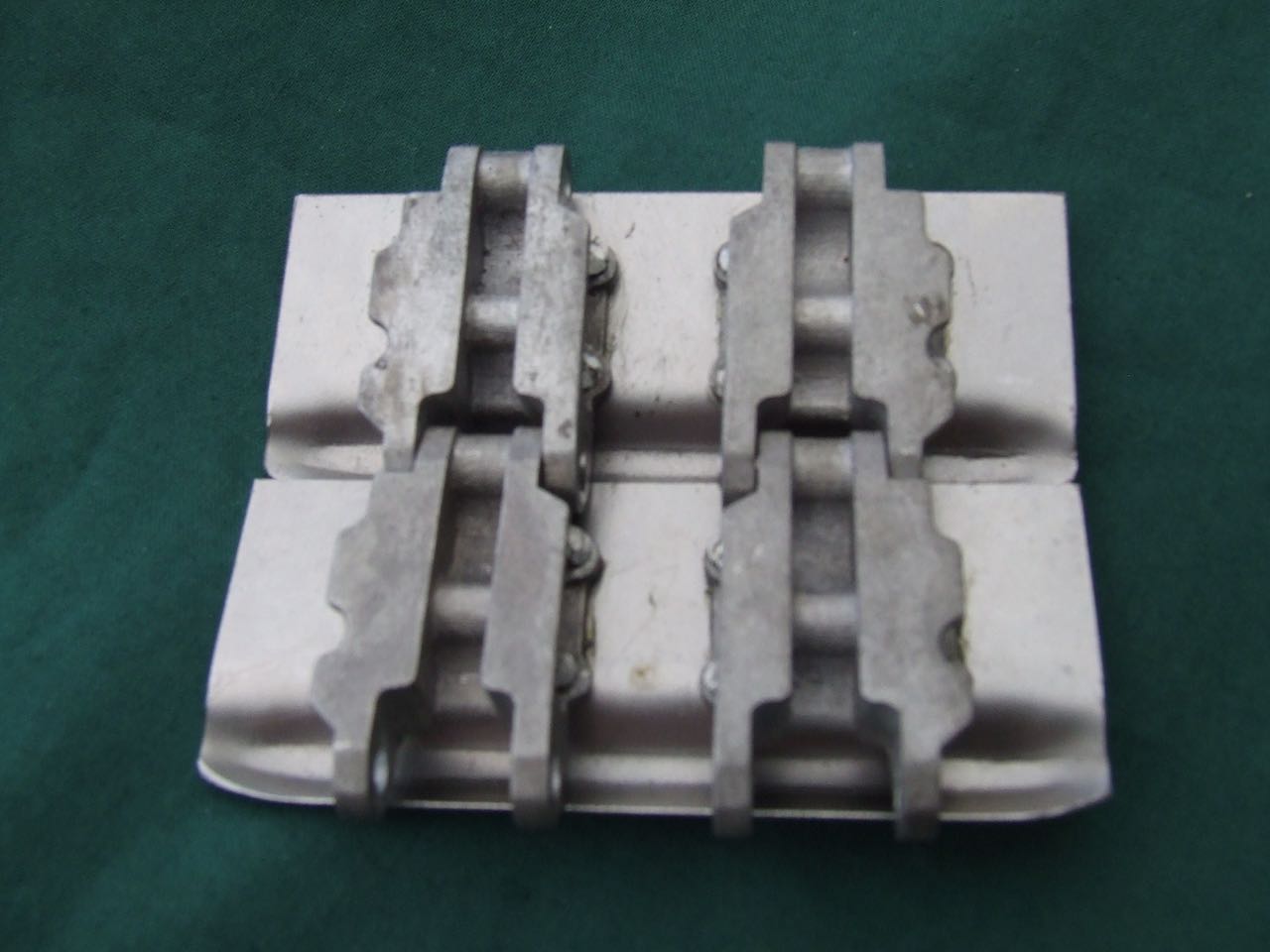

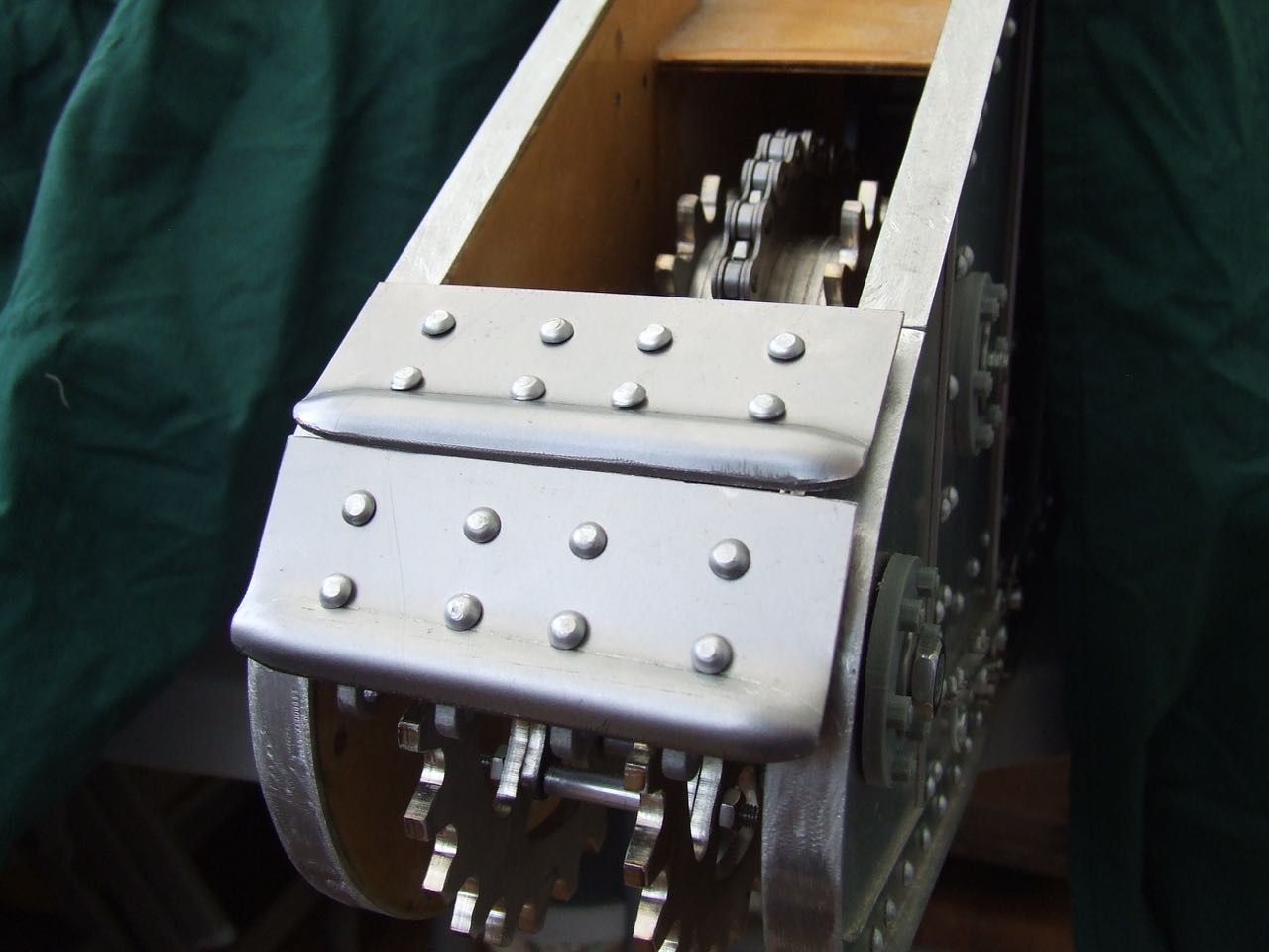

Back again! :wave:
Recently reached a major turning point in the build... I have begun the Track at last!
Ok there's probably a months work still to go, but at the end of it there should be my first chance of seeing the model move. The list of things to do are still quite long, that list now is at least starting to shrink at last.
The track you see riveted up in the photo are not the final ones, I had to tweak the track plates a little and now all the rivet heads sit nice and level.
The links are being thread locked as we'll as riveted, this is not just to strengthen the join, but also to stop rust forming between the two metals.
Hope you like.
Helen x
