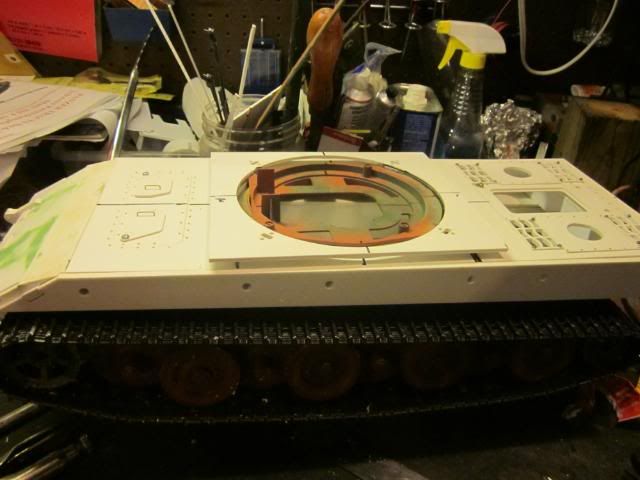

Well, time to give this beastie a turret.....so its time to cut up the king.....
not sure this looks right.....
ok, the plan is to use the hl turret treverse and guides as the are tough to screw up.....
a test fit before I glue the hl turret base to the e100 base...
and the turret base is mounted....

Koubiak wrote:your turret base,is some high,no?
Because the turret is so dam big, it needs to be high enough to clear the front vent fan housing , hatch handles and the rear air intake housing when it turns....I have though about notching the turret corners in the front( like the king tiger turret) and making the rear "stepup" higher for clearance..but that is not how the turret is drawn....I am not the first modeler to notice this....I first saw this problem here....
http://www.armorama.com/modules.php?op= ... _id=172494
Its interesting that this was the second Krupp turret design for the super heavy contract....it was the light weight design, it only weighed 35 tons. The Maus turret was the first design and it weighed 45-48 tons. I think about it like this, Krupp design 1 = a KV-1 ontop of your tank, Krupp design 2 = T-34/85 ontop of your tank. :wtf:

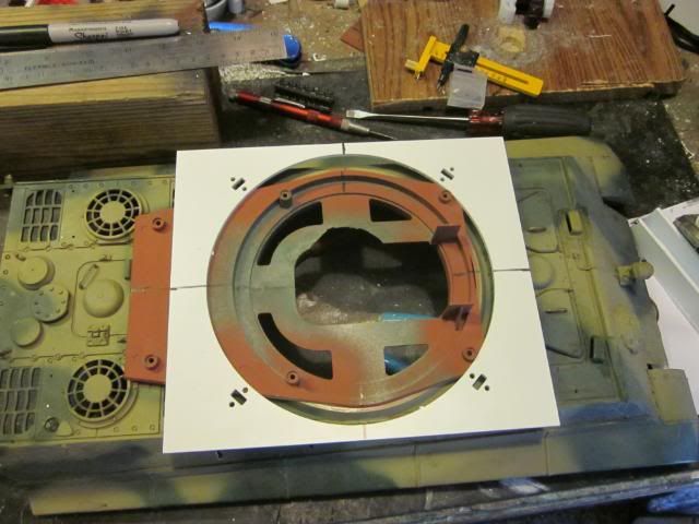

Ok, time for another update.....here is a issue....turret to hull clearance....
lots of smoking plastic is in the cards....
While I think about it, time for some more chopping on the king tiger....
Oh no! What have I done!!!!
Now some time with the sand paper...
more pics after I rub all the skin off my finger tips.... :/

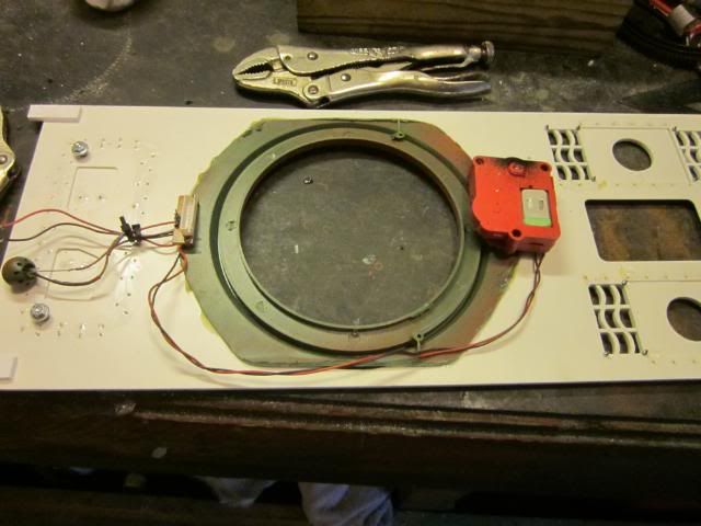

Spent some more time on the tiger mouse again last night.....hull deck bolts, I tried 1mm from scale hardware. Didn't look right and cost way to much so I got some hex plastic stock in 2mm and slice cut about 200 of them for bolt heads....
then I used a larger drill bit and ran the drill backward to couter sint the bolt holes....
here is what it ended up looking like....
got done sanding all the extra stock off the king tiger peaces...
and used the driver parascope to hold the hull down....
OK, now I have to figure out the turret....with this as a base...
