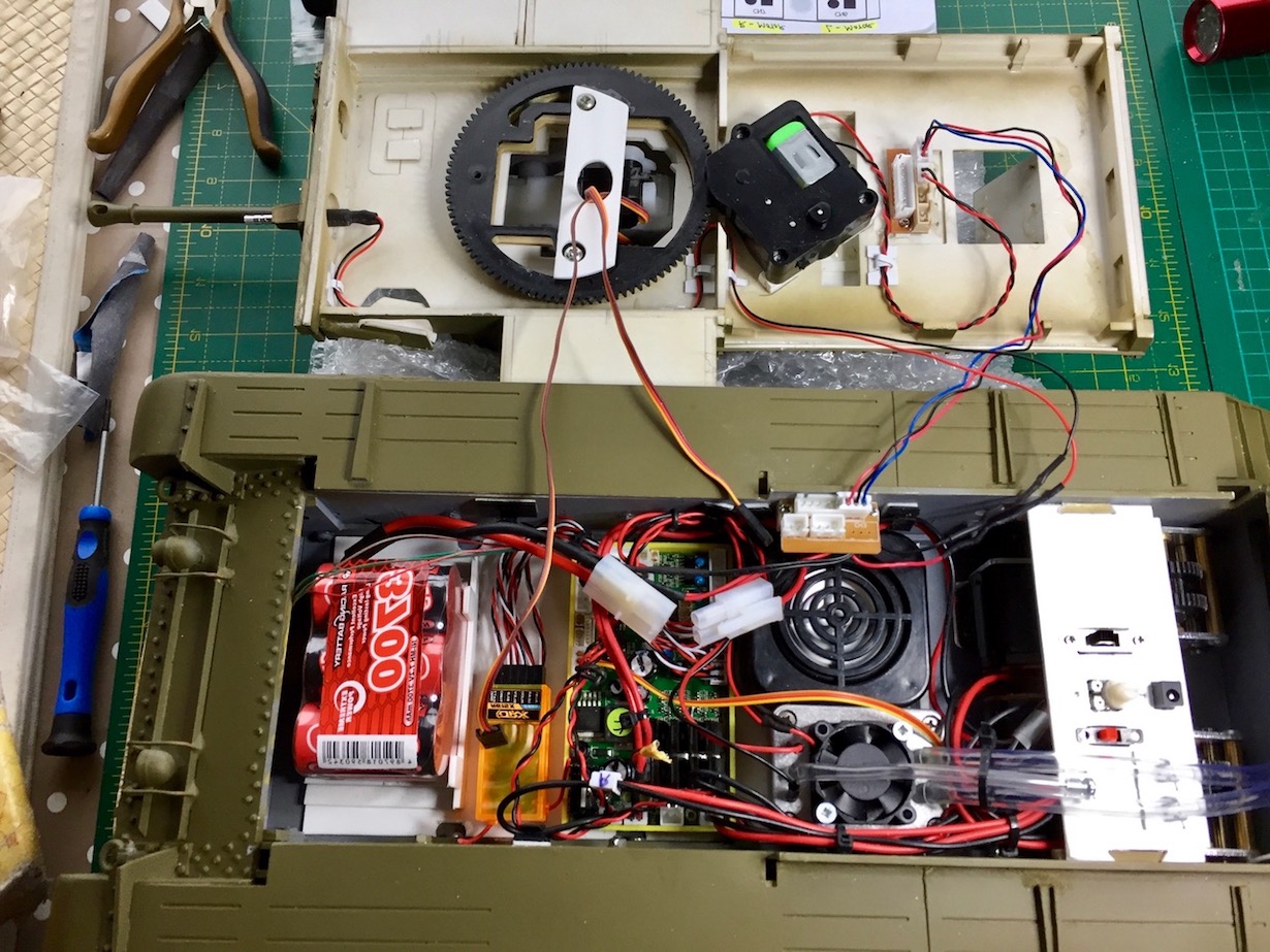

It's also dark after 3pm- so that doesn't help either. All that really remains is to fit the rotation unit, and then create spaces for the electronic components in hull. I'll use the same sort of internal arrangment I had on the Cromwell-
That was along these lines:
BUT... I shall be using the HL TK 6.1s, which should simplify some of the wiring, compared with my Cromwell effort (above)and the new (more compact) HL smoker. I also might try the newer slimline HL speaker unit (fitted to Panther etc..) As you can see from the pic above, it's necessary to cut a section out of the upper hull crossmember to fit the rotation unit in. Also, the Turret's not a tight fit in the upper hull aperture, so that demands a new solution. :problem: I used spacers on the Cromwell. This will all have to happen After Christmas...and all that unbridled excess (mostly Mr Bean Style this year, though because of Covid :thumbdown: but should I have some be-masked visitors, but hopefully not actual burglars 8O :D )...
