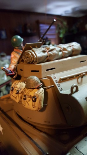

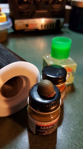

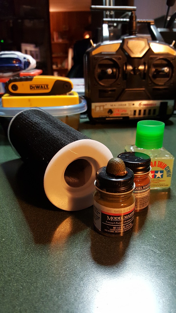

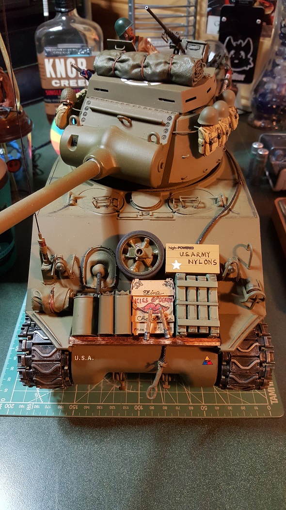

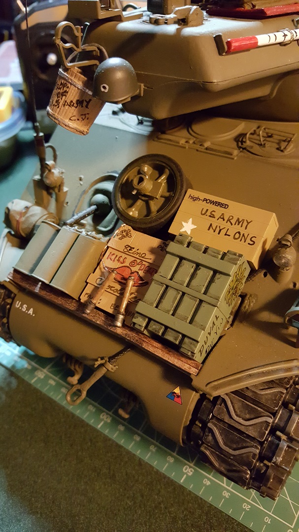

Tonight, I scratched up a roadwheel mount for the M36BI then threw together an American helmet net for Herman. I'll need to see how he likes it. Pics:

YYYYEEEEAAAAHHHHHHhhhhhhhhhh
Thats EXACTLY what I was hoping to see.
Finally a U.S. helmet with net cover
Nice turn out mate.............so ?
How did you do it and what was used ?
Really nice touch, and the chinstrap was an added bonus.
Tell me you aren't getting around with a 'shit-eating-grin' (its a term here folks-not a statement)after such a simple but well done detail.?

Re: 1944 M36 B1 Tank Destroyer
That is a great detail on that helmet.
That helmet is spectacular my friend! So impressive. Do spill the beans on your approach to this masterpiece

Herman, I'm glad you like that one. It was simple to make. As follows: Select the plastic helmet, acquire a roll of black lace from a 'Doll House' store ( make sure that the materials mesh is suitably small and thin ) and pull out your Tamiya thin cement. Cut a square of the lace mesh an inch or so larger all around than your helmet then drape the mesh over, pulling it tight with a twist at the bottom. Glue the mesh to the helmet using several coats of the thin cement. After it's dry, snip the mesh' excess off at the bottom and fold whats left up into the helmet gluing it into place with the cement of your choice. ( I used my LocTite Ultragel ) Measure a strip of the 3M clear double sided tape and cut to size. Drape it over the mesh and let it adhere. Paint it 'leather' then add your PE 'buckle' with a little more LocTite. Helmet: Complete.

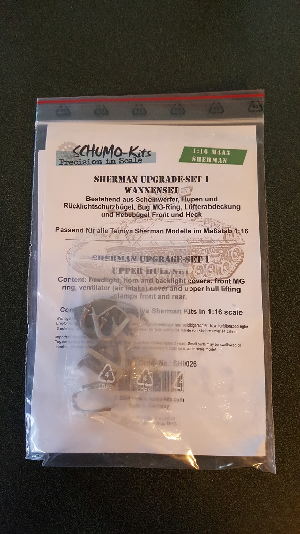

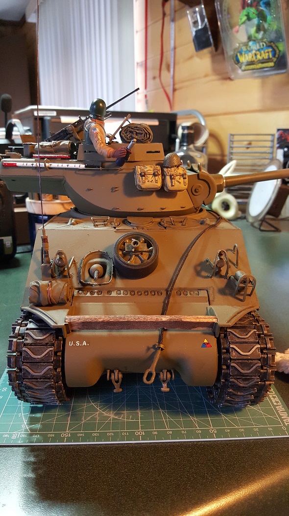

Today was a very good day. The Schumo kit came in so I spent an enjoyable few hours after work putting the last pieces on the M36B1. As it stands tonight, I have painted rope and chain drying so tomorrow will see both front and rear stowage roped and chained into place. I did get the front stowage securely mounted using the 3M tape. It is one block and can be removed all at once by pulling out the board it is mounted to. This is for when you want to easily remove the upper. More fun with flats and weathering coming then on to a Show Off thread and video. Pics:

It was all I could do not to call into work today and rather, spend the day finishing up this TD. I'll probably do some fine detail paint cleanup over lunch *chuckles*
