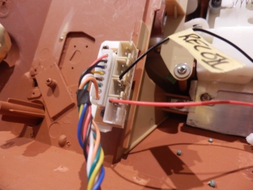

- Posts: 11726
Re: MATORRO JAGDTIGER CONVERSION
Yip, same as mine but I dont need the rotation.
I really did believe that having the complete set up of trans, rec, socket and cable would give me life, but no.
Pic shows the way the black-black-red wires taken out of the plug & placed independently.
The 2-pin socket above the black wire gives me elevation but uncontrolled from the transmitter.

- Raminator
- Posts: 1309
Okay, I think I've figured out how you need to pin these out. Using this photo as a reference, it looks like the topmost 2-pin plug should be for the elevation motor, the next 2-pin plug should be empty (it'd be turret rotation), the bottom 2-pin plug should be for the recoil motor, and the 3-pin plug will be for the headlights and machinegun.HERMAN BIX wrote:Yip, same as mine but I dont need the rotation.
I'm not 100% sure, but I think the positive and negative on the elevation motor should match up with the red and black wires in the 8-pin plug and the positive and negative on the recoil motor should match up with the green and brown in the 8-pin plug. It'd be best to confirm the signal and polarity with a multimeter beforehand if you can, but I think if you remove the white wire from between the two motors and run a new separate (red) wire from the appropriate terminal on the green motor that should give you the connections you need to use the Taigen unit with the new Heng Long MFU.
