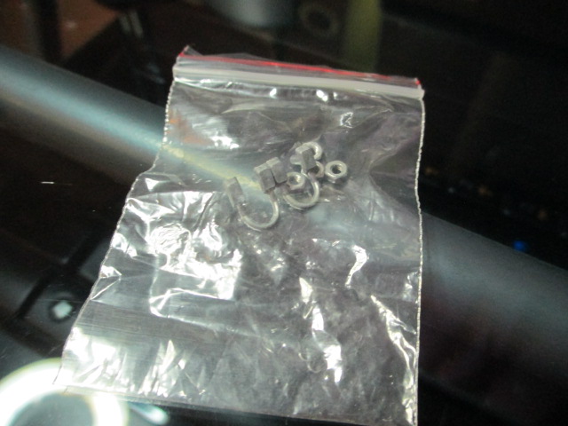

Post brought the last pieces for the StuG today. I had ordered through AliExpress and received some metal handles from Shantou-Mato. Alpha, I found the Skull decals yesterday. Peddinghaus to the rescue. Work on detailing and handles will resume after I'm over this Summer cold. Couple of pics of handles:
Nice metal handles for the casemate
Nice metal handles for the casemate.JPG (96.36 KiB) Viewed 3854 times

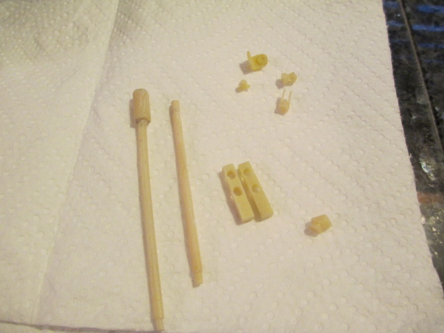

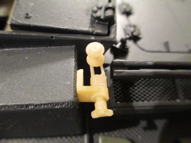

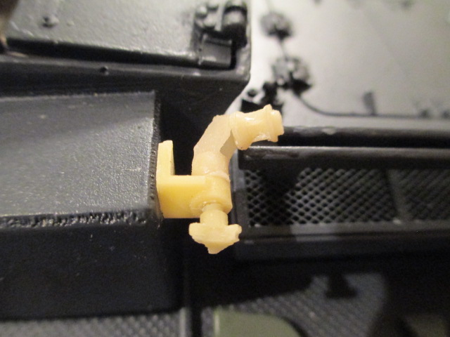

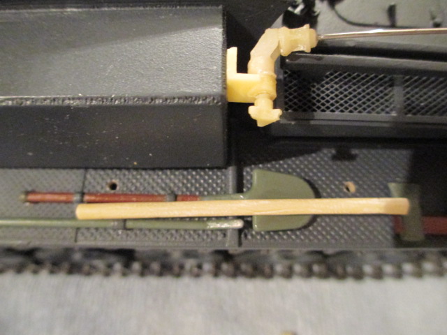

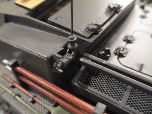

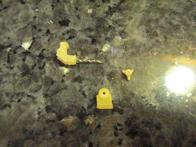

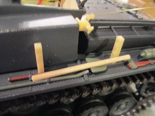

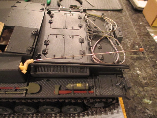

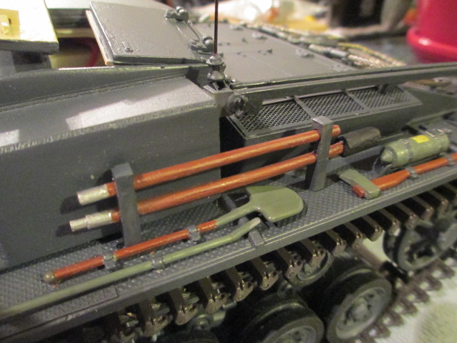

Alpha, thank you. I felt well enough last night to pick up work on the StuG. I wanted to get some of the last of the resin kit on it so I could switch to spending time on the special features I have lined up for the Gun. The resin is of good quality and takes paint well. The forming of the small pieces could use a little more work but with some patience and the yankee drill, I was able to make the antenna mount workable along with the cleaning rod mount. The pieces of the cleaning rod set came bent and it took some work to get them sanded and cleaned up enough to be usable. Even tho' I could, I don't think I'm going to be taking the rods out of that mount anytime soon. ;o) The StuG books were instrumental again in getting the configuration right. Pictures:
The knob on the mount is black but it's hard to see against the panzer grau.
Not too shabby for what I started with
The uprights were drilled and pinned into place
The uprights were drilled and pinned into place.JPG (98.43 KiB) Viewed 3835 times
Eyeball placement of the uprights using the shortest rod to measure by

A little long in the horizontal mode but I didn't want to cut another support out of the trough.
A little long in the horizontal mode but I didn't want to cut another support out of the trough..JPG (91.75 KiB) Viewed 3835 times
Workable mount
Workable mount
Workable mount.JPG (93.29 KiB) Viewed 3835 times
A piece of a #63 drill bit ( that didn't wind up in my fingers like others ) is used as the pin.

PainlessWolf wrote:Alpha, thank you. I felt well enough last night to pick up work on the StuG. I wanted to get some of the last of the resin kit on it so I could switch to spending time on the special features I have lined up for the Gun. The resin is of good quality and takes paint well. The forming of the small pieces could use a little more work but with some patience and the yankee drill, I was able to make the antenna mount workable along with the cleaning rod mount. The pieces of the cleaning rod set came bent and it took some work to get them sanded and cleaned up enough to be usable. Even tho' I could, I don't think I'm going to be taking the rods out of that mount anytime soon. ;o) The StuG books were instrumental again in getting the configuration right. Pictures:
Wish you had said something sooner Painless...Good resin can be bent...all you need is to heat it up...the best is a cold blast blow dryer...that way you can hit it with a shot of normal air after you got it to where you want it...those cleaning rods would have taken to the treatment well...the extreme would be like a sword or blade for a Gundam Kit ...those ...even in good resin are hard to get perfectly straight
