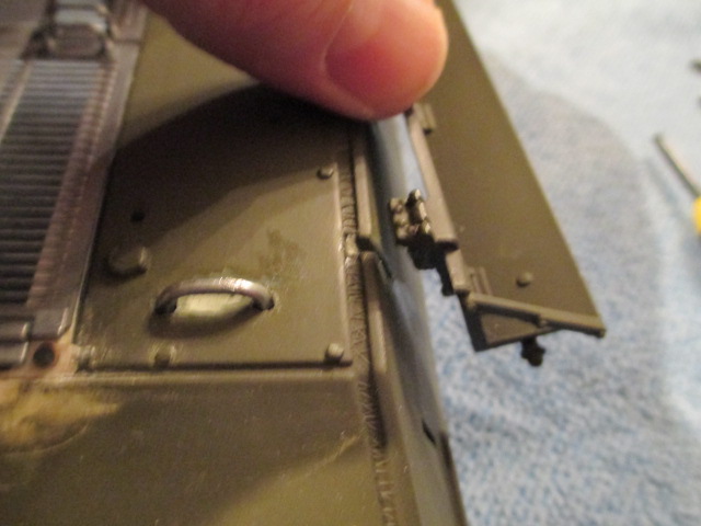

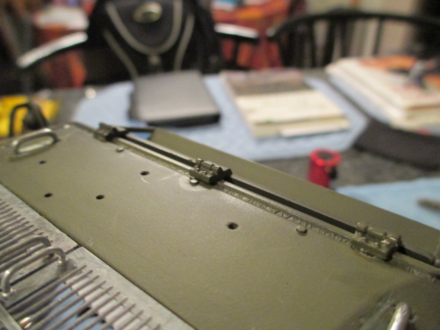

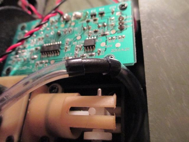

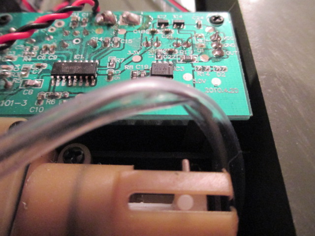

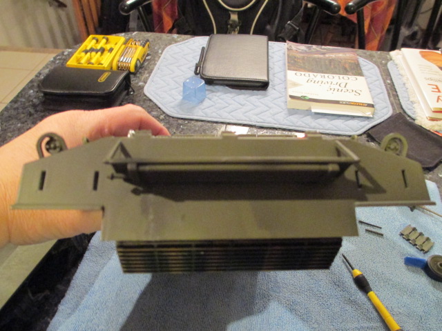

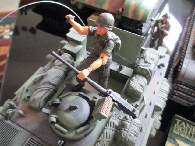

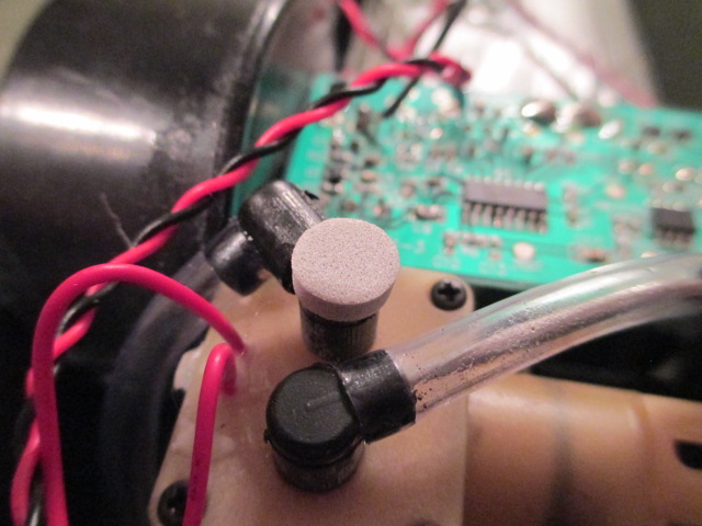

45th Day: I tested the bow .30 cal this evening to see what kind of light I was getting out of the LED when the MG fired and the light had to pass up that long Tamiya barrel without the optic fiber installed. I was impressed by the quantity and brightness but if you looked at it from too far of an angle the flash was definitely reduced. I ordered the optic fiber and it should be here in a few days. The fiber for the two Tamiya Shermans and the Pershing and the KV series is the same so if that information is of any use to anyone, there it is. ;o) Next, I had noticed while installing the FoV Exhaust Deflector that my bedroll rack on the rear deck was hiked up on one side. Fortunately, the infamous Glue Monkey hadn't been at it so a drop of Debonder was enough to make it release without breaking. I cleaned up the left side mount and reglued it properly and that was that. Lastly, I addressed the kink in the tubing for the smoker. I noticed that HL has taken to running a bit of wire down one piece of the tubing, presumably so that the smoker oil can run along the wire and have an easier time of getting into the smoker chamber. Of course, this wire was in the tube with the kink and in the course of repairing it, the wire was snipped. This was of no concern since I had already decided to open up one of the plastic caps on top of the smoker and refill it that way since the engine grills on my Sherman's rear deck can be opened. Pictures:
- Cleaned up and reglued
- Cleaned up and reglued.JPG (93.21 KiB) Viewed 2455 times
- Bedroll rack detached
- Bedroll rack detached.JPG (85.86 KiB) Viewed 2455 times

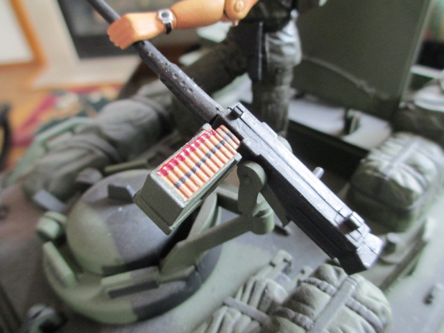

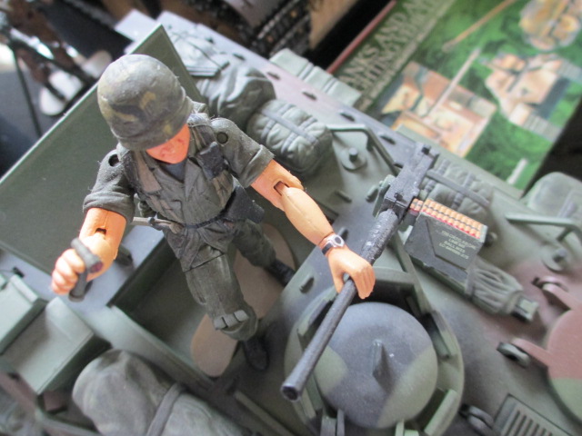

P.S. Some meager past attempts I have made to paint molded plastic ammo. Pictures:
I am very interested! That is some creative and inspiring work there, Sir. ;o) Beautiful and realistic results that you have achieved. My hat is off to you!
scalawag
Re: 1944 M4A3 105mm
Nicely done Painless.
I really do like these individual rounds. I don't think you ever get that sense of linked rounds from moulded items, they always look too even.
I cut a very thin strip of adhesive tape, layout the rounds the way that I want on this, and then put another strip of adhesive tape over the laid out rounds on top of the first strip of tape, sandwiching the rounds. This then gives you a flexible but fairly fragile belt which can be placed to the gun and ammo can, and fiddled into position as you want. Once it looks right a spot of superglue between each round and the belt will set it into position. It is little fiddly, but I can see you are used to that from the work you have done already.
This was useful as a way of identifying .50Cal round types for painting the tips of the rounds.
I believe it was usual practice during WWII for every 5th round to be a tracer as per this picture, and as you can see the belt links fit round the shoulder of the round and not the widest part.
All adds to the look of thing
- Posts: 7874
Re: 1944 M4A3 105mm
Scalawag,
That is very useful information. Thank you for the pics as well since they show to great extent how much better the individual linked ammo looks. I agree, going forward, I will only use the separate rounds and link them in a fashion like you have described. ;o)
