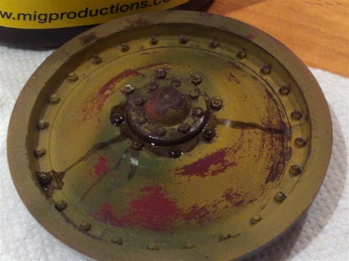

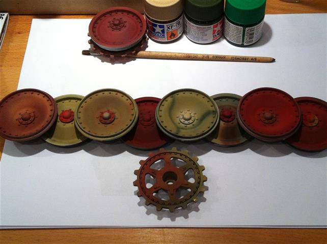

here are a few of my atemps on the JP
Superthinned flat red, and a tiny drop of white. Later I misted thinned buff over it. Also neutral Wash from MIG is good on red to tone it Down.
IMG_0479 (Medium).JPG (75.61 KiB) Viewed 4769 times
IMG_0468 (Medium) (Small).JPG (48.11 KiB) Viewed 4769 times
After Wash Camo and chipping
