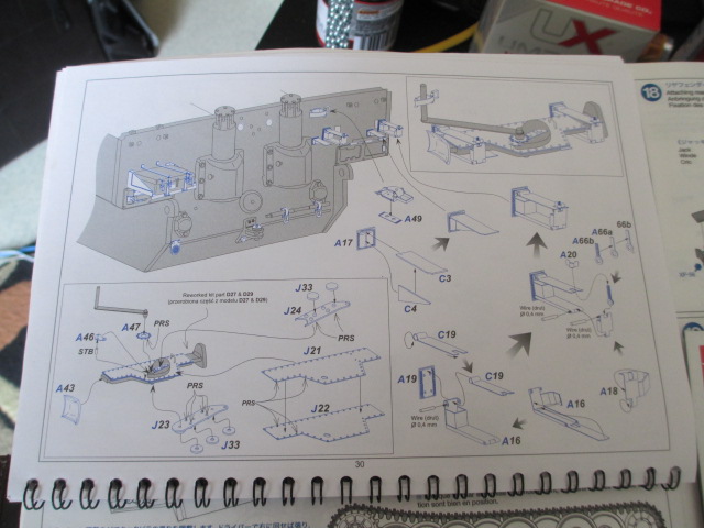

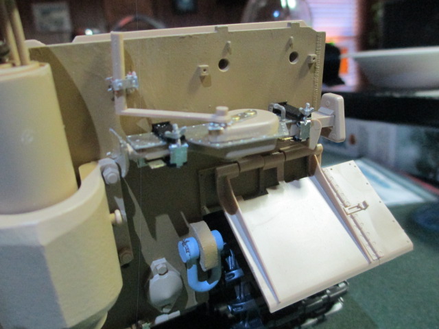

I finally got around to using my Aber jack detail parts. I used a plastic Taigen jack for the project and the most difficult step was using a sharp chisel blade to carefully remove the part that the handle attaches to. That part needs to be reused so it was a slow careful job. I’ve seen other modelers get better results but I still think it looks better than the metal Mato jack I had.

Here’s a quick comparison illustrating the difference it made.

A very nice touch of detail often overlooked :thumbup:
I avoid the worry of slicing lumps out of my jacks by pin vicing a couple of holes in the jack then bend a staple to shape and place the ends of the staple into the waiting glue filled holes,
To finish off the jack I pin vice a hole in each of the jack holding brackets and push the shaft of a Shumo Wing/Butterfly Nut in place.
I long ago made up a batch of jacks ready fitted out and painted so that when the next build comes along the jack is ready,
I don't know why Heng Long/Taigen provide the ready folded handle which looks rubbish when the addition of a proper handle adds so much to the look of the jack as your pleasingly detailed example proves.

Good Morning, Mr. Jimster,
A worthy addition to that detailed and eye candy rich build. ABER uses the Tamiya ( or Taigen or MATO or HL ) plastic jack to achieve comparable realism. Fiddly but worth the work as you have shown.
