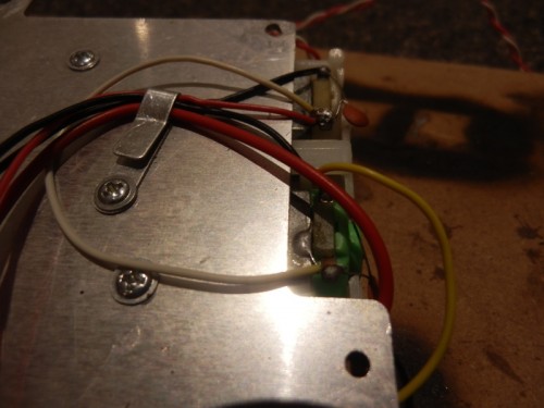

For now, here is a quick one.
The white wire on my new taigen unit was not connected, and it was soldered onto the same post on the other motor as instructed.
I cut the terminal off the red(
As soon as I hit the fire activation the recoil functioned and the system returned to forward battery.
I could have done a nude-snow-angel once that happened I was so happy.
Just now im going to secure a feed off the on/off switch in the JT so once my stuff comes from HAYA it can hopefully get it going quick smart.

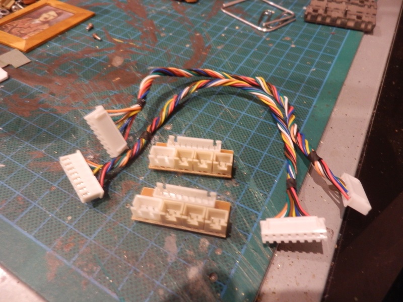

Well now its really on !
My cables and plugs arrived from HAYA UK.
Posted on the 30th UK time arrived my door today the 10th over the busiest time of the year for mail & parcels.
Cannot heap enough praise on Andrew from HAYA for getting my emails, replying, checking, replying and sending over such a busy time.
I need to make an adaptor for the plug socket as the holes in the PCB dont match the mount inside the Matorro hull, but thats easy.
Very soon I will be boom or bust, so here goes.

- Posts: 11726
Re: MATORRO JAGDTIGER CONVERSION
BUST
Changed the black-black -red over to match the picture from Mr B-Man, no good, changed back, no good.
Surely now, with an actual 8 to 8 pin cable AND socket , brand new, out of a current gen T-90 the %$#@# thing should operate.
Got the red negative onto the black side of the on/off switch...............what the hells left
This has really kicked me where it hurts.............
