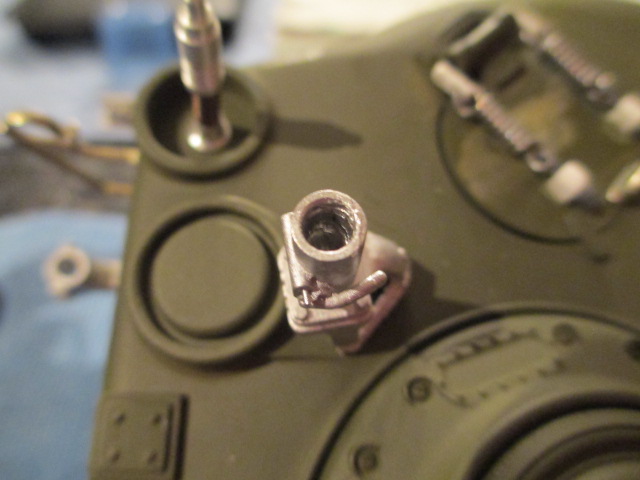

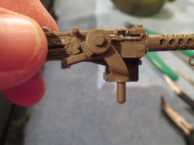

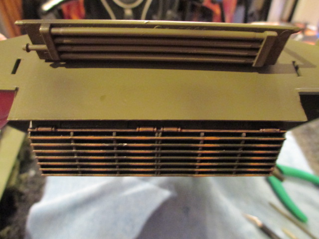

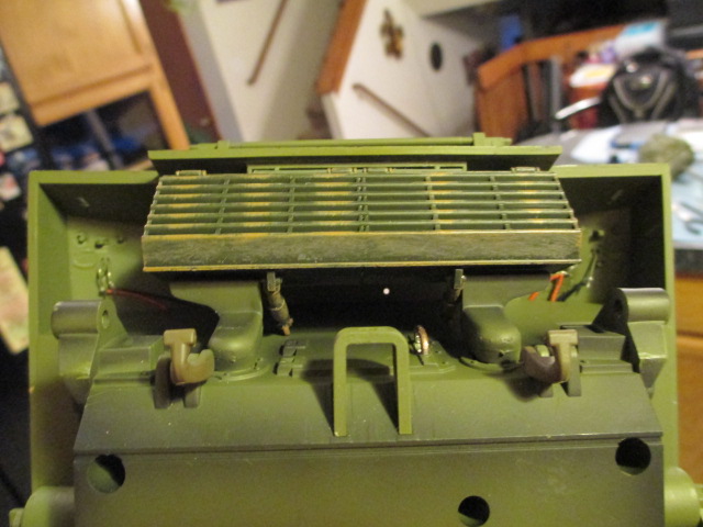

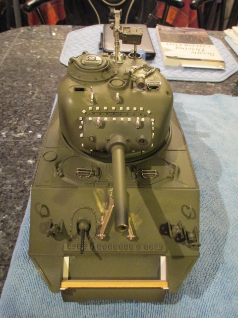

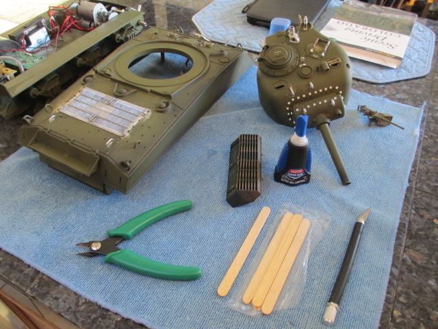

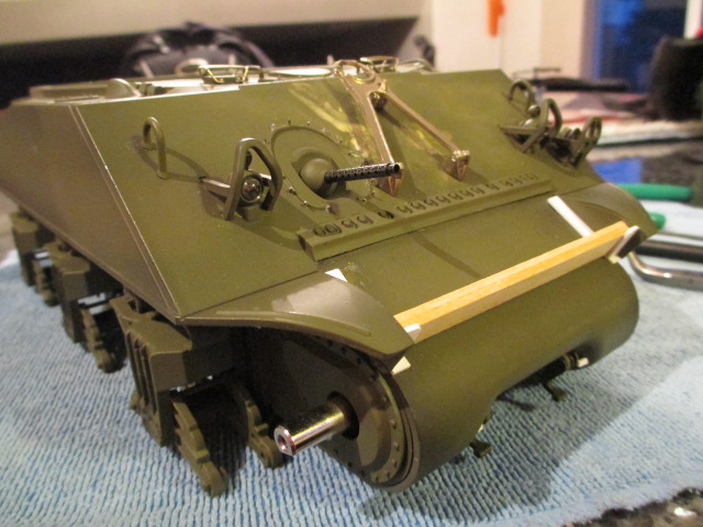

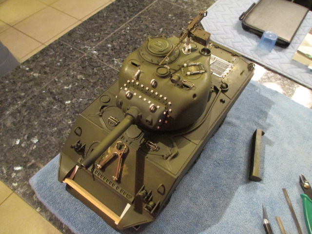

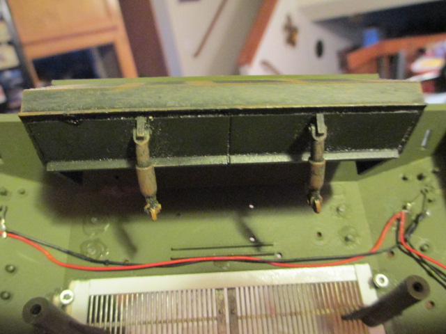

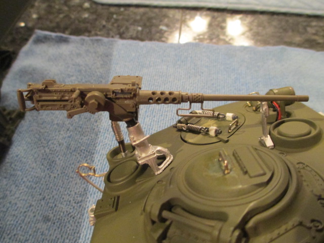

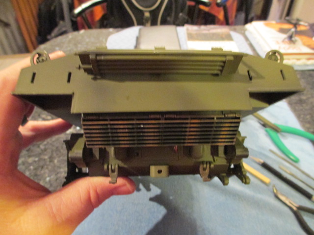

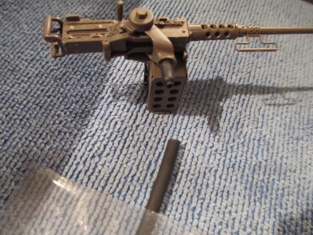

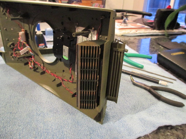

43rd Day: *chuckles* Ok, Alpha, Crazy Joe can stay as is. ;o) I will fix up his M4A1 a little tho' as nothing much was done to it outside of some sanding and touch up on tools, etc. back when I got it. I have the tools and parts now to make it look much better for ol' Joe. I think that a periscope will work on your Split Hatch turret. I went to Hobby Town this Saturday and got material to cut my own lens for the rest of the periscopes that Mike gave me. They can be shaped a little shorter to fit the Split Hatch. For the current Sherman, today started out with some popsicle sticks that I glued together and then cut and sanded to length to make a nice board for the front stowage rack. I got a little more ambitious for the next step and used some debonder to remove the stock exhaust deflector under the rear deck. I then sanded off old adhesive and checked fit on the excellent FoV one that Mike sent me and using a glued on toothpick section as a guide, got it installed. A great fit, outside of cutting off the half rounds on the HL deflector mount, no adjustment was needed. Much better looking with the rubber\plastic shocks on the back side which fit up against the hull between the exhausts. Lastly, I had an issue with the Tamiya mount peg on the .50 cal being a lot smaller than the Schumo mount aperture. A little heat shrink tubing on the .50 cal's mount fixed that. All in all, a productive day. Pictures:
- Tamiya mount is too small in diameter to give a good fit
- Tamiya mount is too small in diameter to give a good fit.JPG (83.13 KiB) Viewed 2097 times
- Schumo MG mount aperture
- Schumo MG mount aperture.JPG (84.02 KiB) Viewed 2097 times
- Test fitment of the FoV deflector
- Test fitment of the FoV deflector.JPG (97.96 KiB) Viewed 2097 times
- Stock Exhaust deflector removed and mount cleaned up
- Stock Exhaust deflector removed and mount cleaned up.JPG (78.37 KiB) Viewed 2097 times

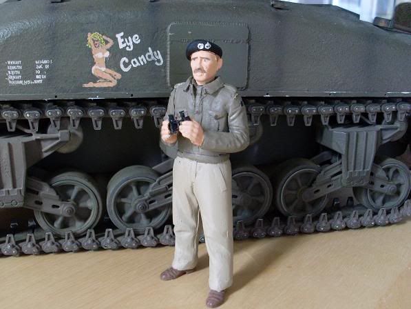

Dang fynsdad... that's some pin up... it's the first one I've got to see close up... i'm amazed at the detail... that tank .. actually all your works of art are "eye candy"...fynsdad wrote:I think the HL barrel looks about right, like you say it is a 105 after all. If you're going for a 75mm, Alpha, I use a HL panzer 3 barrel on mine, it's not 100% but it looks pretty close![]()
...Oh and here's a "Monty" I did......![]()
and what else can I say about your figures ... they're Fantastic... I still remember the German soldiers you posted ... that sketchbook guy was really something.
Thank you fynsdad ... it's always a special occasion when I get to see your work
