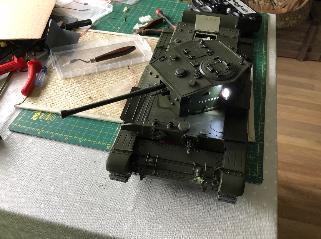

I now have a compact battery (two rows of three side by side)- 3700mAh. Now, time to run a few tests.
First the binding: (1. Switch the transmitter on, whilst holding the 'start button down. 2. Switch tank on, and wait for binding beep)
and the switch on:
Cromwell- switch on test.pic A
Lights are steady. :thumbup: The front right headlamp is obscured by paint spray but actually working, along with the turret and L/H headlamp (seen looking forwards from the tank)
