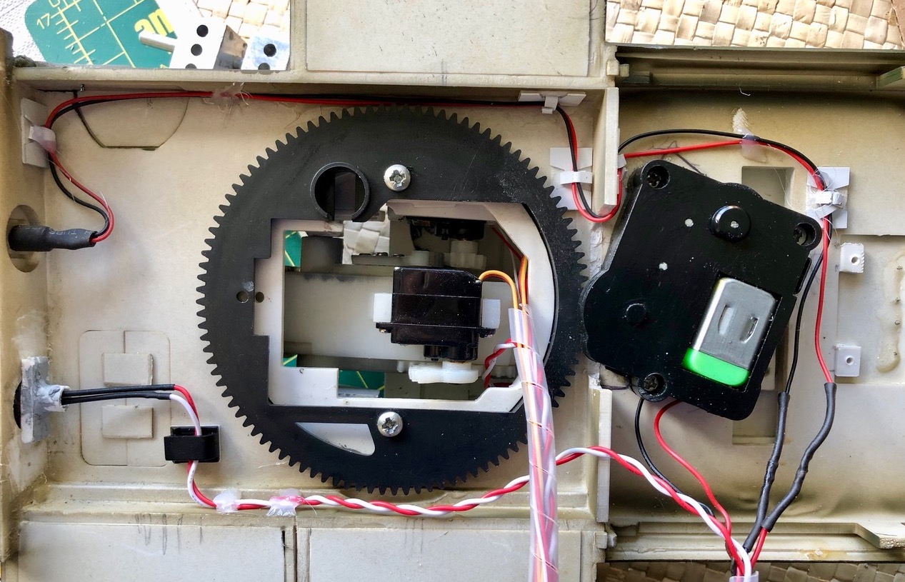

Well, the wiring appears to be complete now. Here's the revised upper hull loom:
Cromwell MK IV-upper hull wiring loom.
It's arranged so that the emitter lead (red/white) should hang away from the turret ring. I didn't want it to take the scenic trip all around the hull, only to loop back again. :D

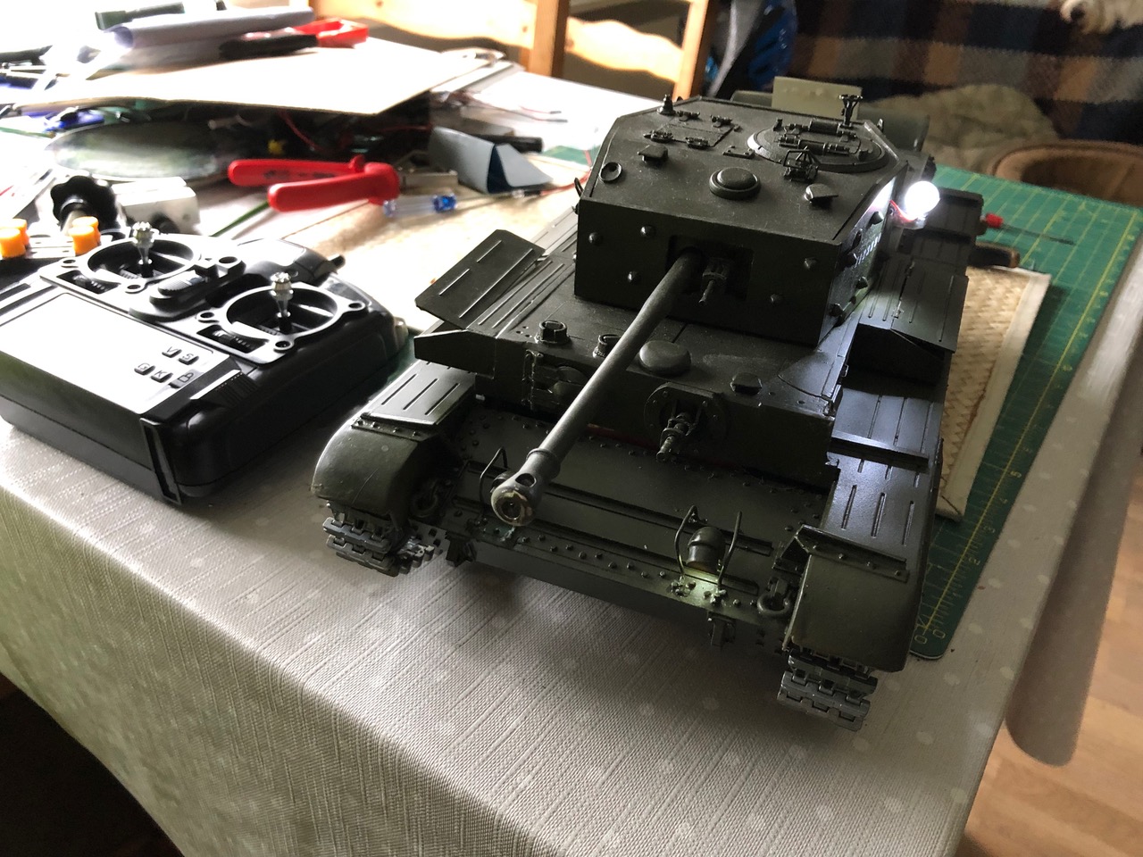

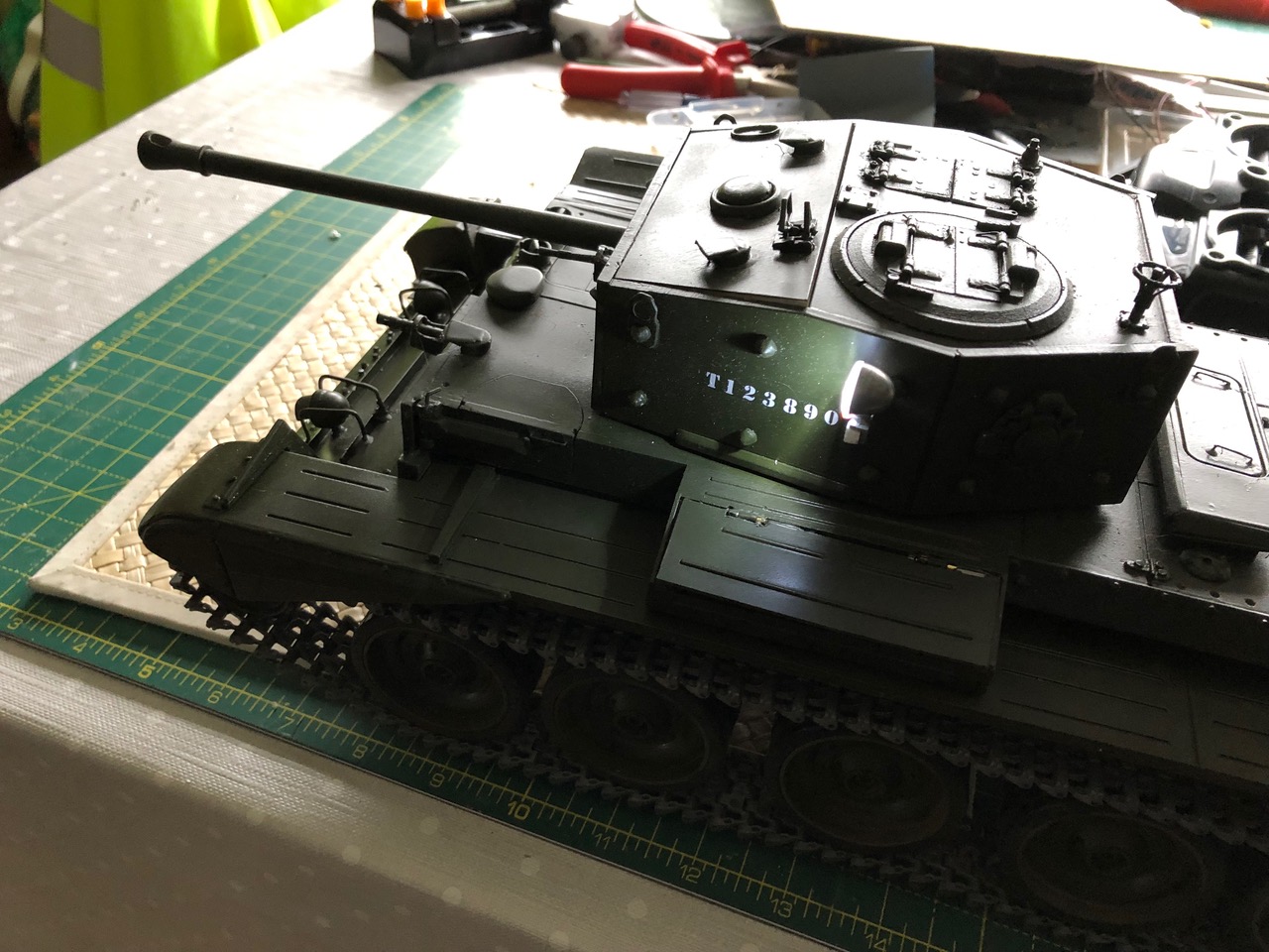

I now have a compact battery (two rows of three side by side)- 3700mAh. Now, time to run a few tests.
First the binding: (1. Switch the transmitter on, whilst holding the 'start button down. 2. Switch tank on, and wait for binding beep)
and the switch on:
Cromwell- switch on test.pic A
Lights are steady. :thumbup: The front right headlamp is obscured by paint spray but actually working, along with the turret and L/H headlamp (seen looking forwards from the tank)

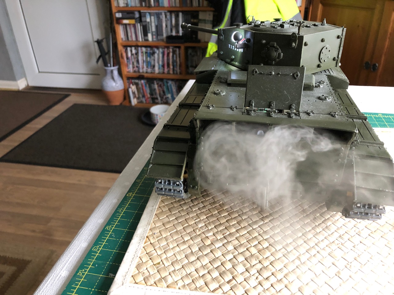

Cromwell switch on tests- the smoker...
The smoker works nicely :thumbup:

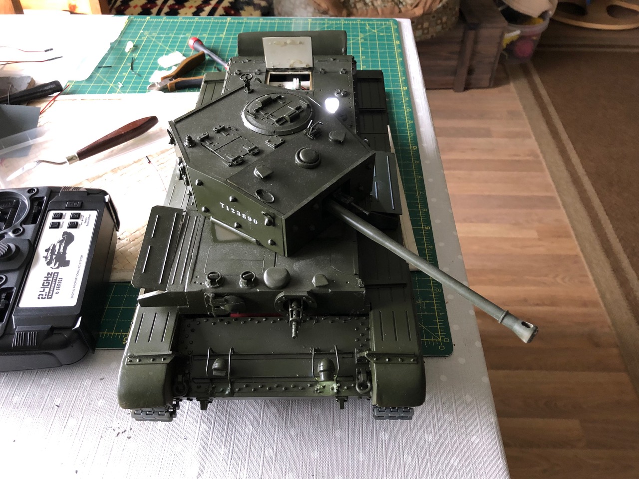

Turret rotation- right :thumbup:
Cromwell turret rotation-right
It works well, but would be smoother with a bearing race all around. :think:

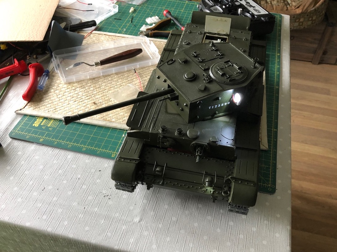

and left :thumbup:
Cromwell turret rotation-left

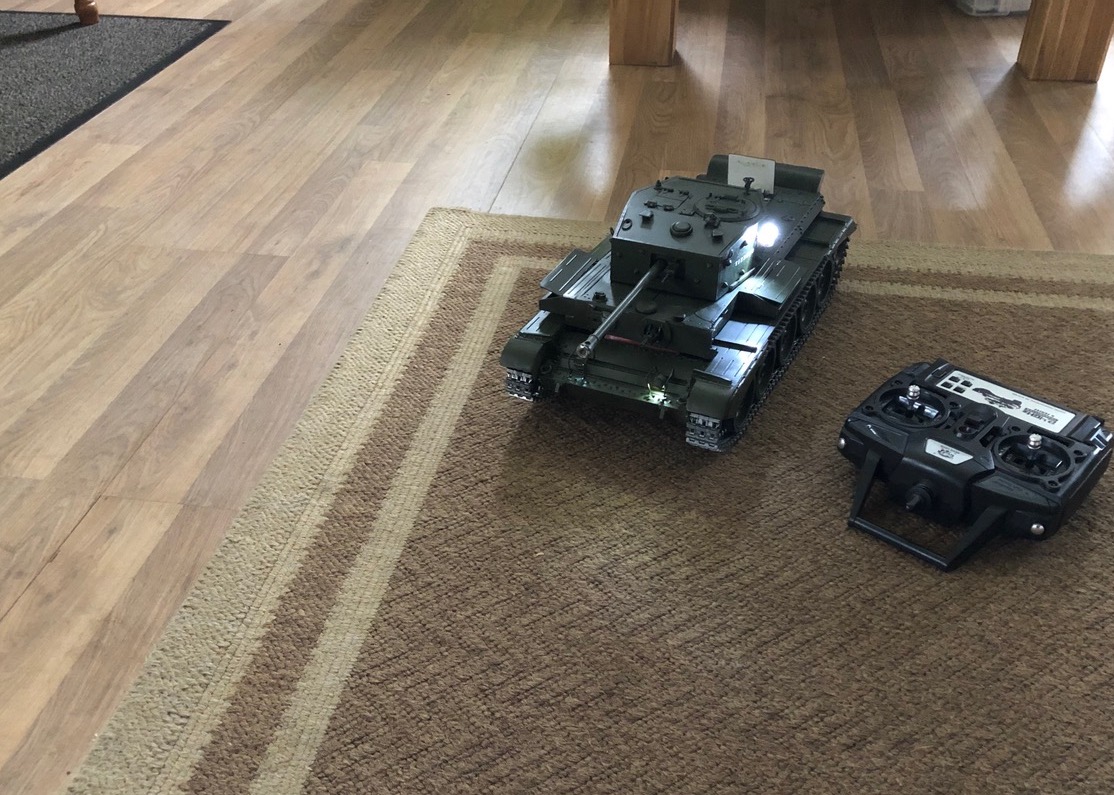

Now for the initial floor trials on laminate and carpet:
Cromwell floor trials
It moves correctly in all directions. The Panzer IV metal tracks, combined with the bespoke metal (Ludwig) sprockets are fairly noisy- but efficent. At least the problem I had with the R/H gearbox that stopped version 1 of this Cromwell literally in its tracks (Tk 60 version), seems to have gone away, after greasing the gears, and repositioning the gearbox housing slightly (and by adding extra mounting screws for rigidity).
The elevation servo is also working well :thumbup:
However:
1. No flash from the MG. This could be because it's entirely covered with SCC15 paint. The MG sound is present..That's something I'll have to check.
On the Comet, I made my own MG using 1mm fibre optic, and a Tamiya MG 34 barrel. I shall do the same here, if I can find a new barrel, or make one out of brass.
2. No recoil, nor recoil sound, and no servo movement :problem: Further investigation needed. :/
Twas ever thus. Still, on balance it actually works!! Yay.
