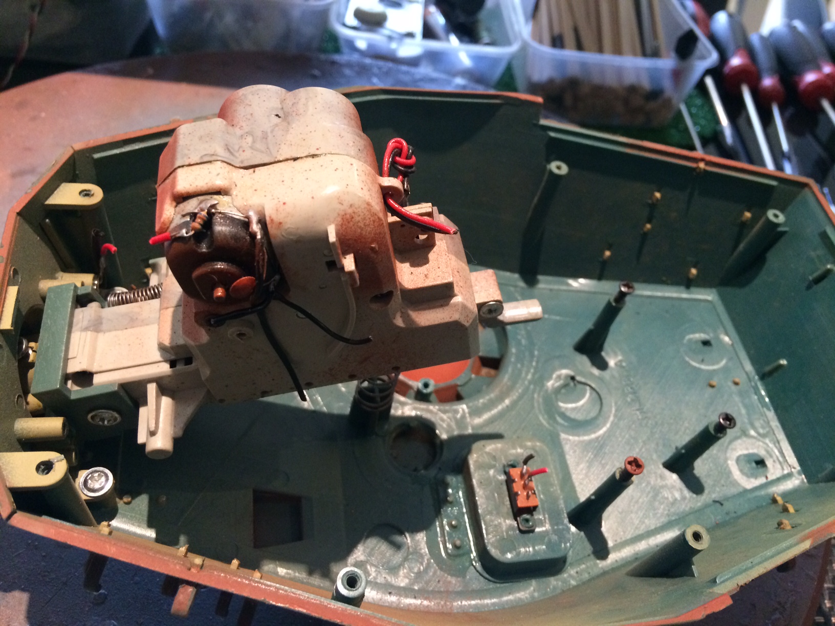

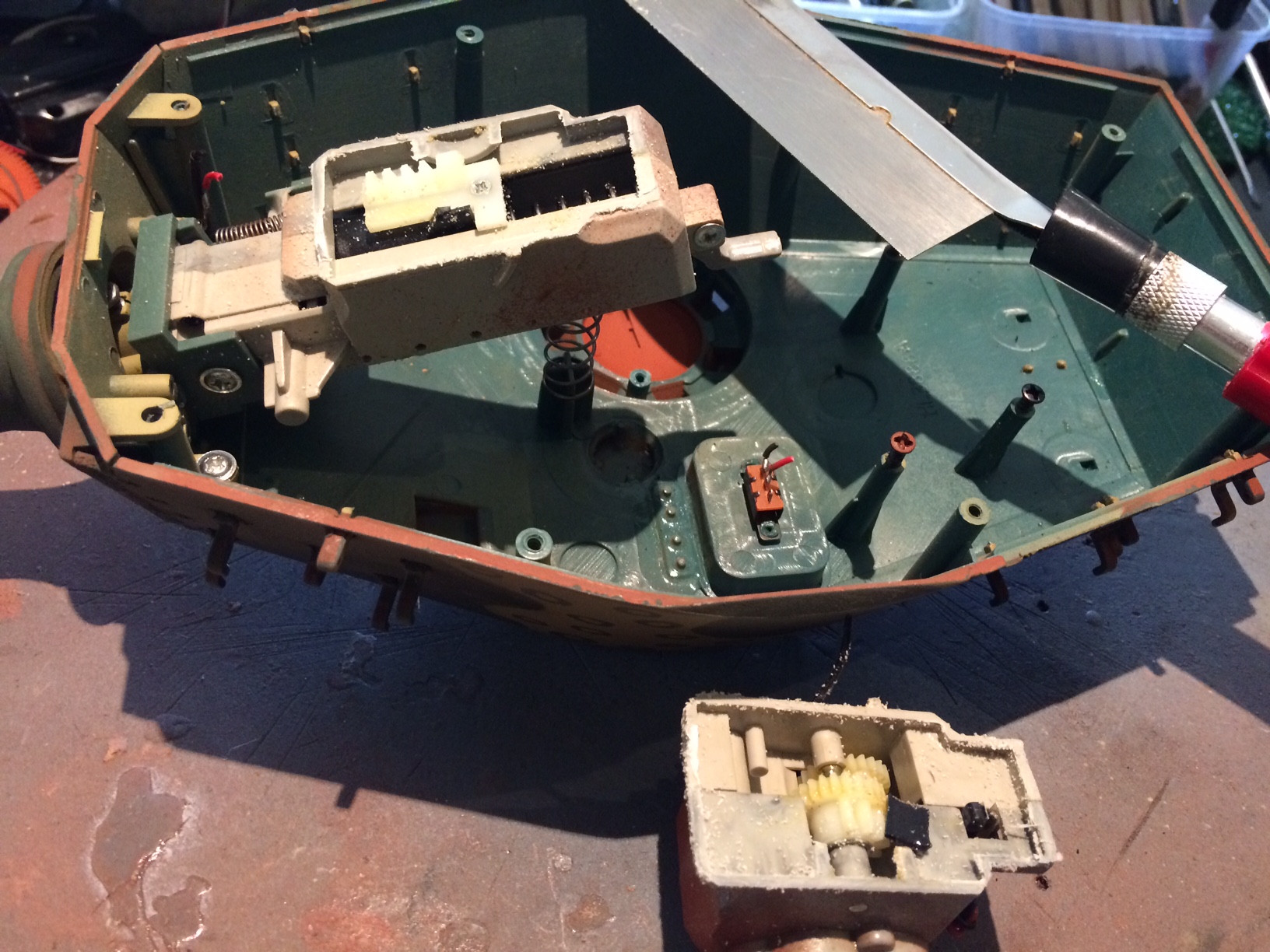

Well, I tore the thing apart. The elevation motor stripped a gear so was binned & replaced with the one I had out of the Jagdtiger.
The original BB unit was well in the way of an ideal speaker position, so , the razor saw soon took care of that as well !
I softened the spring that supports & follows the elevation on the breach so that it allows more depression, and doesnt load up the elevation motor.
I now have less elevation, but as there was way too much to begin with, its about scale-right now.
All required functions work apart from the main gun fire, but as its not a recoil unit, who cares.
At some other point in the time-space continuum it may get a fancier control unit including a recoil system, but for now using the new version H/L is a huge improvement.

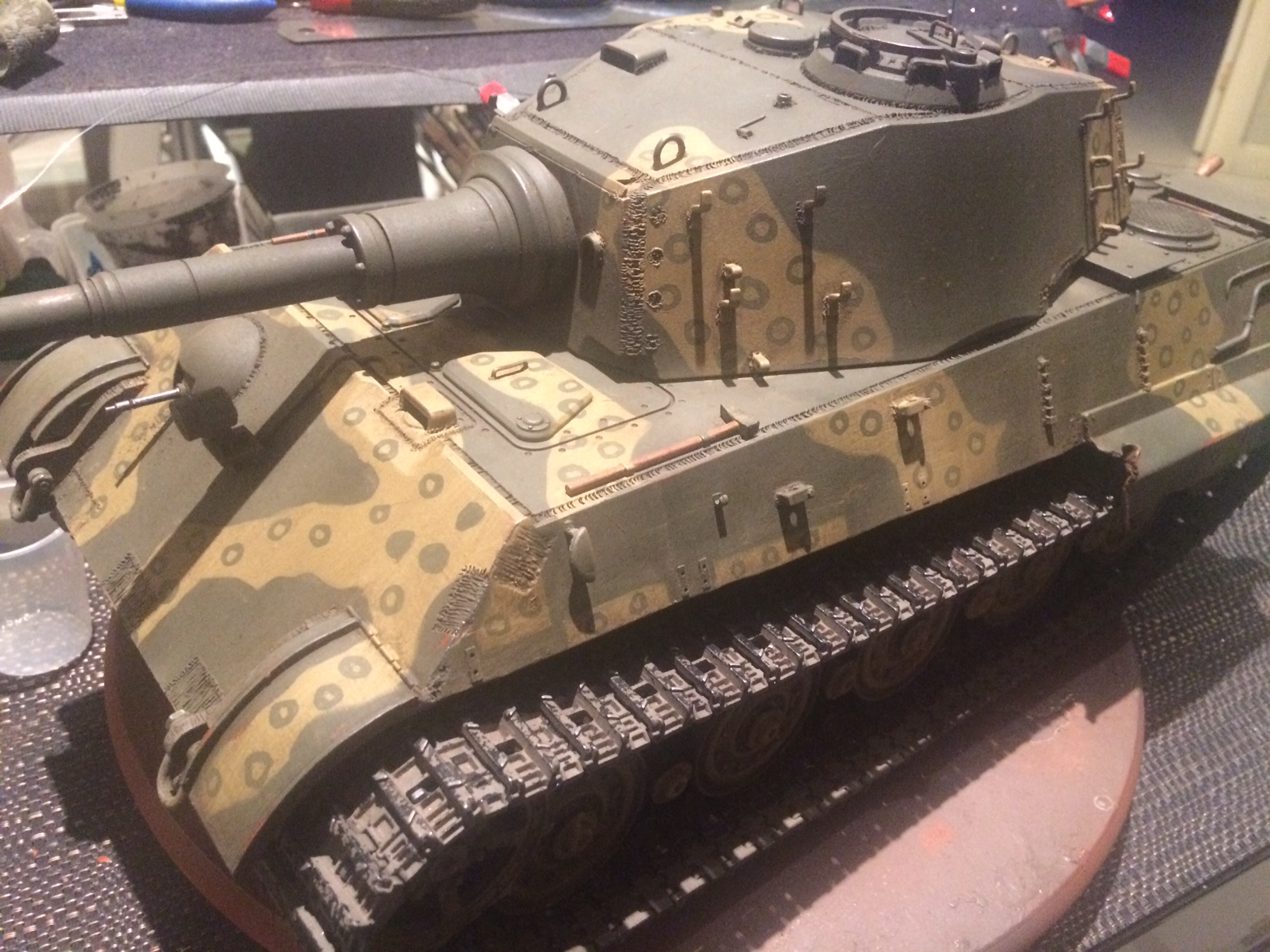

I got busy with the wash, and a pencil to create a bit more feature.
The tracks are going to be replaced soon with better ones, but these will go for now.

Re: "PRODUCTION" TURRET KING TIGER
Hi Herman a very very fine build its been interesting this tank develops through the different build stages. Excellent paint job pure genius mate.
