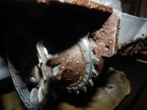

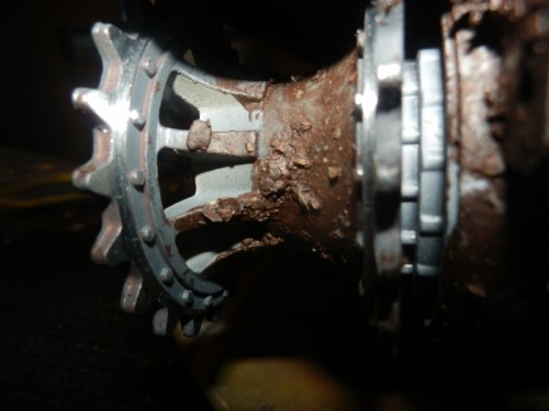

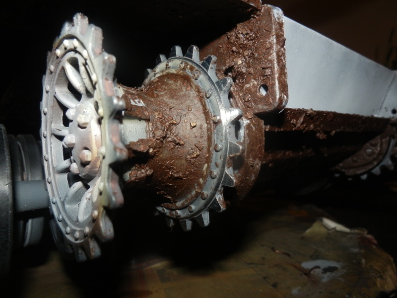

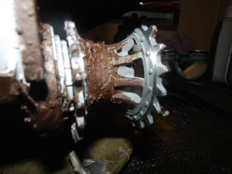

Got my 'you-beaut' tracks & set about them like a kid with a stolen playboy magazine.
Did the dry run over the running gear to gauge the length only to find the drive sprockets were not so 'you-beaut'
The new staunch tracks were to wide across the drive slots to fit the drive sprockets.
I shall write a sternly worded letter to Mr Spacely
Turned the thing on, put the transmitter on the floor, used my left foot on the 'throttle' and give-a.
Hit the inside of the sprocket faces with a file while keeping them rotating.
It took a while, but the tracks now fit snuggly over the drive teeth.
One side seems to require one more link than the other, where the metal tracks it came with were the same length.
I will fit them after weathering the wheels & test for sag & derailling.

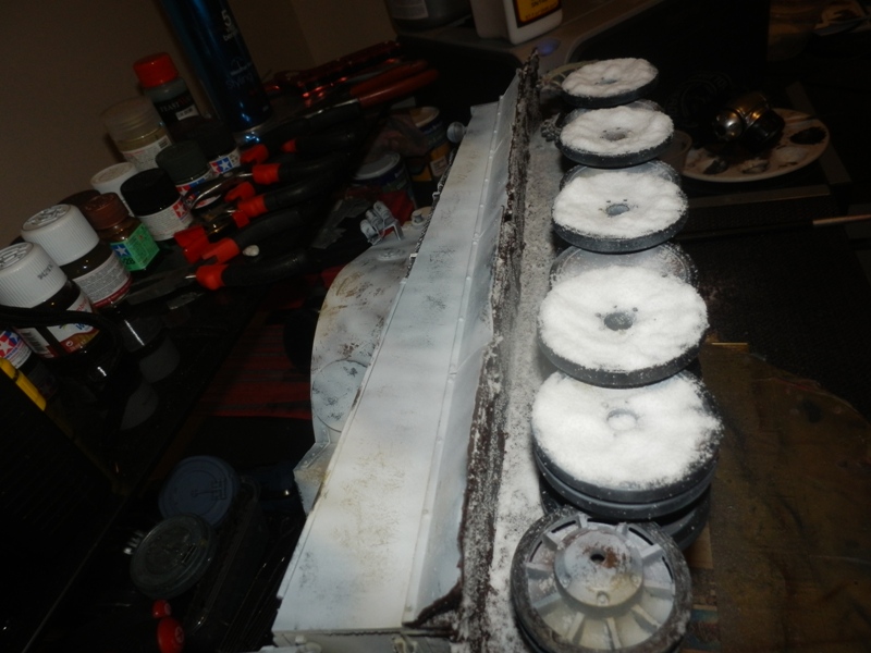

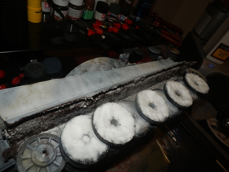

Got a canister of snow material from a well hidden RC and hobby shop the other day.
It really has a great texture & is easy to work with. Used white glue to secure this stuff on the roadwheels as an experiment.
looks like I will need to build layers to get the clumping effect, but the stuff is really good.
Woodland Scenics Soft Snow Flake SN140 from the USA.
Pics of the stuff setting on the roadwheels are a look from a Panzer Wrecks book !!
A little seems to go a long way.
I can see how this stuff is going to be a real asset to the finished product, more of a static model finisher, but still very good for the right effect on a mobile unit. And the size of the container & ease of application means I can renew it as required.
