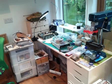

Gentlemen, the next project will be a Tamiya Panzer IV - again from Normandy. But don't ink anything in your calendars just yet...
The next project can just be seen upper left - and in the next shot.jpg (33.06 KiB) Viewed 4151 times
The workbench in all its horror....jpg (35.88 KiB) Viewed 4151 times

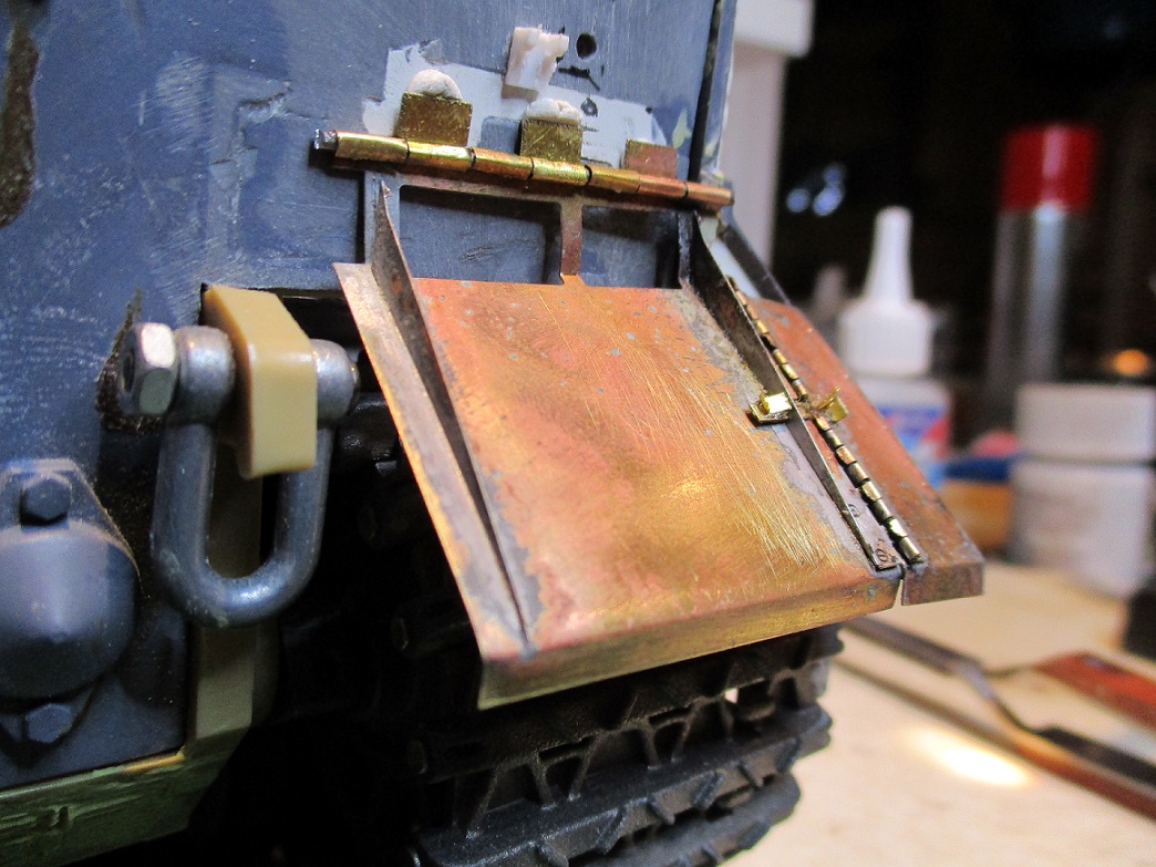

So what have I been doing for the rest of the time? Well, let's just say my fingers are a little scorched and my eyes probably a little more tired. In short, after turning my attention to the rear of the Tiger, I had entered the world of pain which is...

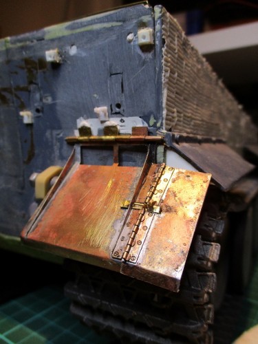

Voyager Photo-Etch Rear Fenders
You won't believe the amount of swearing (and burnt finger tips) that went into this part....jpg
You won't believe the amount of swearing (and burnt fingertips) that went into the making of this part
This had to be done because, as I have discussed above, for mid and late production Tiger 1s, the plastic rear fenders supplied by Tamiya and Heng Long, etc are all of the early pattern. The main difference is the way they were hinged and mounted on the rear of the tank. The later pattern were simplified by simply welding the hinges to the hull using three attachment points.
I thought I had reached a clever compromise by using the plastic fenders and adapting the hinges by drilling through them and attaching them with home made brass hinges using a track pin for the shaft. Unfortunately these didn't last on my work bench - let alone in the field (still a long way off I know). The plastic fenders simply snapped off...
The Hobbyboss / WSN Tiger does have the correct pattern, but these are simplified and, once again, made from plastic - so I had no faith that they would fair any better.
So it was that I reached for the excellent Voyager set, which includes the front and rear fenders lovingly recreated in brass photo-etch (luckily I am not going to use the front ones on my Tiger).
You see, there's nothing quite like metal for strength. Except you can't glue it with any strength. Which is why you have to solder it. And I'm no good at soldering. In fact, I'm RUBBISH AT SOLDERING...

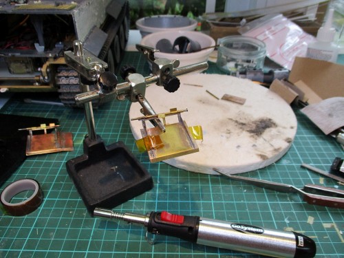

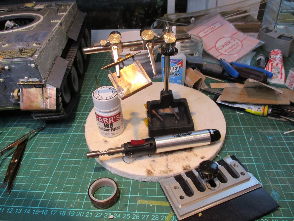

I have others on this forum to thank for my subsequent pain - but ultimate success. The vital tools are:
- A Pen Torch (like a mini blow torch, usually powered with butane gas)
- A pot of Carrs 188 Solder Paint
- A hand-free jig
- Solder tape (mine also from Carrs)
- A 'hold and fold' tool - which helps to bend the photo-etch with a nice straight edge
The tools of the trade - a Micro tech pen torch, solder tape and a hands-free jig.jpg

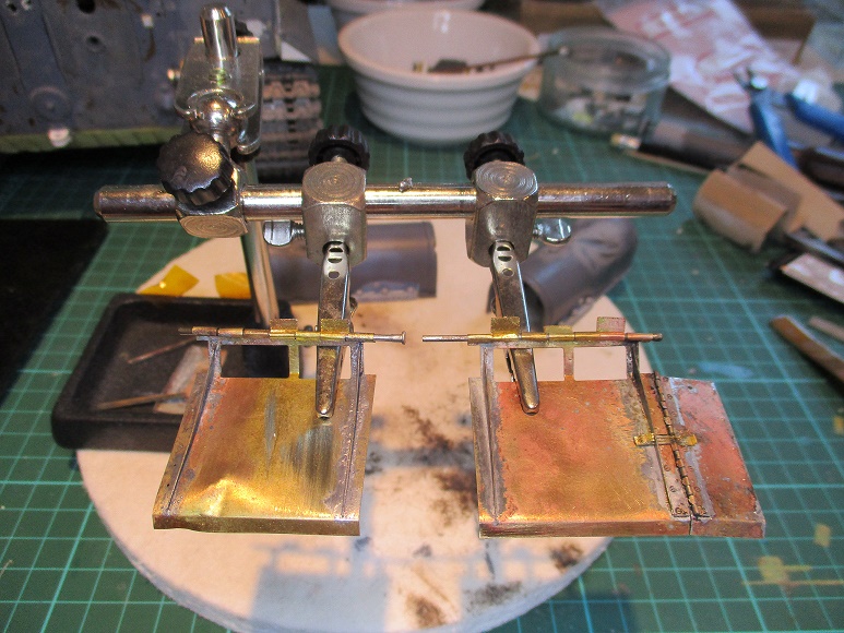

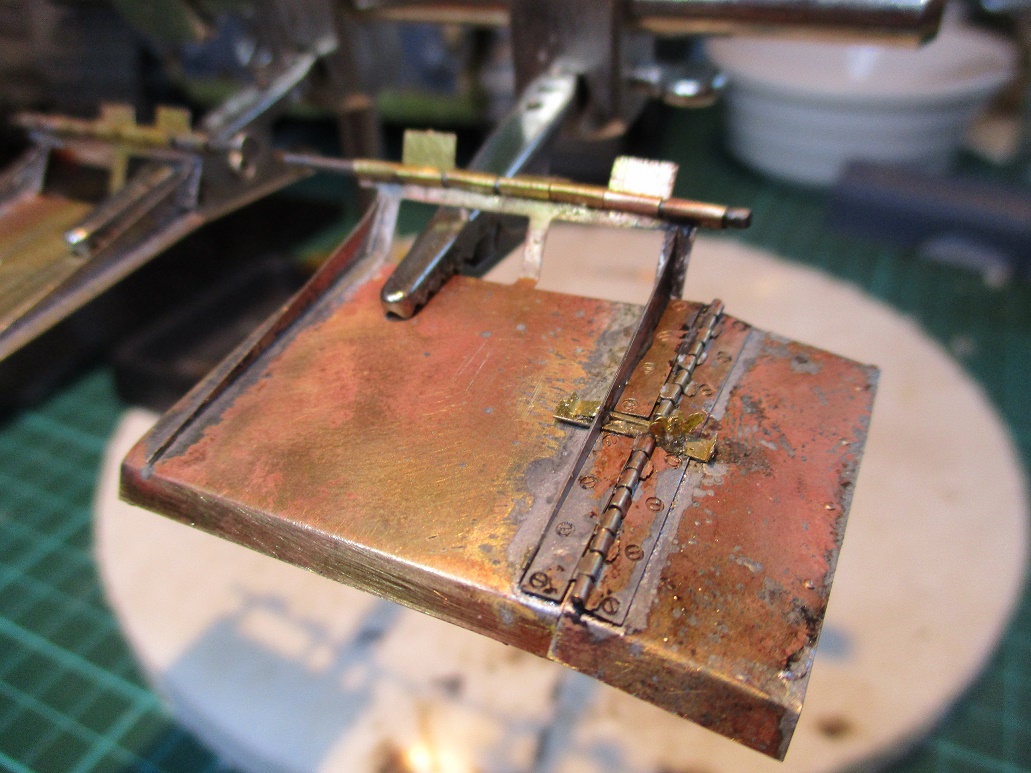

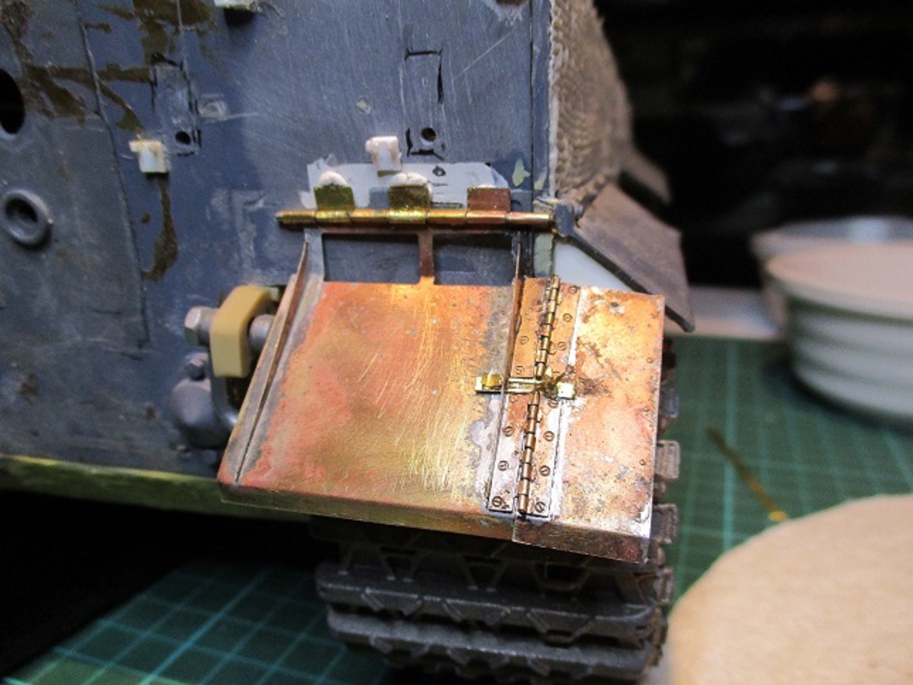

I will elaborate on some of the trials and tribulations that I had with these tools in my next post, but for now here are some pics of the fenders once I had finished...
Once assembled these Voyager photo-etch parts have an exquisite level of detail.jpg
Left and right rear fenders with a little battle damage added to the left.jpg
The right rear fender temporarily held in place with white tack certainly looks the part.jpg
Another view of the right rear fender

Shaun, that sounds like a sound plan.
The thing with photo-etch is to make it work for you. No doubt metal has more strength - but it's only as strong as the bond to itself or something else...
At the end of the day I'm going to have to glue these fenders to the rear of the Tiger - although I'm counting on some additional strength from the surrounding zimmerit.
In fact I decided to do away with the working side hinge altogether because on a running tank (not that mine will get much 'battling') I just don't trust it to hold. My philosophy is: if you cannot see it then don't worry about it.

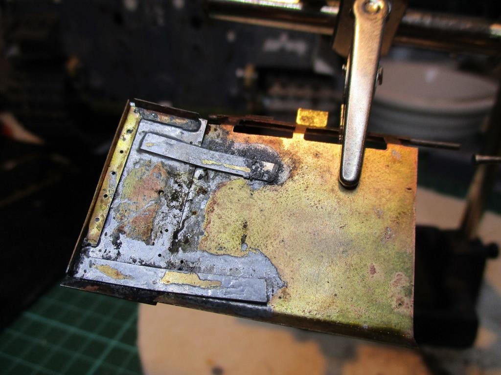

So I reinforced my fenders underneath with some extra brass strip...
Underneath it's not so pretty - but I felt I needed to add some strength to compensate for my poor soldering skills.jpg
Underneath it's not so pretty...

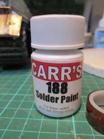

I used Carr's 188 Solder Paint.
The Magic Ingredient is Carr's 188 solder paint.jpg (33.98 KiB) Viewed 4565 times

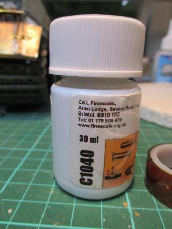

There are alternatives out there - which is just as well because it's hard to get this stuff posted abroad due to its 'dangerous' composition!.jpg
There are alternatives out there - which is just as well because it's hard to get this stuff posted abroad due to its 'dangerous' composition!.jpg (32.38 KiB) Viewed 4565 times
I learnt more than a few lessons using this stuff with the Voyager photo etch...
Firstly the parts to be joined need to be very closely aligned - it won't fill gaps like glue. If there's a kink in your brass then you need to clamp or tape the parts together and then the solder paint will melt and bond the parts together.
Secondly, don't use the plastic rod supplied with the set. This is crazy! Plastic will melt (obviously). So use brass rod, except...
Thirdly, for the fender hinges you really need to use hard metal. Otherwise even brass rod will bend. Once again I found that the Taigen or Impact track pins were a perfect solution.
tanks_for_the_memory
Posts: 501
Location: London
Re: Building a Mid-Production Normandy Tiger 1
Kaiser, that sounds like a much more relaxing way of doing things.
The instructions for Carr's solder tape talk of a similar thing where you tape all the parts together and then put them on a aluminium tray which you heat up. Trouble is I just couldn't see a way of taping everything together in one go. Just about the biggest problem I had was finding a part I had already soldered coming adrift as I tried to solder the next...
One tip for the blow torch I forgot to mention was to direct the tip of the flame onto the opposite side of where you are trying to solder - that way you don't literally blow the piece you're trying to solder out of the picture!
