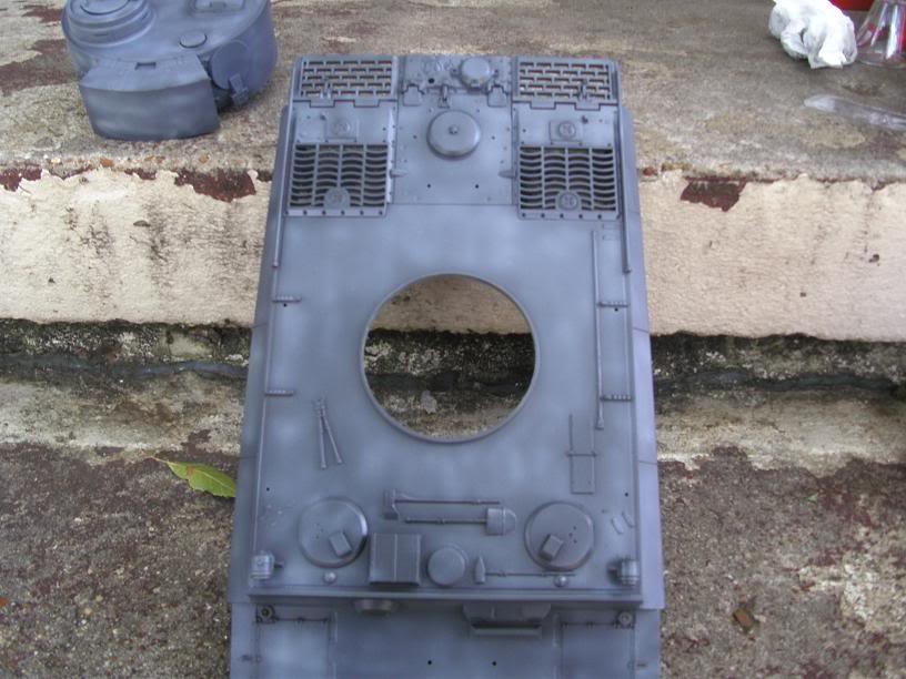

John, this was the first post and the beginning of this section. But the older forum had some problems and many of the pictures were lost. The floor polish works very well to seal paint and decals. You can weather after the floor polish and the add some more. But the varnish really makes the difference, it is amazing the finish that the varnish will change. Absolutely flat/matte finish. After the polish the tank will be very shinny, the second coat of varnish and it completely changes the appearance.
I am working on my Jagdpanther tomorrow,I.m at the point of adding the floor polish in three coats which need to dry completely between coats, you can also add pastel coloring between the floor polish coats. The after the polish has dried(24hrs) then the varnish coats can be applied,but the varnish must have at least 24 hours between coats and 48 would be better, as the varnish dries the coloring will change. Let me know if I can be helpful as this is the post that I learned to paint from. cheers Blake
PS Darby's carries the RONSEAL ULTRA TOUGH MATTCOAT VARNISH, the 250ml can has lasted through several tanks, but it is best to poor it into a glass Jar with a sealed top, other wise it will dry in the can and leave a film that will clog the airbrush.
Asiatam Tiger S13 Grossdeutschland 005.JPG (273.66 KiB) Viewed 5741 times

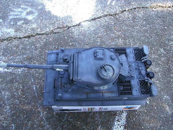

Nictank, this is the original Painting and Weathering thread. The other members OZ and Steiner have moved on and rarely post.
The camera distorts the coloring on my Tiger, and at the time of this thread I had a camera that was less functional. I will post a few pictures to demonstrate.

These are the pictures of my completed Tiger. They were missing from this thread for a long time, now you can see what OZ, Blake and I were talking about. Oz was in my opinion one of the most helpful and method sharing AFV modellers out there. Sadly he seems to no longer post or be active on this forum.
STEINER.
