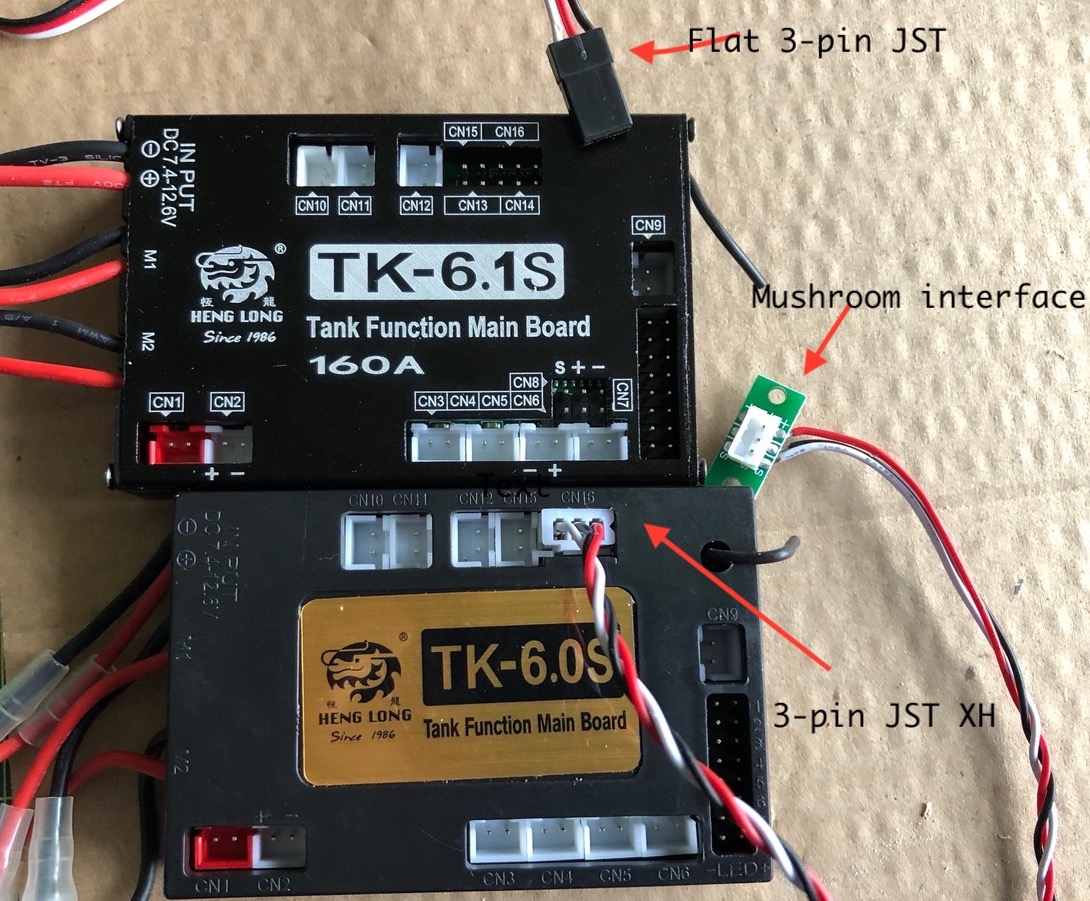

Just to be absolutely clear, when you buy the Tk6.0/6.0s, you get a bundle of cables (if you buy from the right person- eg. Forgebear). The cable that connects the MFU board to the small interface for the 'IR receiver 'mushroom', commonly to be found beneath the commander's or loader's hatch, plugs in the Ch16 socket on the 6.0 and 6.1 series boards.
The same IR receiver cable is supplied for ALL board versions. However, if you look at the diags. Below, you'll see that the 3-pin JST XH (?) female connector fits the tk.6.0 snuggly. Getting terminal and connector terminology right can be a challenge, given the range involved.
However, it won't fit the 6.1/6.1s units. For that, you will need the flat-3-pin JST female type. You will also have to alter the stock pinout on 3-pin servo unit cables, should you use one, to match the pinout in the mushroom base interface. That's it, I think. :wave:

TK series CH 16 connections compared

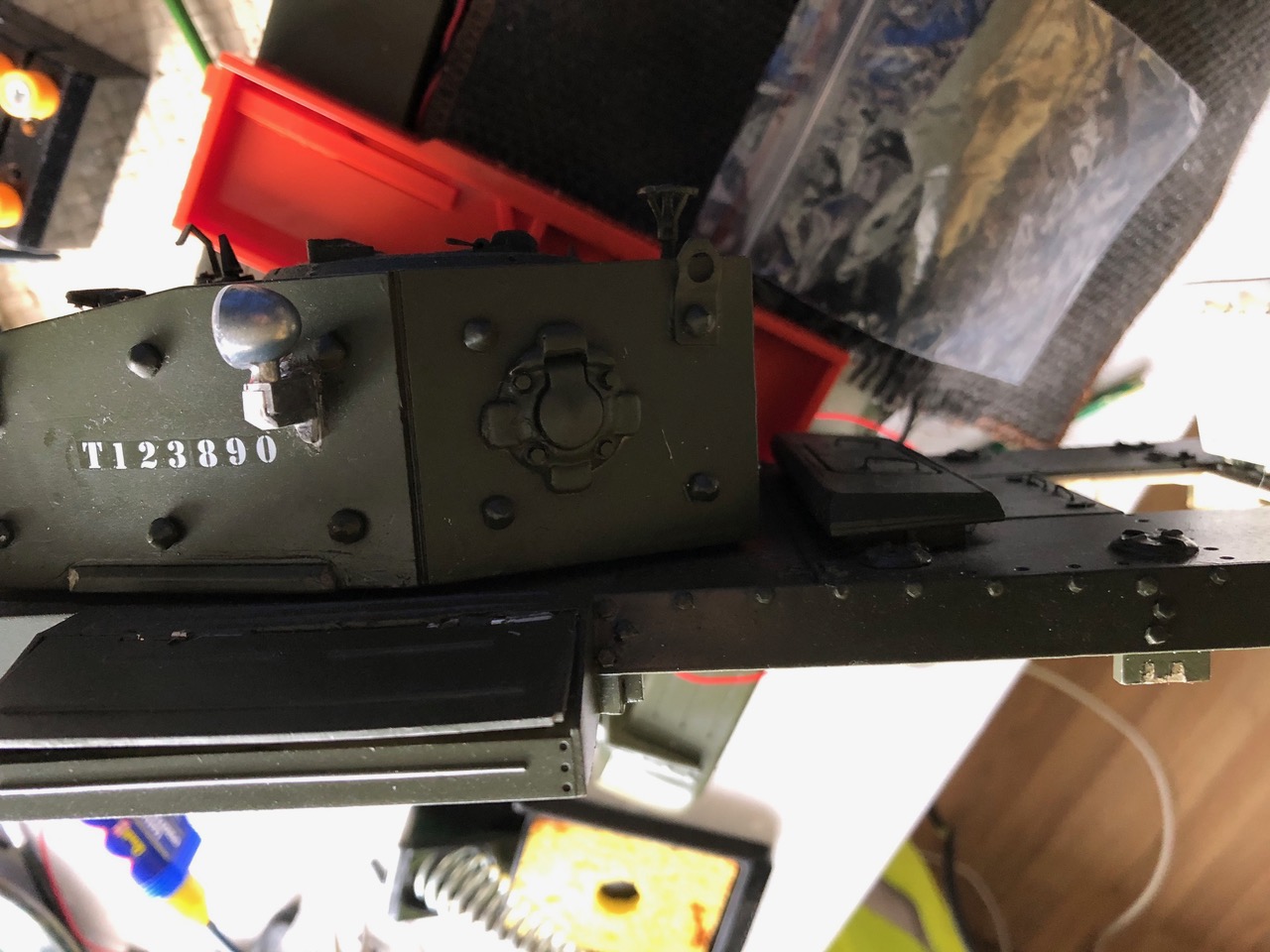

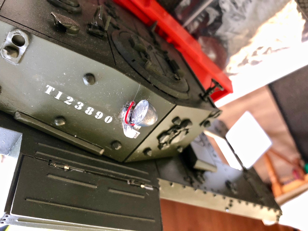

T34 spotlamp for Cromwell turret
Once the spotlamp/spotlight has been fixed in place, and a two-pin connector fitted, it will go into the LED 3 array-Tail lights (LED 4 is for the headlights LED 5 for MG flashes). After that, I can connect everything up, and test it out. I"d like to put some sort of flash in the barrel, but the bore is small. That'll be a later add-on, when all else is okay.

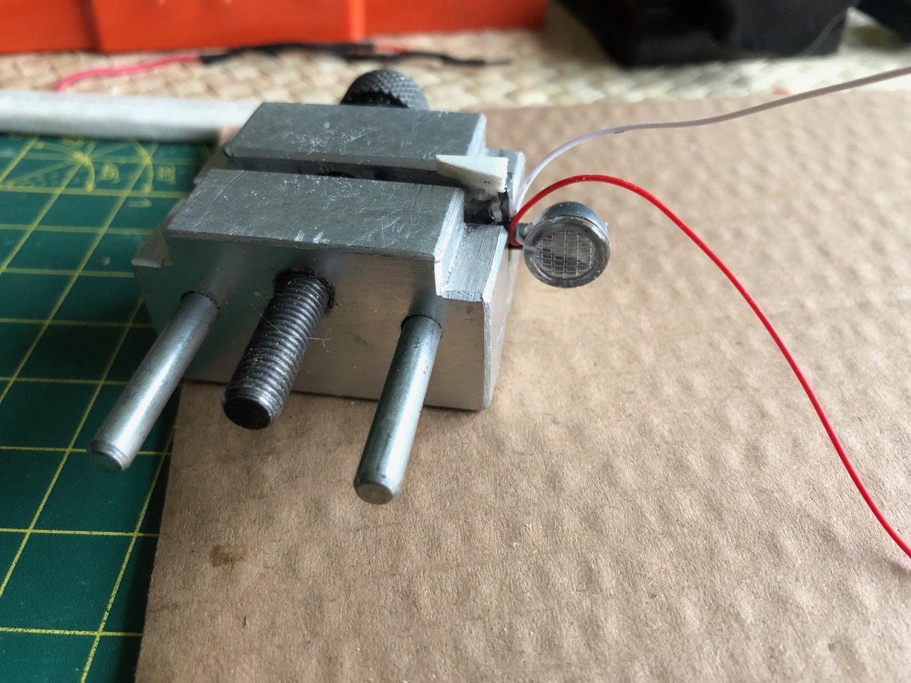

Re: Cromwell Mk 4 1:16 scratch build Ludwig kit
I've just cobbled together an attachment bracket for the Turret Spotlight. Fabricating one out of thin bits of brass would look more impressive, on a closer inspection, but this model is not going to be sitting in a museum display case. I will add a couple of 'bolt heads', perhaps; I may even add a real bolt to the bottom of the bracket to ensure it remains attached to the turret. Then, I'll paint it up and disguise the wires. All that remains to be done for the light is to fit a two-pin flat JST, and plug it into LED 3 on the board.

Cromwell spotlight-pic A
Cromwell spotlight-pic B

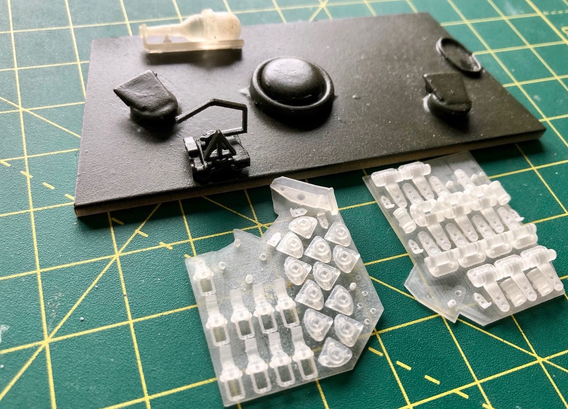

Having looked recently at Jürgen's tastefully kitted out Cromwell, I should say, perhaps, that I've had some Shapeways printed add- ons for quite a while; but haven't added them.
The reason? Well, they break all too easily. Just look at the gunsight below.
It's my estimation that while the bits are beautifully formed and printed, and to scale, they're so fragile that even a sneeze could break them. :/

Cromwell-broken gunsight and extras
