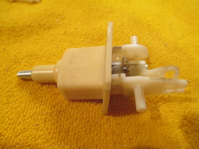

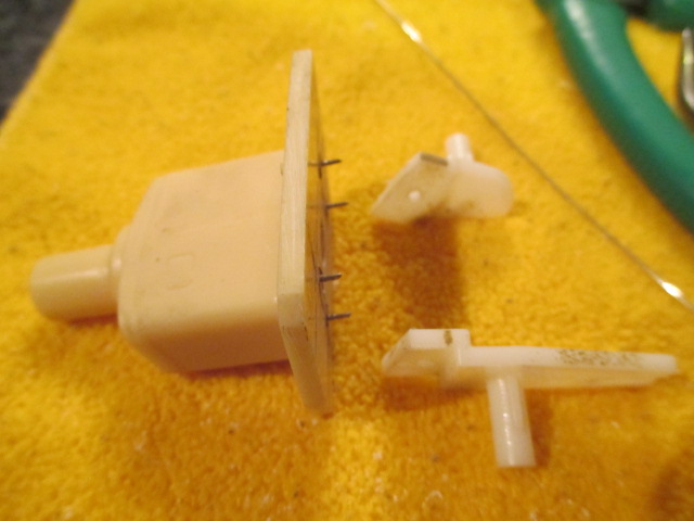

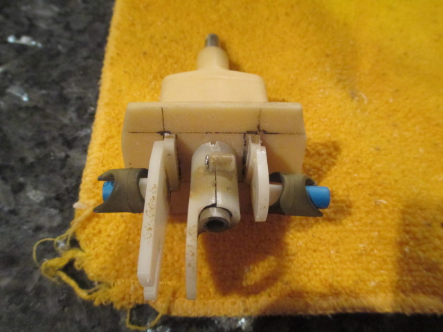

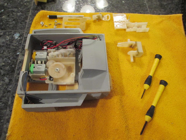

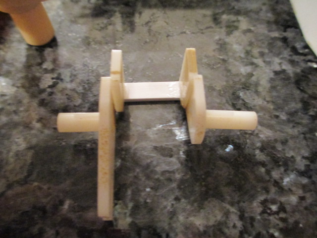

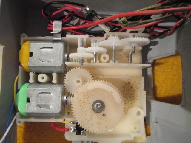

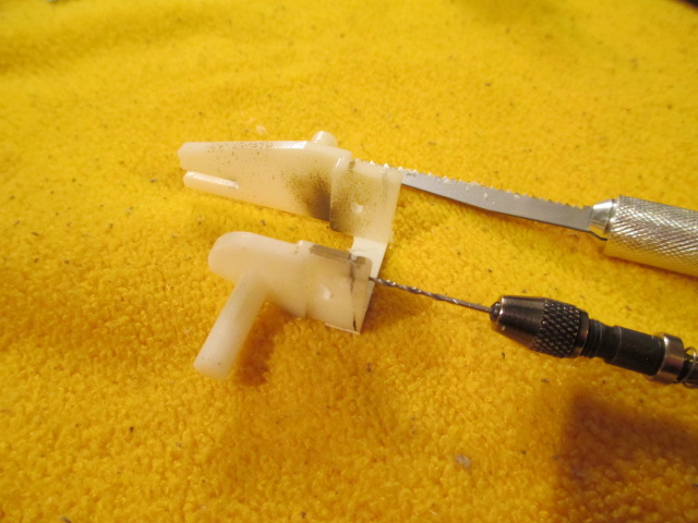

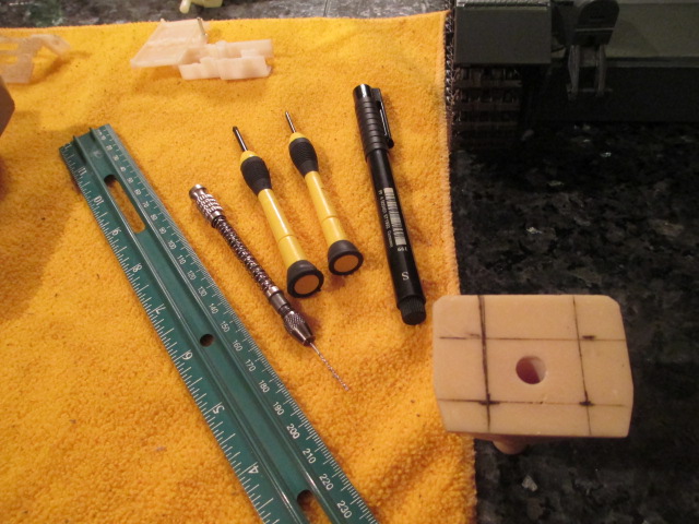

After a couple of early shifts at work I was able to return to the StuG this evening. Alpha, I think that what I am going to do for trunnion mounts is drill the right sized hole in a .75 inch thick rectangle of plastic or balsa wood then cut the rectangle lengthwise. That should give me two matching mounts with good surface area for epoxy to adhere to. Tonight, I went back to the recoil and elevation unit and took it apart ( carefully ) and did some measuring. Afterwards, with the aid of a few straight lines and the Mark One eyeball, I trimmed and filed down the trunnion arms and used steel pins cut from an old HL aerial to do a dry fit of the pieces. I believe it is going to work. ;o) More this weekend. Pictures for now:

A working main gun mount dry fitted together
A working main gun mount dry fitted together.JPG (94.74 KiB) Viewed 3053 times
Holes for the steel pins drilled before the angle is cut into the arms
Rear of the mantlet is at a rough 40 degree angle so the arms need cutting and filing to match.  Also, the barrel carrier will be sanded to match.  Note the pins.
Rear of the mantlet is at a rough 40 degree angle so the arms need cutting and filing to match. Also, the barrel carrier will be sanded to match. Note the pins..JPG (83.37 KiB) Viewed 3053 times
Lines drawn to give location of arms to mantlet
Trunnion arms disassembled and held at the correct width by a temp brace.
Closeup of the gear locations
Working with the R & E unit from Taigen

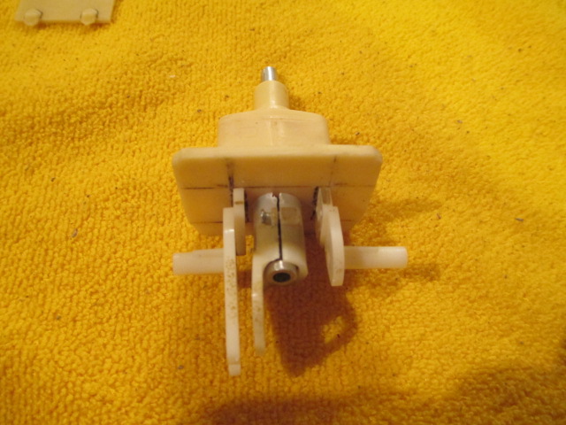

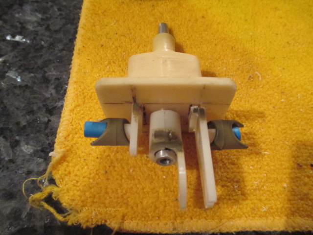

Nothing in the Post today. Saturday began with a lot of promise then took a running leap into the toilet and flushed itself. Less said the better. Anyway, A couple of pictures of the hour's worth of work I got done tonight. Pics:
Improved mantlet and trunnion mount dry fitted together.  Almost there with this piece.
Bottom view after I recut everything to bring the mantlet closer to the gunport.
Bottom view after I recut everything to bring the mantlet closer to the gunport..JPG (99.07 KiB) Viewed 3028 times
