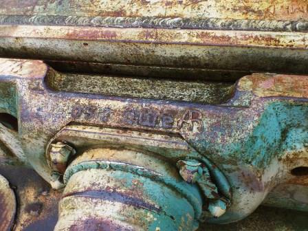

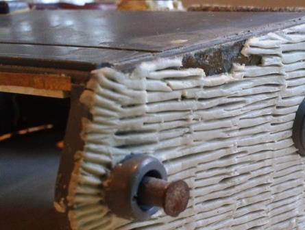

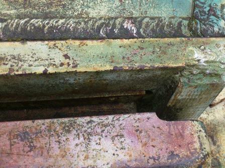

Sov, I'm really very interested (and excited) to see how those new gun pivots work out.
The old set-up obviously makes the gun pivot too far back - so the elevation / depression is limited and the mantlet sticks out too far from the front of the turret when it's at its highest / lowest point.
However, although I had considered this mod I was worried about how it would work together with the Taigen elevation and recoil unit. I'm still worried (actually everything about the Taigen unit worries me) - but I'm sure you've got it covered!
One problem that I'm still having (and you now may not) is with the reinforcing strip behind the upper gun mantlet. Mine is currently fouling the gun elevation - which is why I haven't taken any decent pictures or posted it on my build yet...
My shot of the Vimoutiers Tiger showing the reinforcing strip behind the upper gun mantlet.jpg
My shot of the Vimoutiers Tiger showing the reinforcing strip behind the upper gun mantlet.jpg (47.51 KiB) Viewed 5061 times
Close up of the reinforcing strip behind the upper gun mantlet on the Vimoutiers Tiger - also showing thickness of the front of the turret wall.jpg
Close up of the reinforcing strip behind the upper gun mantlet on the Vimoutiers Tiger - also showing thickness of the front of the turret wall.jpg (47.36 KiB) Viewed 5061 times
Cropped shot showing part of the reinforced strip on my Tiger.jpg (31.56 KiB) Viewed 5061 times
