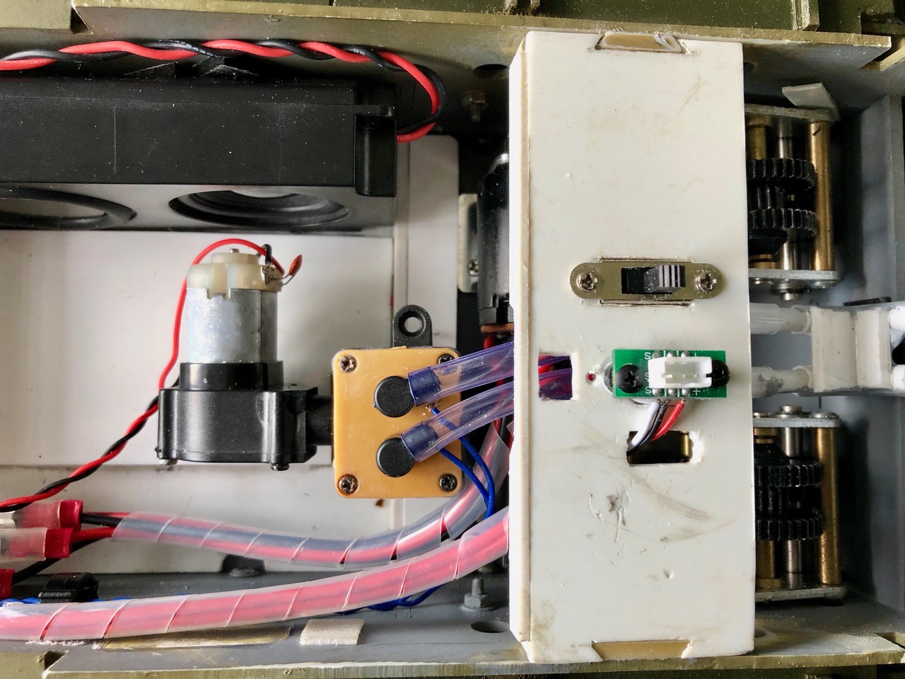

I'm just at the stage of completing the lower hull connections, and routing the wiring in the most convenient way. Wire spaghetti is not a good idea.
The detachable switch plate I made for the Cromwell, in it's earlier TK 60 format, included an in situ battery charging terminal; a vol control rheostat (not quite a knob :D ); smoker on-off switch and the power switch. Now, I only need the power switch as the latest transmitter handles the rest. I ditched the charging terminal, as it's not compatible with the TK 6.1s revised wiring.
Here's the remodelled switch plate.
Apologies for the layer of 'plastic dandruff' everywhere. I will vacuum it up sometime.
Click on smaller images to ENLARGE them!
Cromwell- detachable power switch plate.
It's a good idea to have (easily) detachable internals, from the maintenance point of view. However, given vibration from hustle and bustle, it shouldn't be possible for them to become detached 'in action', so to speak. The dovetail joints here see to that.

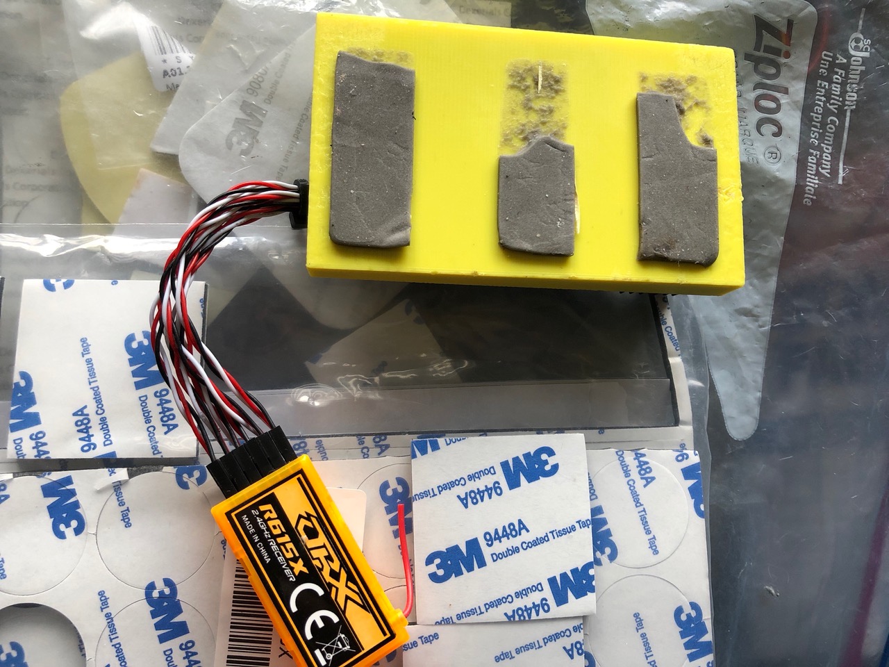

I use 3M double-sided tape to fix things in place, mostly. It's a lot easier than using screws or nuts and bolts. The only problem with it, ironically, is that it's SO adhesive that it's extremely difficult to peel it away when the need arises. The bond is almost strong enough to break the plastic the tape's attached to. 8O
3M double-sided tape of various types
I'm still trying to remove the residual tape from the base of the TK 60 unit. :/ Can anybody suggest a solvent for it that won't destroy the plastic?
Ultra-sticky 3M double-sided tape

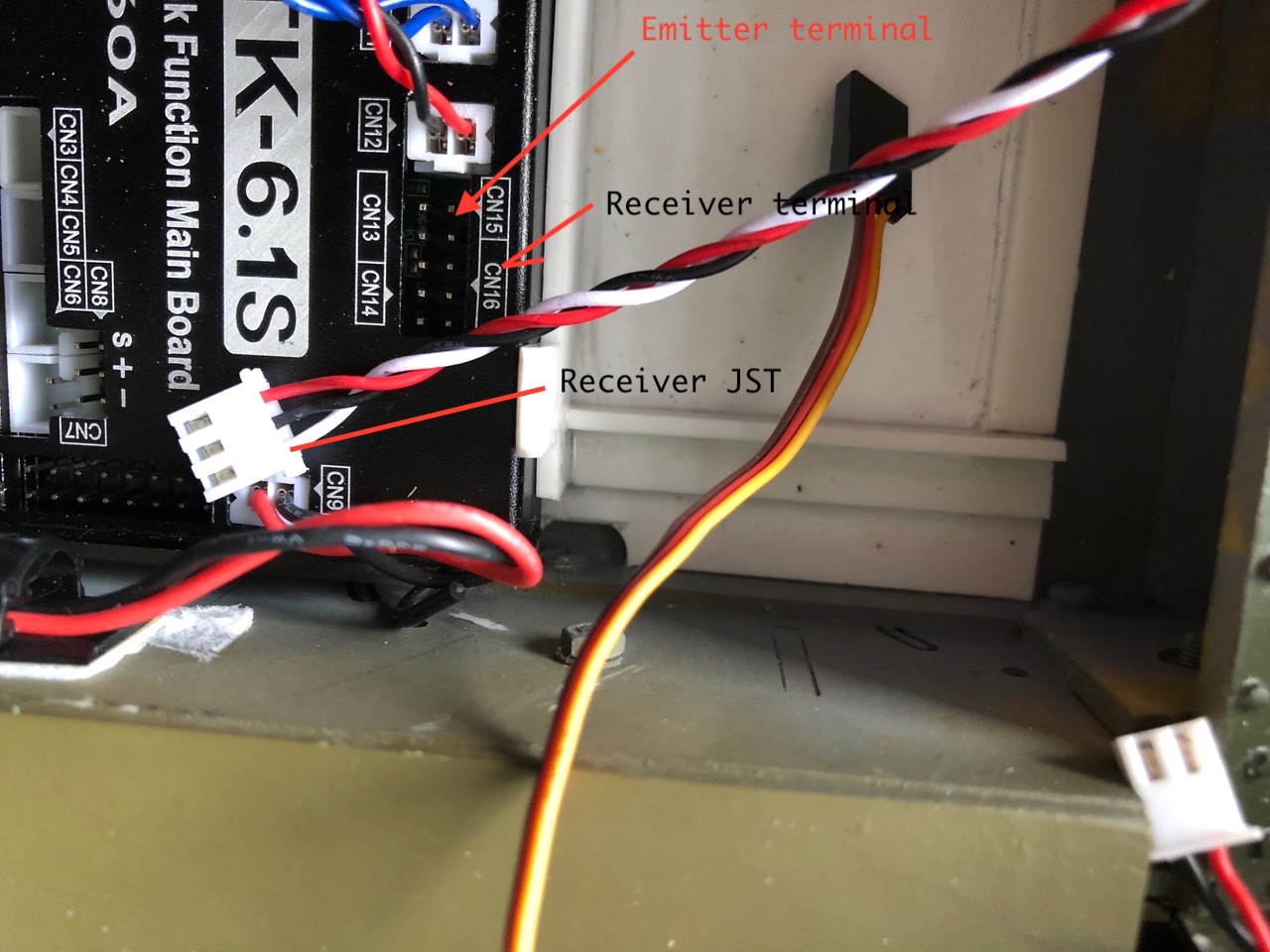

Another issue is, I decided to include the IR receiver connector cable that comes with the TK 6.1s package, even though I'm never likely to do any battling (with anything other than a cold or backache :eh: :D )
However, the 3-pin receiver supplied with the TK unit has a JST that won't fit CH16 (terminal for IR Receiver). It needs a flat servo 3-pin connector. Have a look:

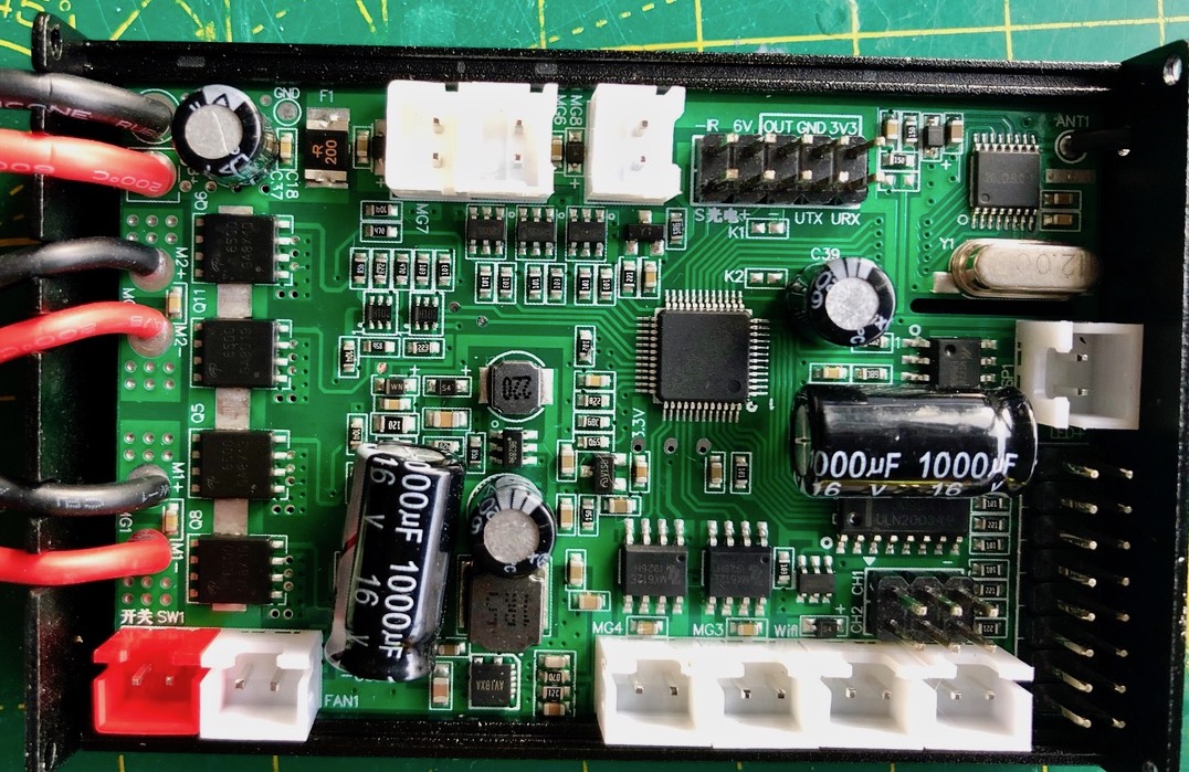

The other knotty issue, is that there's no visible indication of polarity and signal on the metal case of the MFU. Even after replacing the JST with a suitable 3-pin servo connector, it's hard to know if the pins are going to match up with those on the MFU's
It's also worth noting that polarity is not indicated for the 8 ED terminals. However, for your information, the '+' terminal is on the RIGHT when looking directly at the unit. You can see this in the pic below.
Here's the PCB revealed. Apologies that my iPhone has a problem with 'white balance' when capturing white objects.
HL TK 6.1s PCB
HL TK 6.1s PCB
Earth/ground is in the middle. I assume' 'out' will be signal, and the r/h pin the 3VDC '+' Again, the pinout on the receiver connector will have to match this. if my assumptions about terminal designations are wrong, do please say so. :thumbup:

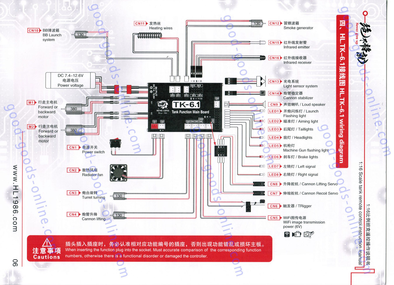

Regarding the HL TK6.0 polarity for ch.16, etc, perhaps this schematic can help, though I'm not sure the image size displays or expands properly (I'm not very well versed in uploading images here, I tend to click and hope for the best :crazy: )
Re: Cromwell Mk 4 1:16 scratch build Ludwig kit
Dr Phibes wrote:43rd, nice to see you still working on the Cromwell build I started to follow some years ago now it seems! :D :thumbup: That British olive drab colour looks just about spot on too. As for removing that sticky stuff, I usually use WD40 though I would test with the plastic first - I personally have never had a problem using this but it's as well to be careful.
Thanks, Doc!. Yes, I have that schematic, and all the others. The issue is one of terminology. IR hubs tend to have their own unique pathways, and terms. There's a useful site here:
https://learn.adafruit.com/ir-sensor/te ... -ir-sensor
Where it says 's' for signal on the diagram, there's no indication on the unit case. But 's' becomes 'Output' on the PCB itself, I discovered. I'm just highlighting a few niggles for future TK 6.1s users, with some answers for them. :D

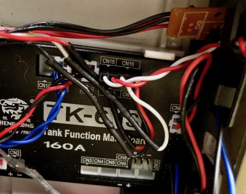

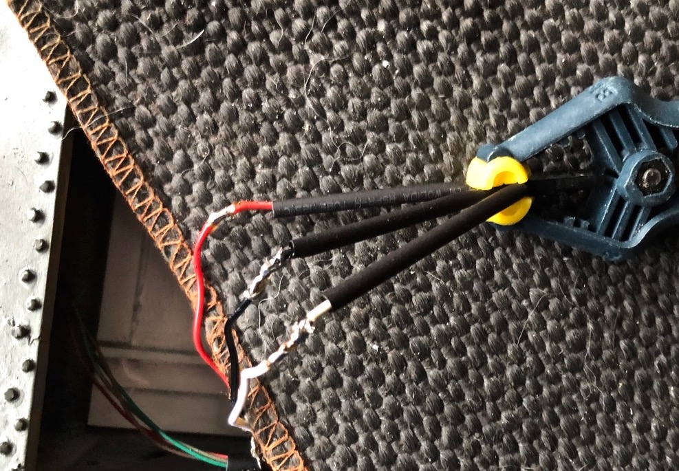

Having refreshed my memory on the layout of the TK 6.0, I can confirm that the IR module connector (for the mushroom), supplied with the set of wires for the TK6.1s, will fit the Tk.6.0 but NOT the tk6.1/tk6.1s

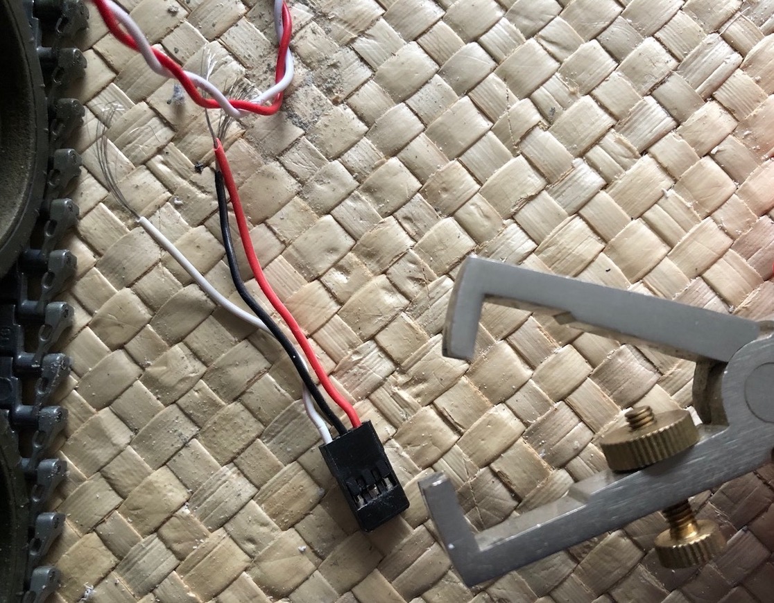

So, if you're inclined to buy the 6.1s package (and why not? It's the best HL unit, so far :thumbup: ), be prepared to dump the over-chunky 3-pin JST on the IR receiver cable, for a flat 3-pin servo type. You'll also have to shift the wires around so that the black goes in the middle, white to the left, and red to the right. :) This matches the pinout on the unit and PCB.
When fitting the flat two-pin IR emitter to ch 15 (next to the receiver 3-pin), note that the 6v + pin is on the right, so the red lead goes to the right and the white to the left, when looking directly at the unit.
Servo connector needed by IR receiver
This is the flat servo 3-pin connector, that needs to be grafted onto the receiver leads.

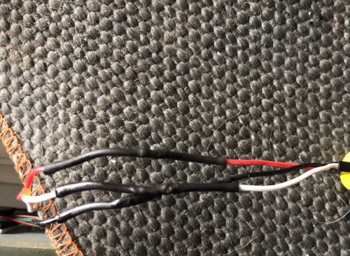

Receiver cables soldered

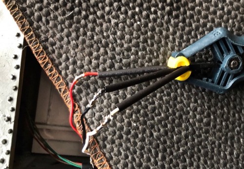

IR cable graft shielded
IR receiver connected to TK 6.1s ch16
Here you see the Emitter (ch 15) and Receiver (ch 16) wired in correctly.
