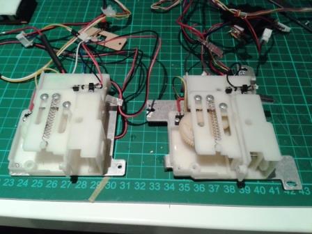

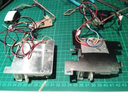

First off, I did some more work on the electrics. My recoil motor was still playing up so I ditched the old unit and replaced it with the one from a Taigen turret I acquired ages ago. I must say that the complete turret and recoil package is excellent value because you get the re-tooled turret with better detailing plus the recoil unit in one go. Too bad I didn't have this turret when I started because my old HL turret is too far into its changes for me to go back now.
Interestingly the Taigen recoil unit comes fixed to a much smaller metal base plate than the old one, but since I have already adapted the latter I had to take the plastic unit off and transplant it. In the pictures below you can see the two side my side:
The new style Taigen unit with the smaller base plate is on the left, the old one on the right.jpg
The new style Taigen unit with the smaller base plate is on the left, the old one on the right.jpg (34.84 KiB) Viewed 3569 times
The same view with the units turned upside down - or as they actually sit in the turret.jpg
The same view with the units turned upside down - or as they actually sit in the turret.jpg (41.38 KiB) Viewed 3569 times

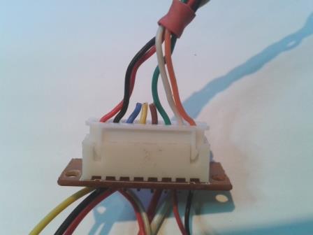

The other modification was to make a direct connection between the turret electronics and the Taigen 2.4-ghz Digital Control Unit in the lower hull. This I achieved simply by cutting the three wires away from the plug which connects to the upper hull and adding a new three pin connection which now meets with the Taigen plug which comes straight from the turret. This means I no longer have to trust the ancient wiring which caused me so many problems in the past. The upper hull board now simply feeds the turret rotation, headlight and MG...
The three wires which serve the turret from the hull board have now been cut so that I can connect the turret directly to the Taigen 2.4-ghz Digital Control Unit in the lower hull.jpg
The three wires which serve the turret from the hull board have now been cut so that I can connect the turret directly to the Taigen 2.4-ghz Digital Control Unit in the lower hull.jpg (18.86 KiB) Viewed 3569 times
Hope that's clear! (Probably not). After that rather boring post more work on the turret next...

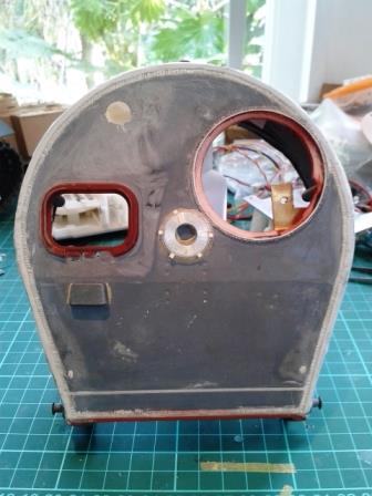

Correcting the thickness of the upper turret side armour

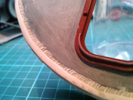

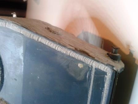

A while back I showed you how I reworked the weld beads along the top edges of the turret. I was quite pleased with the result, but there was an unfortunate side effect.
The real turret was, of course, constructed from thick steel plates bent into a horseshoe shape (no doubt David can help with the actual thickness). On the unmodified HL Tiger these plates are simply far too thin where they show along the top edges of the turret. Unfortunately my weld beads now looked far to wide and the turret sides even thinner. The newly tooled Taigen turret is better by the way and the Hobby Boss Tiger almost spot-on.
The weld beads along the turret before I attempted to restore the thickness of the turret sides.jpg
The weld beads along the turret before I attempted to restore the thickness of the turret sides.jpg (23.01 KiB) Viewed 3565 times

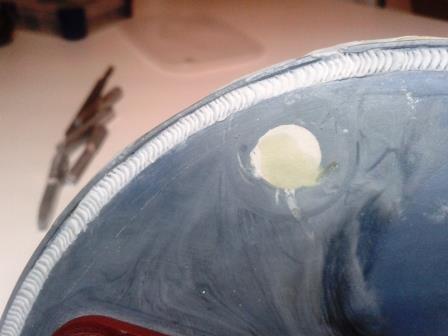

A similar 'before' shot of the weld beads around the back of the turret roof.jpg
A similar 'before' shot of the weld beads around the back of the turret roof.jpg (23.76 KiB) Viewed 3565 times

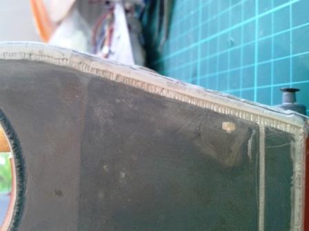

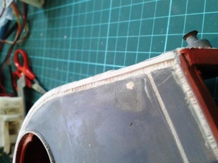

So what to do? This was a bit of an adventure for me because I risked ruining my turret completely if I botched the job. For that reason I didn't take any work in progress shots. Essentially I rolled out thin sausages of Magic Sculp (as I had done for the weld beads) and then pressed these around the upper edges of the turret. I then used my trusty tools to shape the edges so that they gave the appearance of scale thickness at the top of the side plates. It wasn't easy because the thin strips of putty were prone to falling off, but after I left them to cure for an hour or so I was able to press them down hard so that they stuck in place. I then worked on them a little more to get the edges as clean as possible. After leaving to dry overnight I was then able to sand the top edges so that they looked as flat and flush as I was able to get them.
Here you can see how the illusion of thick armour along the side of the turret has now been restored.jpg
Here you can see how the illusion of thick armour along the side of the turret has now been restored.jpg (27.44 KiB) Viewed 3565 times
A close-up of the same area after working with Magic Sculp.jpg (23.64 KiB) Viewed 3565 times
The corrected side armour on the other side of the turret.jpg (28.74 KiB) Viewed 3565 times
The curved armour at the back of the turret is harder to work on but although far from perfect I'm pretty happy with the result!.jpg
The curved armour at the back of the turret is harder to work on but although far from perfect I'm pretty happy with the result!.jpg (27.06 KiB) Viewed 3565 times
Now I'll be the first to accept that it's not perfect - but I hope you will agree that it's a darn sight better than leaving it as it was before!

DavidByrden
Posts: 300
Joined: Wed Sep 08, 2010 6:13 pm
Re: Building a Mid-Production Normandy Tiger 1
Post by DavidByrden »
The turret walls were 80mm thick. At the top edge, they were chamfered, leaving about 40mm flatness.
David
