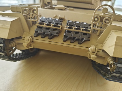

zooma wrote: Wed Jan 01, 2025 4:09 pm The hull mounting for the HAYA Centurion is a moulded tongue, so I would not be able to bend it downwards, but I am hoping to be able to file some material off of its length to allow the glacis plate to sit down onto the hull better.
I did a 3d printed option that is of a slightly tigher fit with the intent to enforce the side as well. See https://cults3d.com/:2317126
Your paint work is really good. I simply love all the weathering effects and details.

ongbenghui
Posts: 99
Joined: Sun Jun 18, 2023 6:43 pm
Re: Amateur Build. HAYA Centurion KIT
Post by ongbenghui »
zooma wrote: Thu Jan 02, 2025 7:18 pm
Does your 3D printed modified body mounting "tongue" pull the deck down tighter into the hull to remove the gap between the bottom of the glacis plate and the front of the hull?
If it does, I will ask someone to print a copy for me to try.
It closed up a fair bit for me but there is still a line. This is the effect.
IMG20250104115213 (1).jpg (46.18 KiB) Viewed 1468 times
That is a big improvement ongbenhui

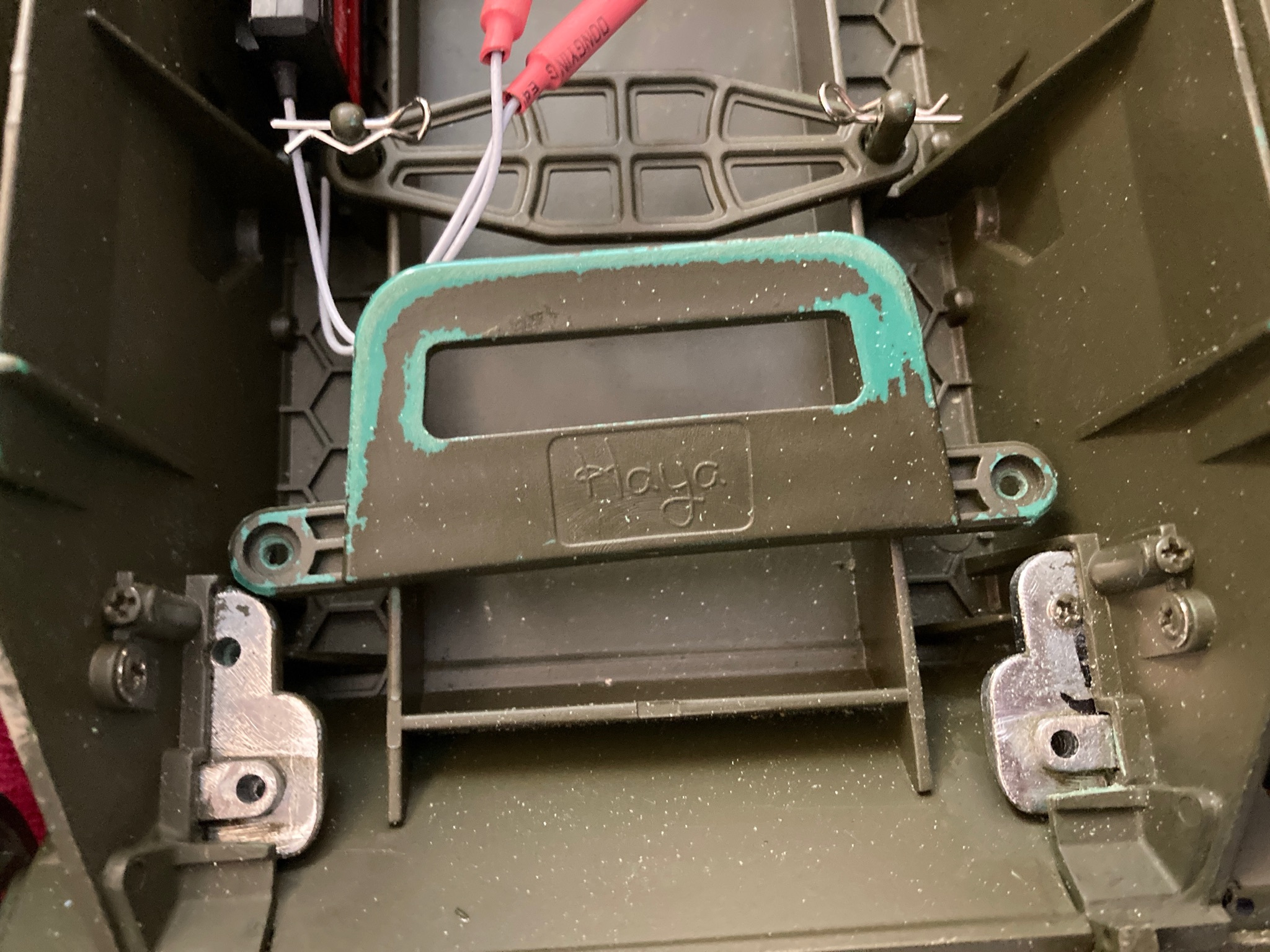

zooma
Posts: 775
Joined: Thu Feb 08, 2024 4:20 pm
Location: Rossendale, Lancs.
HAYA Centurion KIT. Glacis Plate to Hull Gap.
Post by zooma »
tankme wrote: Sat Jan 04, 2025 9:24 pm Being that the 3D printed mount is 3D printed, what would be the harm in shaving a little plastic off the bottom of it? That would make it mount lower and therefore close the gap. If you screw up and take too much off...you can always print another or put a few washers under it to raise it back up. Just a thought.
I noticed that when I push the glacis plate down it wants to spring back up again - suggesting that it is being pushed upwards by the lower mounting plate so I started to make some small adjustments to try to lower the angle of the lower mounting plate.
Shaving some plastic off of the underside of the kit "lower mounting plate" to make the angle a little shallower worked to some degree, and the gap is now slightly smaller.
The above did not completely solve the problem so I took a look at the top pair of mounting points and shaved a little off of their individual mounting bases to make them pull a little harder against the lower mounting plate. This also helped a little - but not much.
Maybe the length of the lower mounting plate "tongue" is pushing against the underside of the glacis plate? I will try to shorten it a little and see if they helps too. ****** I didn't try this in the end.......see more recent notes......*****
Although I have a 3D printed lower mounting plate on its way to me, I want to see if I can resolve the problem by using the original parts.
As a matter of interest, when I unscrewed the lower mounting plate I noticed that it was under some pressure to pull the sides of the hull together and when the two front mounting screws were removed the holes in the mounting plate were too close together to align with those in the metal return wheel holding castings.
I removed the tracks so I could in turn remove the two cast alloy return wheel mounts and "dressed" them a little so that they would sit further inside the hull until the mounting holes aligned better with those in the lower mounting plate. This allowed the two lower mounting plate screws to stand upright and no longer angled outwards at their tops!
Removing the sideways pressure of the mounting screws on the lower mounting plate may be helpful when the 3D printed version arrives as I am not so sure that it will be anything like as strong as the original HAYA KIT moulded part - and I dont want to break it before I have had a chance to see how well it works on my Centurion.
Meanwhile, I am trying to work out how much I can remove from the length of the lower mounting plate without stopping it working. I think I will start with removing 5mm and see what happens! ***** I decided against this idea, even though the idea (not the amount) was suggested to me by Andrew at HAYA as a possible fix......see later notes.....*****
Cast inserts eased to come a little further into the hull sides.
This inserts into the sockets mounted under the deck.
