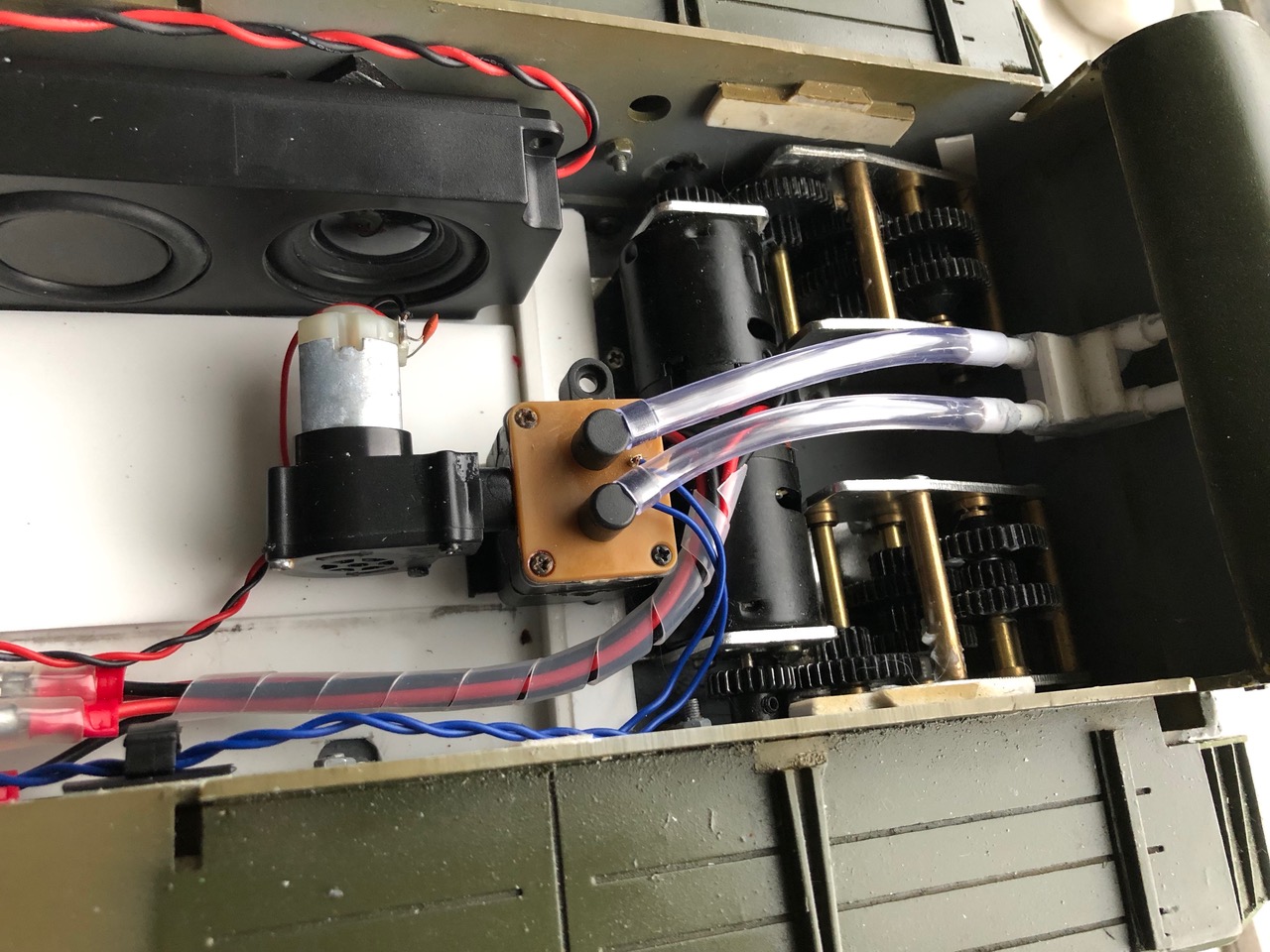

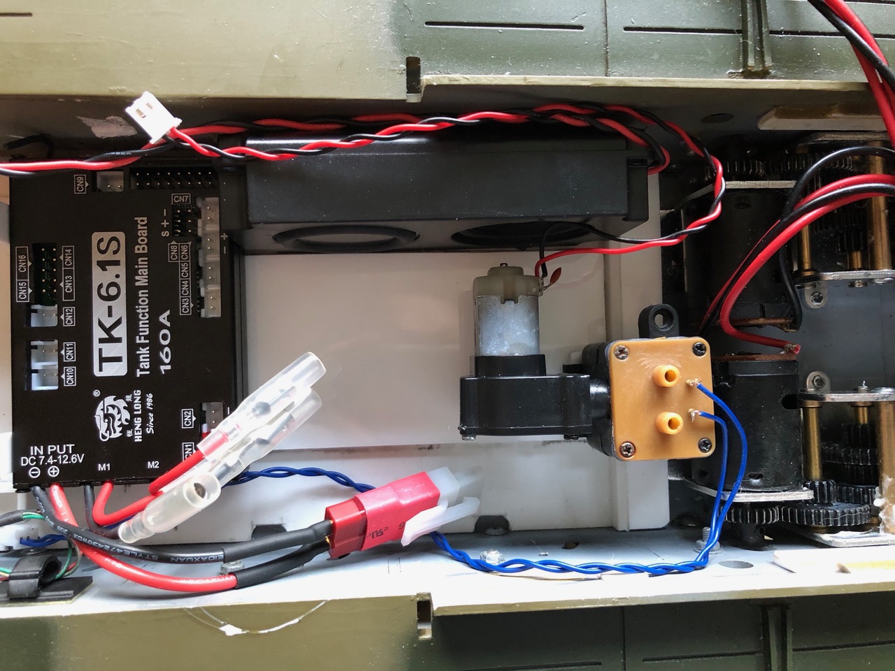

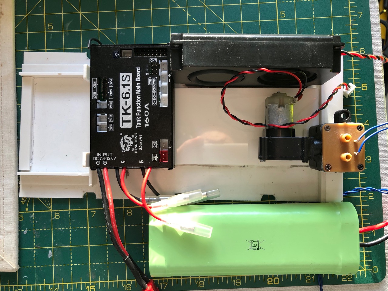

I like to have the equivalent of Tamiya's 'Mechanism Deck' in my tanks. The deck supports their MFUs, and helps to optimise the arrangement of internal components.
I make a longer deck, or tray, which can be lifted out, along with the attached main electronic units. This makes maintenance and repair much easier. The units are attached with double-sided pads, although the smoker also has a screw in the base of the reservoir for additional stability.
Click on images to ENLARGE them. The empty front portion is designed to hold a compact NiMH battery pack. There is a space for the longer type, but I'll be using the compact pack. You'll also notice the Dean's-to-Tamiya battery connector adaptor in place. The 6.1s comes with a Dean's connector. Adaptors can be had cheaply on Ebay.
This is what it looks like in situ. It's just a little step forward...

Good thinking with the equipment tray Roy, it's a convenient way to keep the setup neat and tidy. Just a thought, could you rotate the smoke unit 90° anticlockwise or maybe raise the speaker up over its protruding motor? I feel like you'd get much better sound out of it if it were aimed up and out of the tank rather than into it.
- 43rdRecceReg
- Posts: 6295
Re: Cromwell Mk 4 1:16 scratch build Ludwig kit
Thanks, Dan! The short answer is- No. I tried various configurations, with a view to having the shortest smoke-tube runs, as well as neat stowage and pathways, for the wiring. The speaker should be fine, as I have a similar arrangement if the Comet, and it sounds acceptable. It has a little more bass when pointing inward, but there is a gap behind the speaker (necessary because of two bolt heads acting as intruders...) there I've added a supporting adhesive pad.The effect will be to use the hull itself to carry some extra sound. The main speaker cone isn't actually impacted by the smoker motor, as it booms into free space.Raminator wrote:Good thinking with the equipment tray Roy, it's a convenient way to keep the setup neat and tidy. Just a thought, could you rotate the smoke unit 90° anticlockwise or maybe raise the speaker up over its protruding motor? I feel like you'd get much better sound out of it if it were aimed up and out of the tank rather than into it.

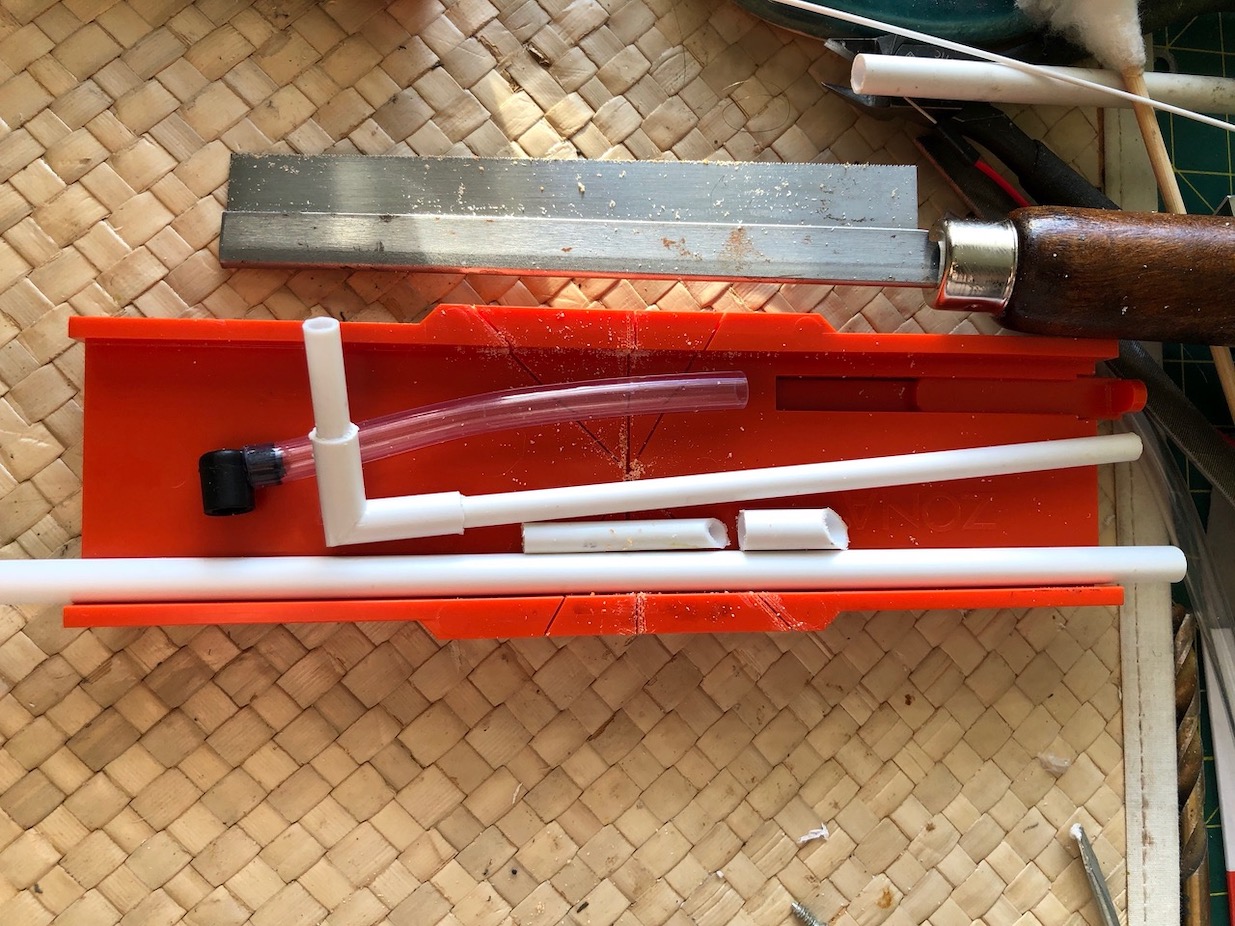

A little progress. I need to make and fit the exhaust pipes. Then I can complete all the wiring in the lower hull.
Click on smaller images to ENLARGE them.

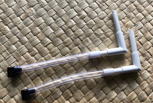

This is the process I used to make exhaust/smoker outlets for the Comet. The difference is, I used a piece of styrene tube one size up from that fitted to the clear tube, to support the mitred joint of the main tube, instead of a sealing ring made out of Milliput.
Click on smaller images to ENLARGE them.This is the process I used to make exhaust/smoker outlets for the Comet. The difference is, I used a piece of styrene tube one size up from that fitted to the clear tube, to support the mitred joint of the main tube, instead of a sealing ring made out of Milliput.

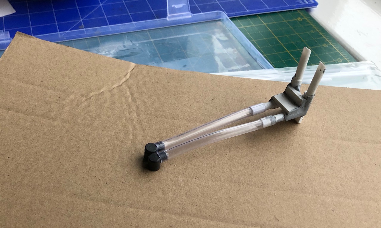

Another small step forwards. The exhaust 'manifold' is now complete and in situ. I shall paint the tailpipes later, in suitable colours, so that they're not so obvious when seen from the rear. I also need some mesh to put in the cowl, as this will also disguise the pipes to some extent.
As far as I recall both the Comet and Cromwell types sporting the 'Normandy Cowls', had a base of mesh within the cowls through which the exhaust was vented. I guess it was there to prevent animals from getting in, and making a home there.

The ends of the tailpipes are cut to a slope to direct the smoke outwards. This arrangement also makes it easy to refill the reservoir, via the tailpipes, without having to tilt the tank at a silly angle (as with a lot of recent HL releases...)
