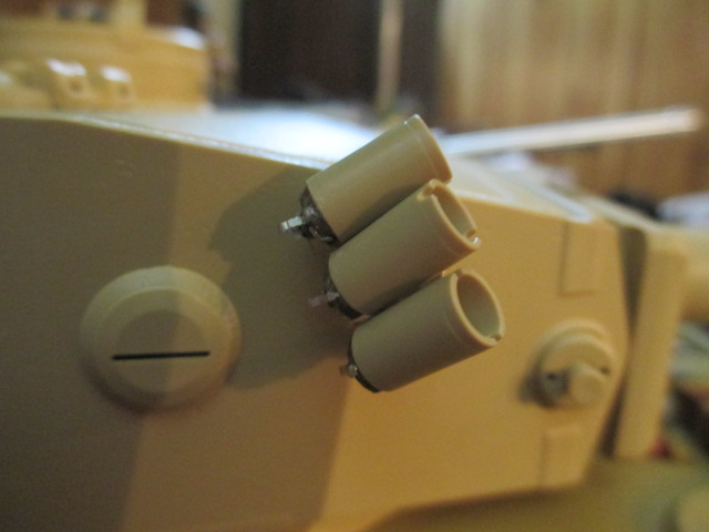

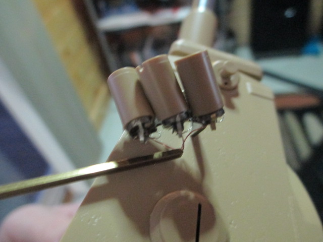

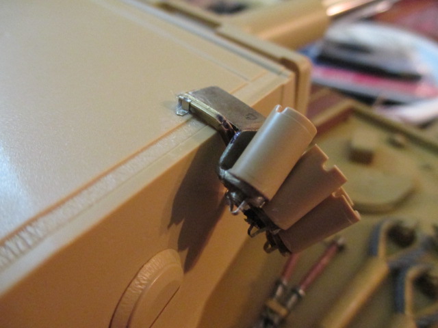

Pretty much over the creeping crud and feeling 'on' after work ( first time in over a week ) so I sat down to finish up the last of the fiddly bits on this tank. Almost three hours later, the smoke launcher wires have been fed into some brass conduit. The conduit has been cut and shaped to allow mounting to the turret roof and detail was added. The MG was asking online if I thought I could do that work again and I believe I can. Once I start on my early Tiger, I should be able to replicate the work done on Mike's. That is a little way into the future. For now, Pics:
This Tiger is almost there.  ;o)

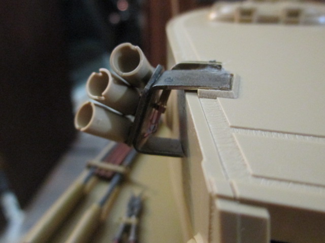

Solid mount.
Solid mount.
Solid mount..JPG (76.92 KiB) Viewed 3660 times

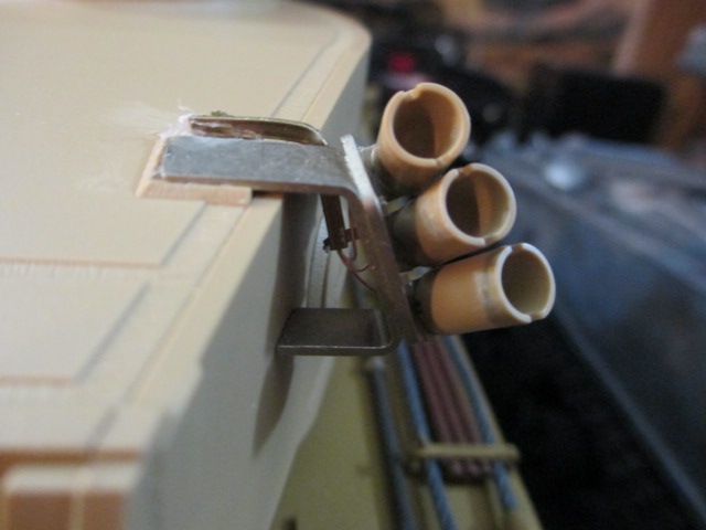

Conduit mounted and ABER detail bracket added.
Conduit mounted and ABER detail bracket added..JPG (86.02 KiB) Viewed 3660 times
Feeding the wires into the brass.  For a moment I thought I had trimmed them off too short.
Feeding the wires into the brass. For a moment I thought I had trimmed them off too short..JPG (83.02 KiB) Viewed 3660 times

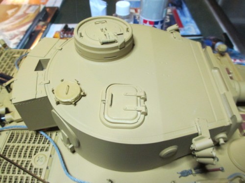

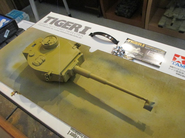

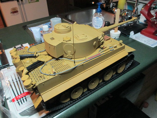

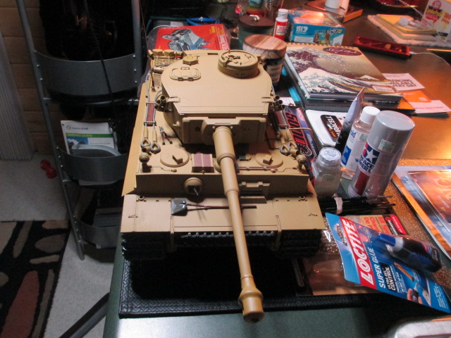

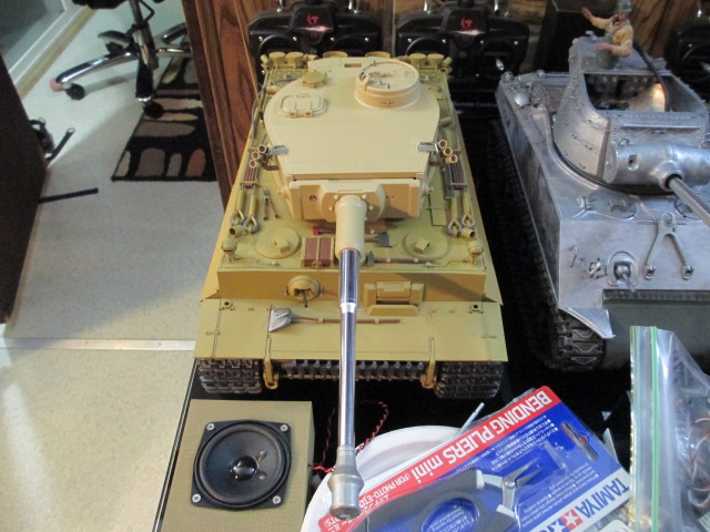

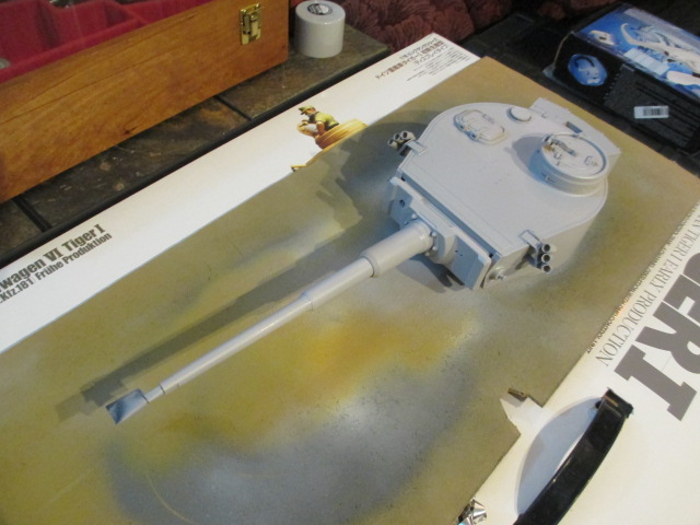

Herman Bix and the Nude Mikes. Sounds like something out of the 60's ( 1960's for all of the young folks ) Whew! At any rate, I painted the turret last night. A couple of coats of the excellent Tamiya Plastic\Metal primer followed by two coats of the Model Masters Desert Yellow. It's sat for 48 hours so tomorrow, I will plug everything in, close up the tank and do last detail and a pin wash. I finally broke down and will do the wash like the real Masters recommend, 50/50 mix of black oil paint and turpentine ( odorless ) After that, there will just be the Commander to do. I've got a couple of tricks up my sleeve for him as well. Pics:
Turret closeup
Turret closeup
The color from another angle, same lamp, same camera, same time photos were taken.
The color from one angle...

Two coats of the equally excellent Model Masters
Two coats of the Tamiya primer.

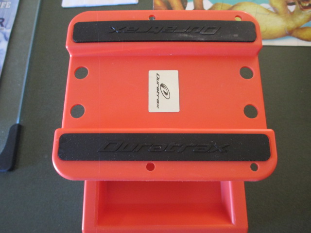

Trays for small bits are molded in and the upright is a solid piece of aluminum.

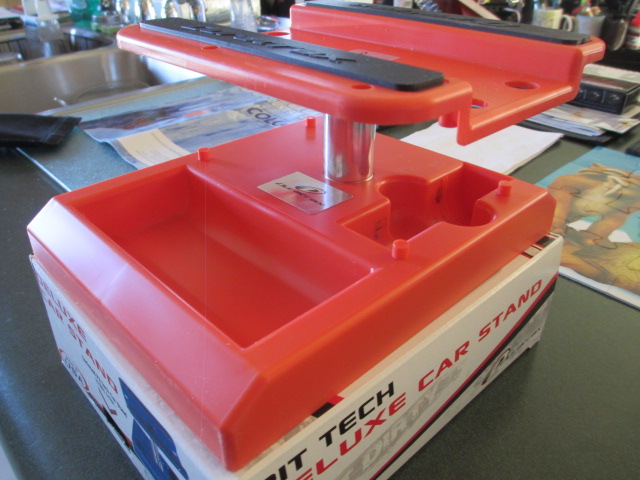

Another useful tool when working with Heavy Tanks.
Another useful tool when working with Heavy Tanks..JPG (95.39 KiB) Viewed 4466 times
