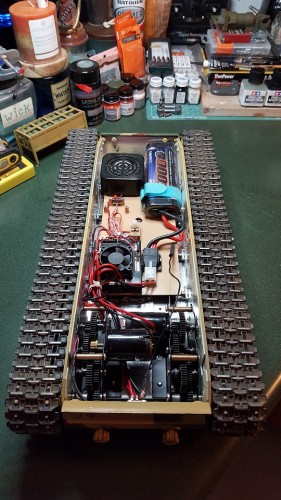

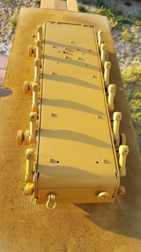

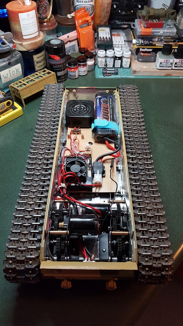

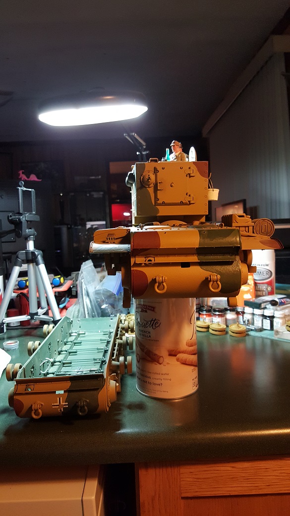

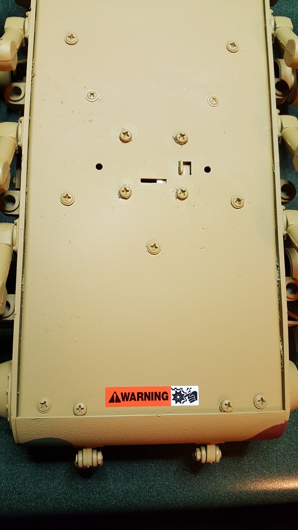

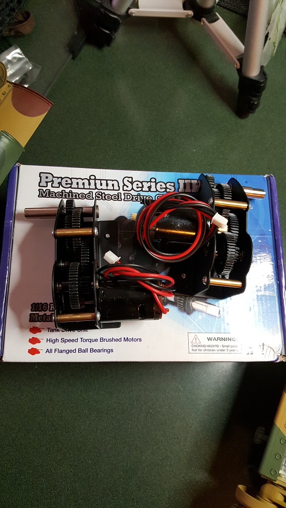

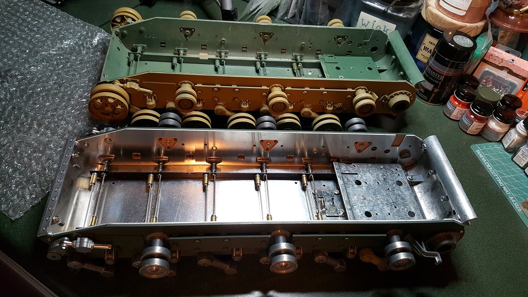

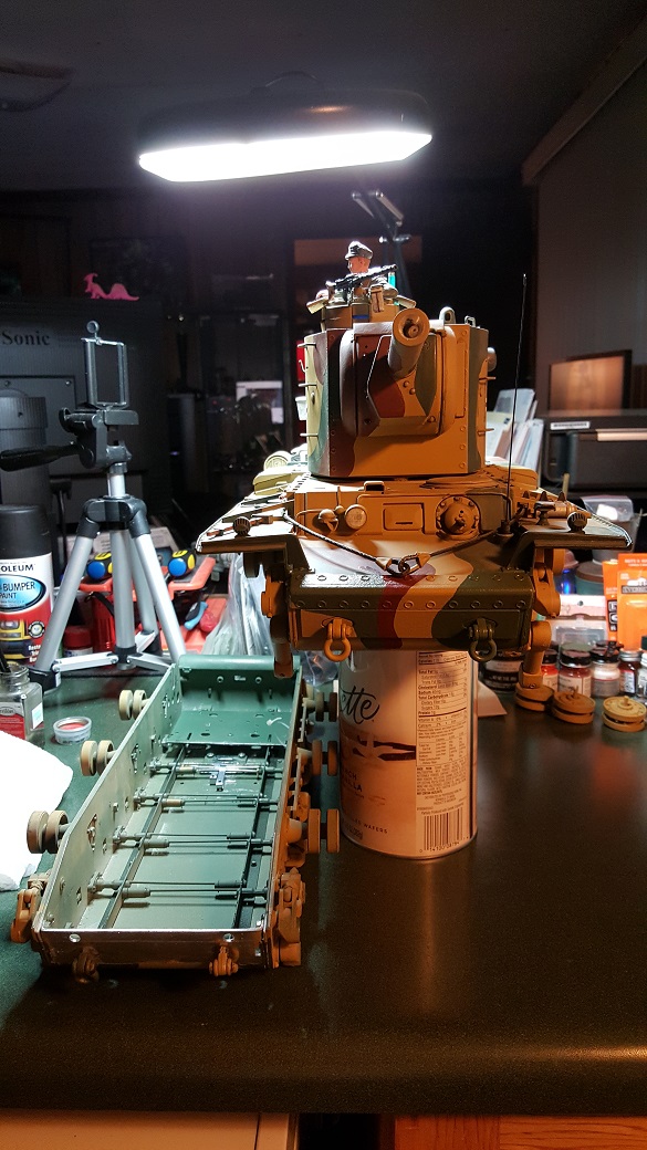

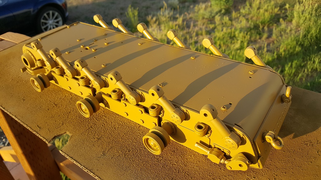

Four years on, I ran the 'Palace' out in the North Africa section of the lot to do a photo shoot for a past Tank of the Month. Some great pics resulted but later during the cleanup ( dusting grit out of the tracks, etc ) I noticed a clicking noise while the tracks were running and the drivers side track seemed slower to respond. I knew that there is no slipper clutch in a metal gearbox so I opened it up and sure enough, the zinc cast gear box was kaput on that side. The great weight of this tank had finally worn away the teeth on the gears. The other side was not in much better health. Time for a Redo! A couple of months of collecting the right gearboxes ( had to order from Russian Federation since Taigen was out in the states ). Kindly assistance from Forgebear netted a brand new lower hull and return rollers. ( again, Taigen was out of stock ). Lower hull, you might ask? Well in the tear down, I noticed that the front of the lower hull was bowing out a bit ( from what I could not speculate ) and I went to tap it back into shape with a small brass hammer resulting in shattering the add on armor plate on the bow!!!! This included the 'L' shaped lip that keeps the upper in place. So after rueful searching later, months of waiting ensued. I had epoxied everything back together but I could not reach a point in the process where I was satisfied. So a serious Re-Do resulted. At the conclusion, the 'Palace' rides again, better than ever! Here are the pics: ( Click to enlarge as usual )

Same with the rear plate armor
Paint matching on the bow plate...I changed the pattern slightly
Now to use the Rottbraun and the Olivegrun to match the paint scheme on the upper again.

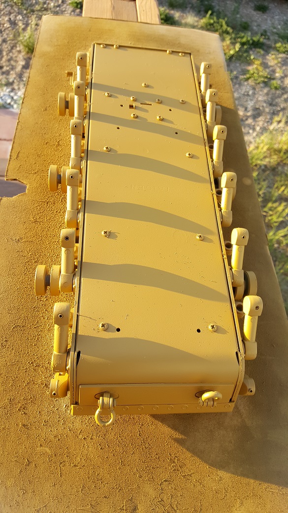

Three coats of the Model Masters Desert Mustard

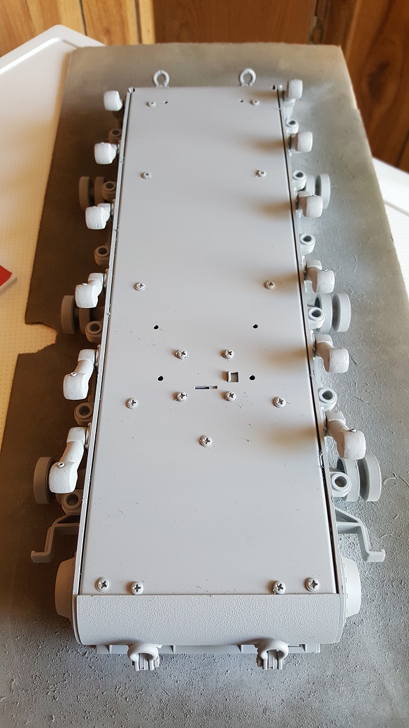

Two coats of the Tamiya metal and plastic Primer

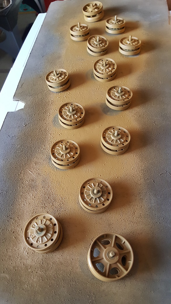

A Desert Mustard refresh of the backs and rims of the road wheels and idlers

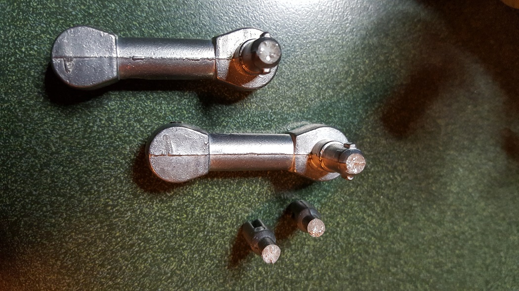

Casting Bubbles Cause Swingarm Failure
New and Old
New and Old

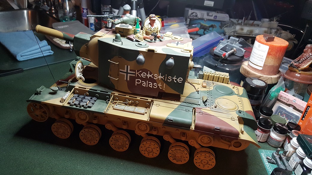

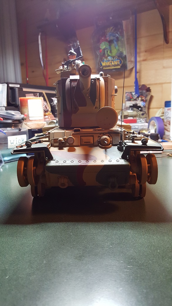

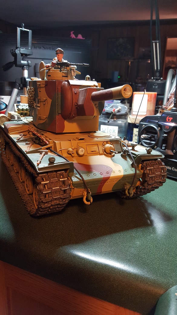

The Palace rides again!

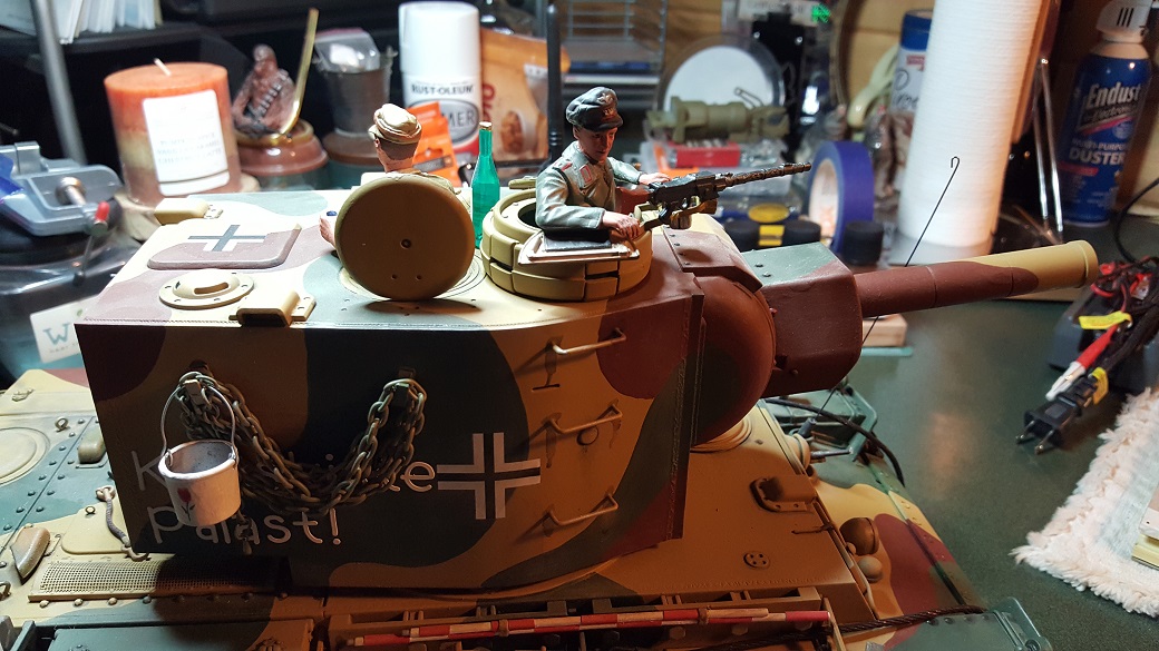

Obligatory turret photo

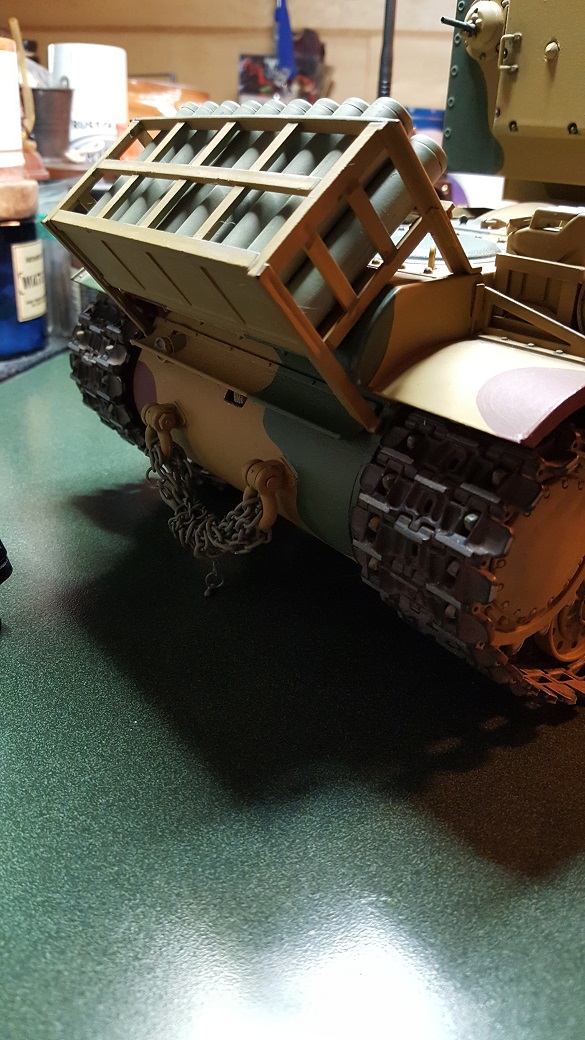

Chain wound back onto the rear tow shackles ... No German Cross this time ... looks cleaner I think
Gearboxes installed and all of the electrics put back as well.

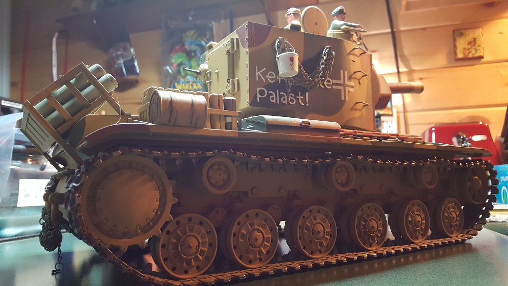

Finally a chance to use these...

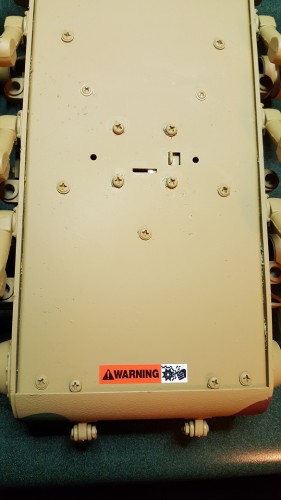

An important Safety Warning reapplied
