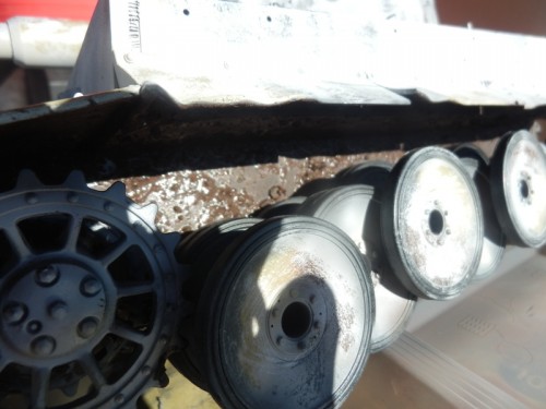

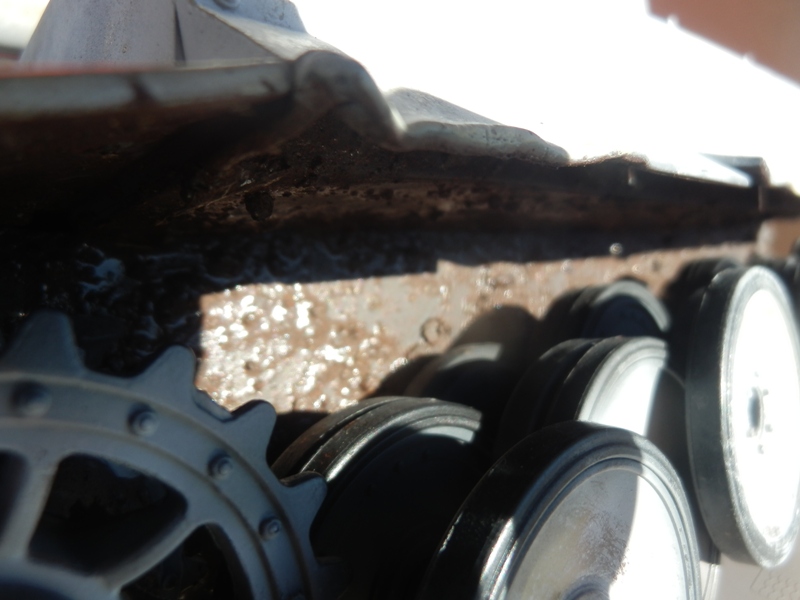

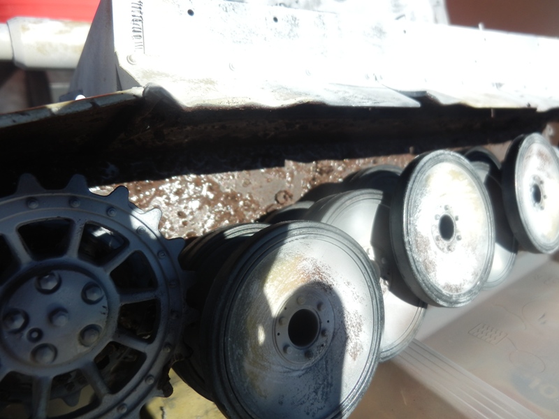

Layered on a bit of mud mix under the guards & on the hull behind the roadwheels.
used a brew of white glue, potting mix sifted to remove big lumps, and a blend of oil paint & tamiya flat black to temper.
I can do more mudding up once the tracks are fitted but the areas behind the roadwheels are to hard to do with tracks installed(as I found on my Jagd.)
Once the hull section of track is placed, weathered and mudded up then the whole lot can be dirtied and then sealed.

SHE'S SO DIRTY :O ....................... :haha: ..Nice soiling technique Herman...looks like she ran through and churned up some Nestle's crunch bars ;)

Lot of that going on in my house right now !!!!
I can tone down the texture for the wheels & tracks once the tracks go on & all the other weathering gets done, but under the guards & on the hull is a good place to put the chunks of earth, plant material & stones etc that would get deposited under there.
Plus it gives a key for any snow effect to stay on !

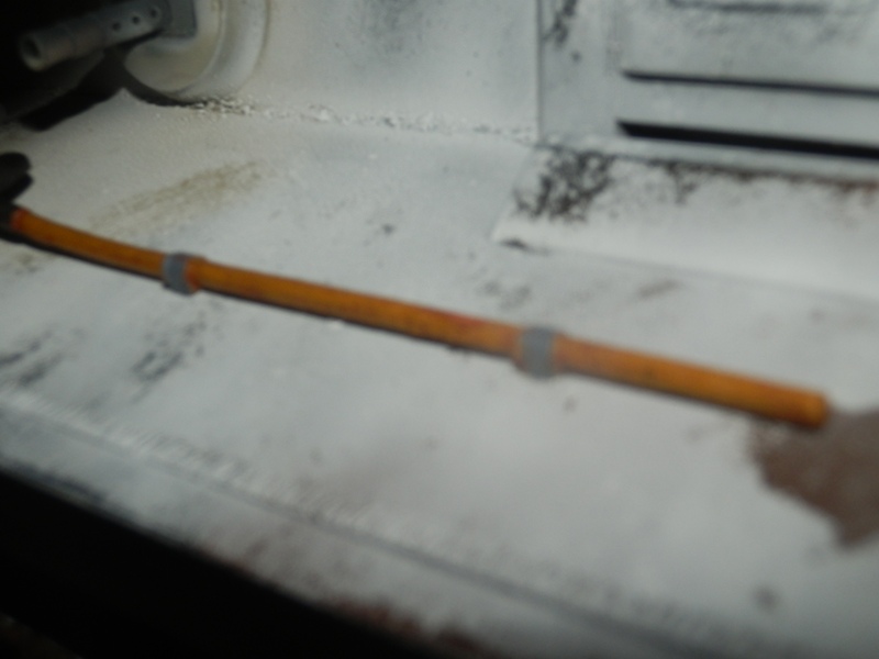

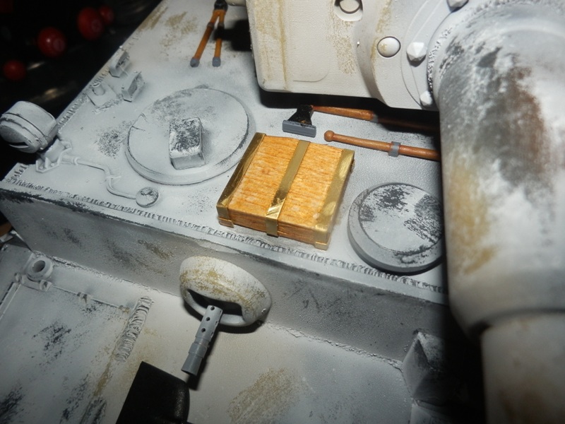

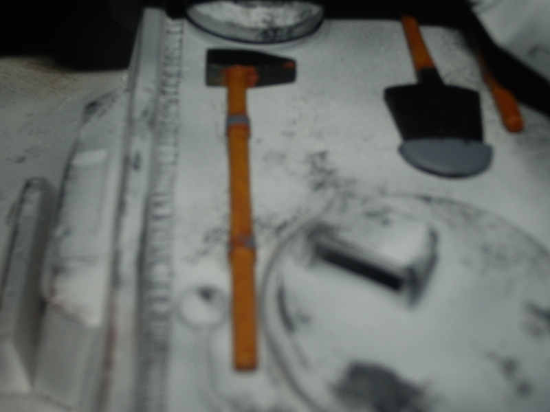

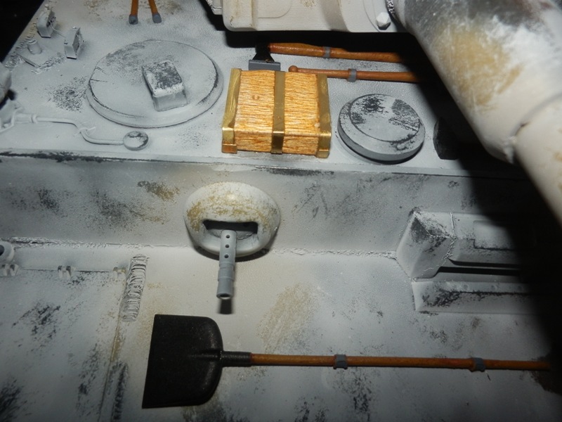

I got on with painting the stock H/L tools last night.
I think I discovered the elusive "wooden paint" :O
Used oil art paint burnt Sienna for the undercoat, un thinned, with a fairly stiff brush. Gave the handles a bit of texture.
Once dry, went over with a softer brush with another oil colour Raw Sienna and kind of dry brushed it over.
Impossible to photograph well, but seems to have given the desired effect of timber grain.
Used a mix of flat Black & gun metal to do the tool metal, and thats turned out pretty good too.
Secured all into place on the deck & put the barrel cleaning rods into place.

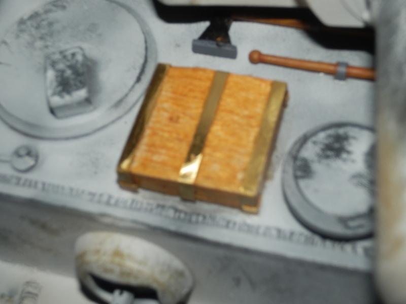

Made a jack block out of balsa and brass engine cover screen sprue, coated with British Paints Golden Oak Stain & Varnish same as the barrel rods.
All I need to do is brush blend the mounts in on the tools and jack block, and drybrush the WW over top.
Cables to do and track changing cables to mount.
