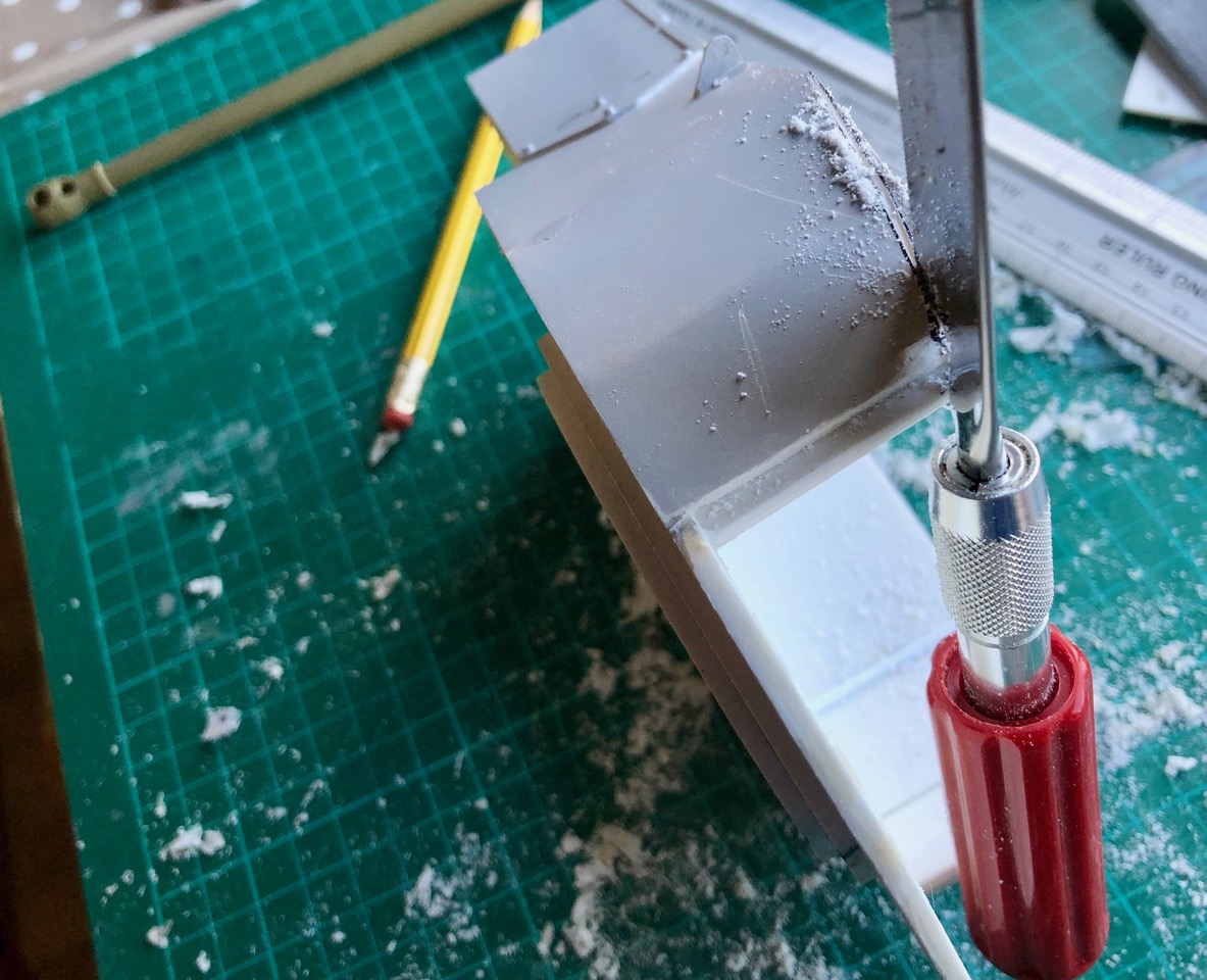

Time to don the surgical mask, and get the saw out...
(Click on pics ENLARGE)

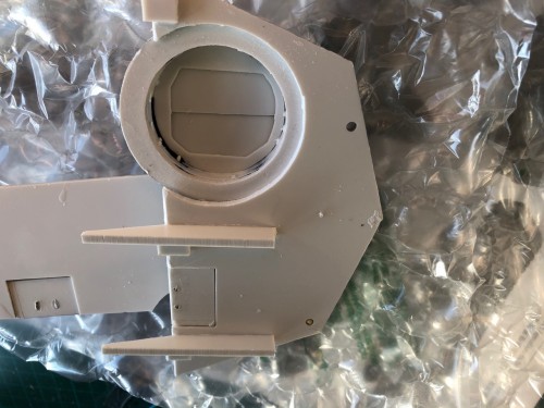

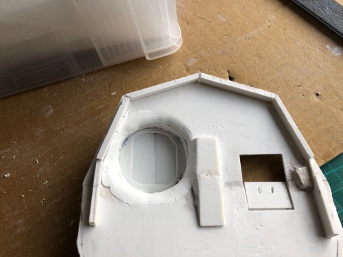

Comet update-turret tweaks- new roof incline
Comet-turret tweak- adding roof supports at correct angle

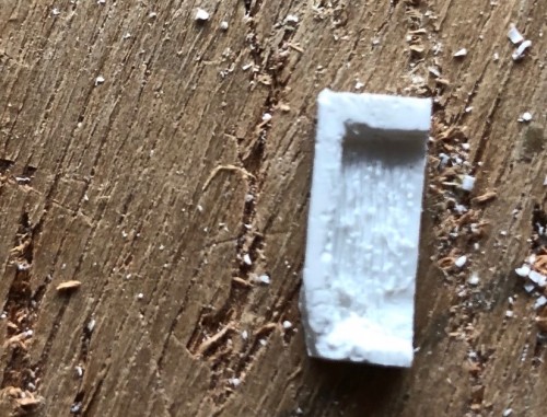

I cut some internal support brackets using the template I'd made. These will help me bond the two sections of roof together at the new angle.
Here, I cut a ring of styrene tube to form the lip that's apparent on the bomb-thrower/smoke grenade launcher.
Comet update- turret tweak-bomb thrower lip
Having determined that a removable one-piece roof (as with Tamiya's Tiger 1) is preferable to the partially, or wholly bonded one, I've begun adding an internal supporting flange that will allow the roof to slot into place. It's a good interference fit with these bits in place (I'll tidy them up later... :D ) and, with a magnet or two, should keep the roof in place when the tank's outside running on the rough ground. :|
Comet update-flange fitted to aid retention

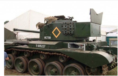

Next, I drilled some holes for some copper wire to represent the brackets that hold the spare tracks in place. They were bonded in place with JB Weld (metal). So far, I've found no other product that bonds metal to metal, metal to resin, and metal to styrene, as well as this able to. :thumbup:
I'm basing the brackets on the ones visible in these two pics. They're also supplying supplementary visual details for the storage box.
Comet storage box and track holder brackets
Comet track holder brackets

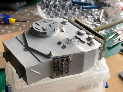

Finally, the Mantlet has now been permanently bonded in positon. That's a relief. :/ :D
This is what I've come up with so far:
Comet update -model track mounts
Right now, I only have the top brackets in place. To make the bottom ones (which function like clips), I'll have to flatten the copper with a hammer... (Before i I fit them to the turret :lolno: !)
Eventually, I'm going to use Milliput around the edges of the (detachable) roof to simulated a long welding bead, and to make the parts blend in.
Comet track mounting brackets

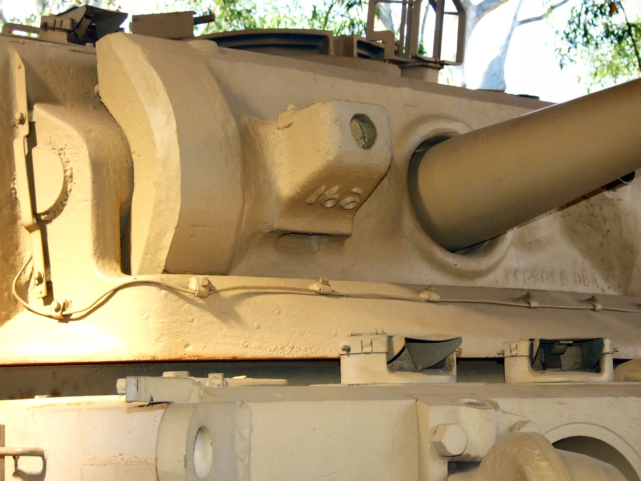

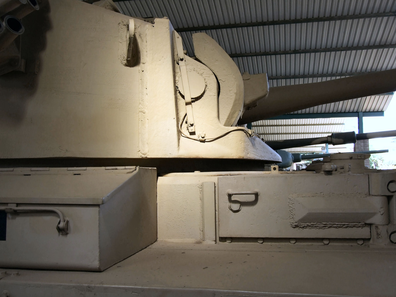

Getting details right is one of the driving forces in rc tank modelling. Flaws and imperfections, which occur naturally in the manufacturing process (especially in WW2 Russian foundries)- those rough bits, in other words, are sometimes difficult to scale down. Pitting in cast turrets is tricky to replicate. So are weld lines Still, all you can do is try. :D
Here are some examples of examples of roughness found on the Comet's Turret (Click to ENLARGE these):
Comet-rough surface occasioned by casting
Comet-Mantlet-pitting from casting process
I copied the full-scale Comet pics from : http://www.primeportal.net/tanks/paul_a ... a34_comet/
Comet- Mantlet weld line

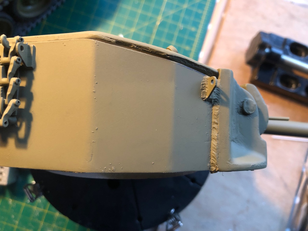

Thus far, I'm happy with the Mantlet weld line. Later, I'll have to create a weld line right around the turret roof which will conceal the rough edge above, and the fact that the roof is detachable. :)

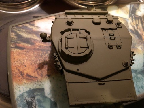

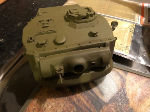

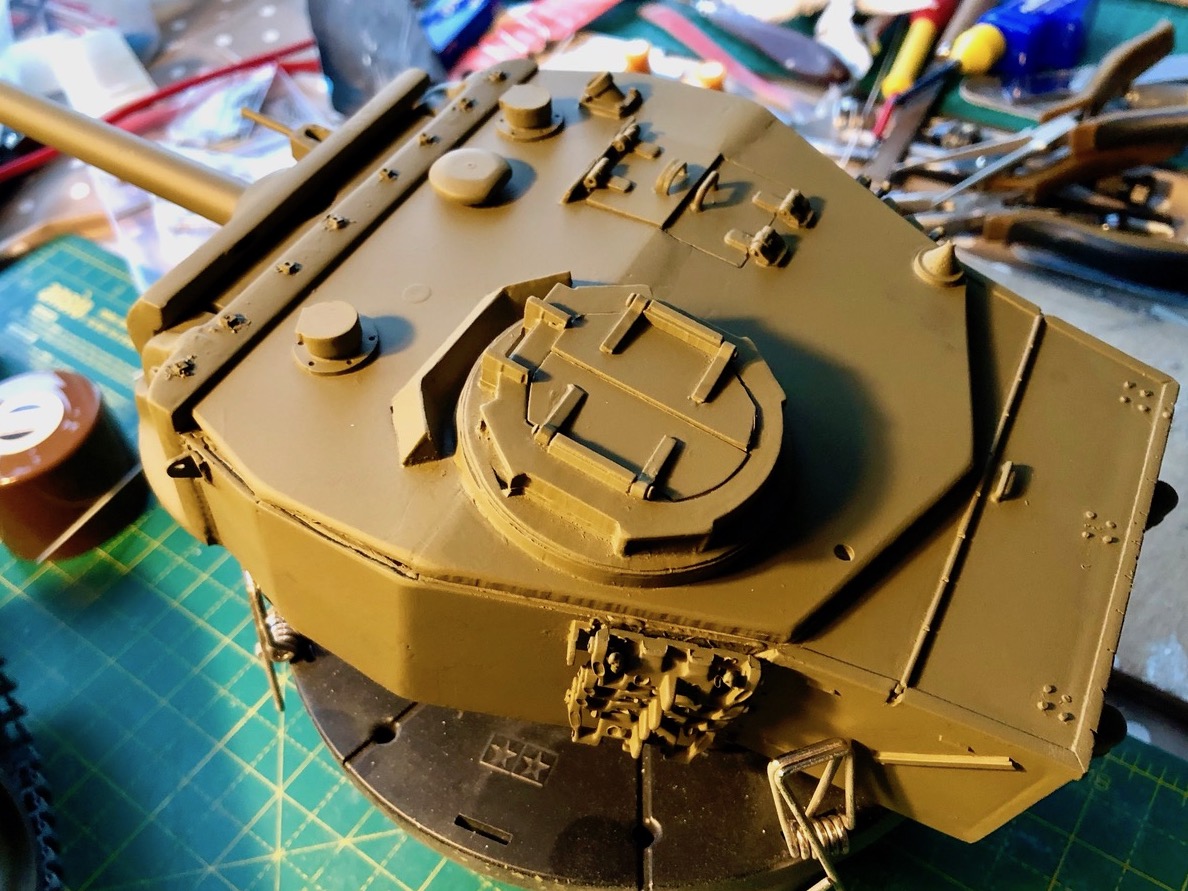

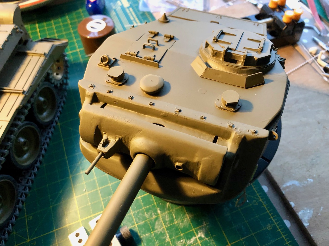

Some added details below. Provisional painting is a good way of determining how well the build is going, and where details need to be added, or enhanced.
Turret with rough details:

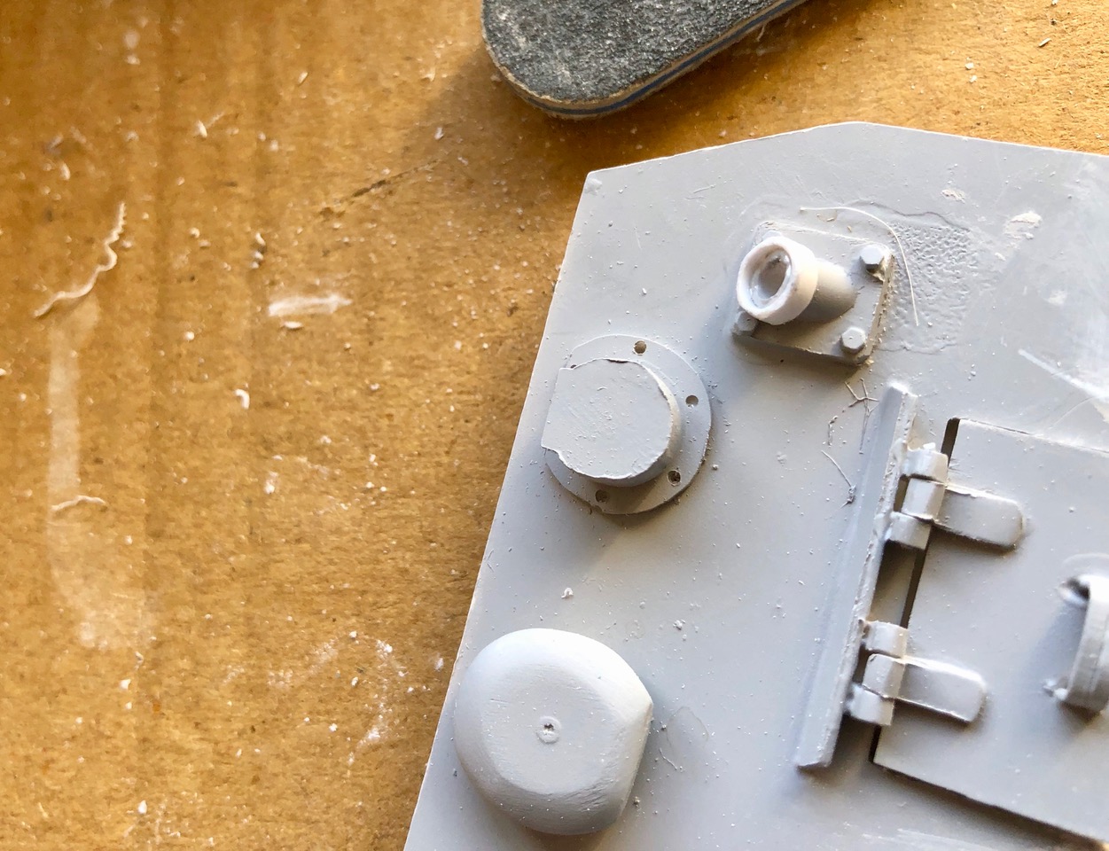

I've added some tiny captive nut brackets (they're used for the canvas waterproofing mantlet cover) on top of the Mantlet. I still have to add the Commander's gunsight, and the main aerial (cone shaped-triangular type).
Comet Turret -front detail
I won't begin the hairpulling over that design feature, until I'm satisfied that the exterior is finished. :think:
Turret-side view with tracks and storage box details

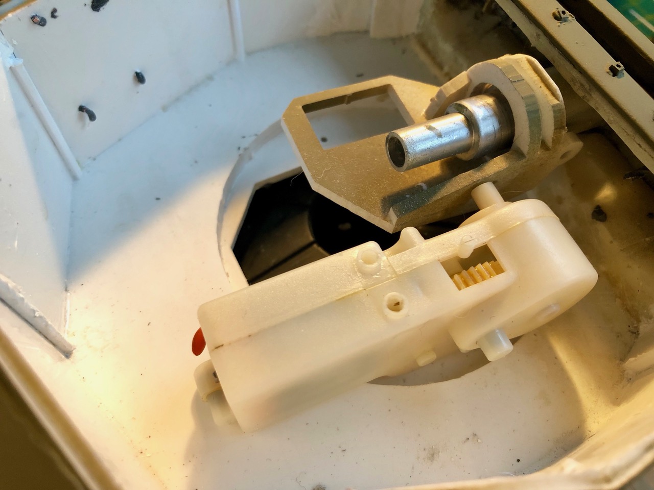

In the meantime, here's an idea for the elevation function. This unit is the one from the Sherman and Panther, if I remember correctly.
First cannon elevation option-

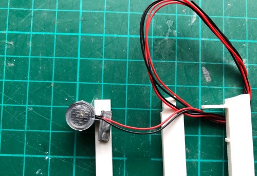

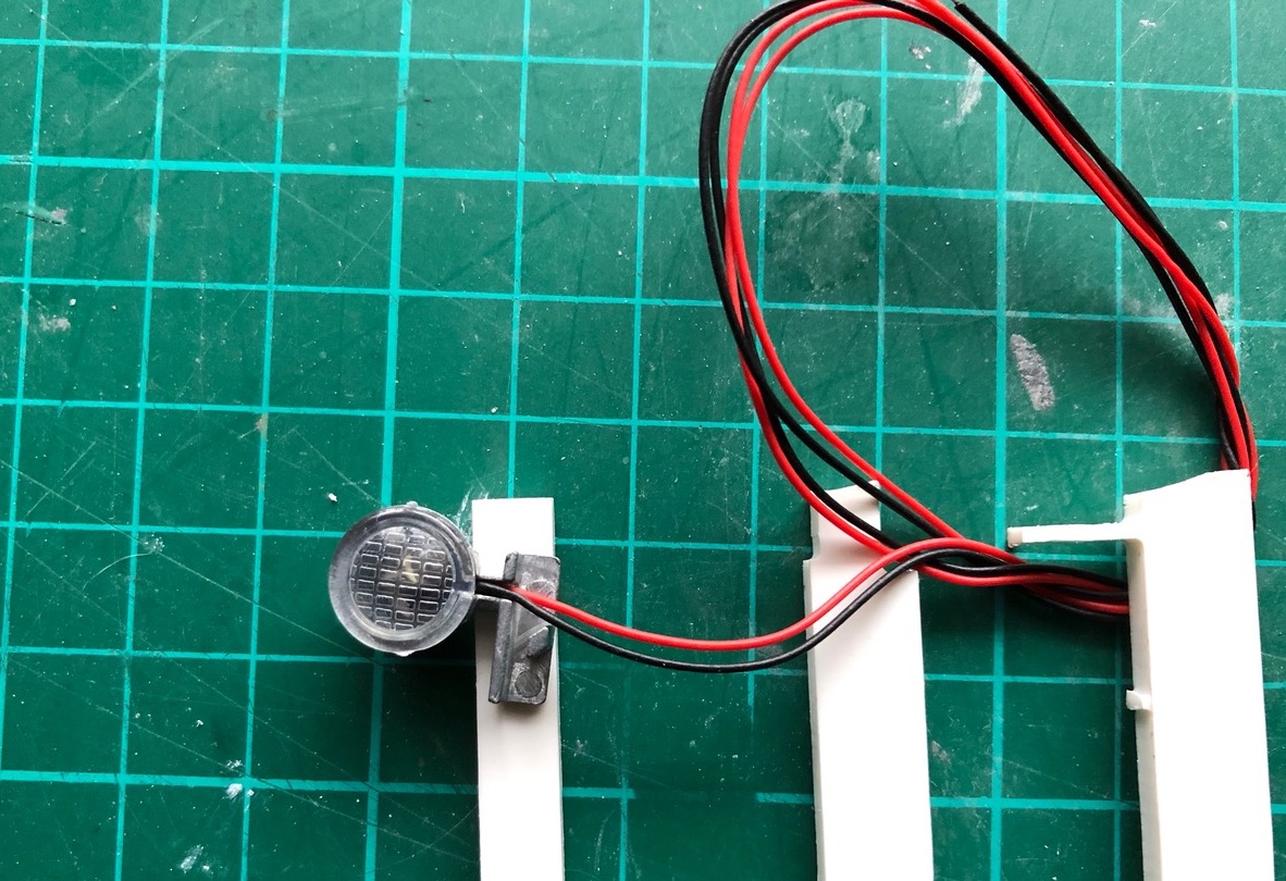

Many Comets had a spotlamp fitted to the turret, just like the Cromwell Mk IV. I'd like mine to have one, as well. To make this happen, I bought the T34 lamp; made a mounting bracket out of styrene; bonded them, and then ran the wires through a hole in the turret wall. On the actual Comet, the wires enter the turret through the turret roof, near the bullet splash plate. But since I want the roof to be detachable, it's best to have the wires go through the wall.
Click to ENLARGE following pics:
Comet spot lamp-pic A
Styrene mount bracket for turret spotlamp

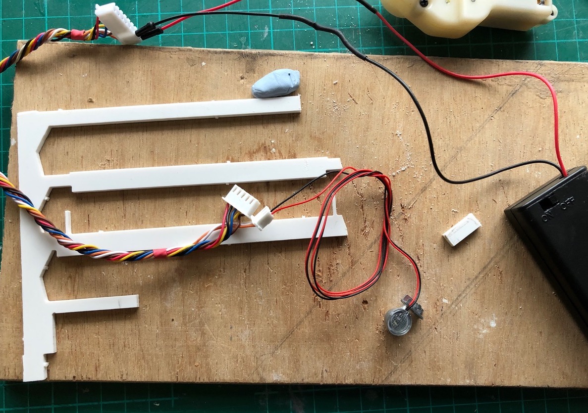

Spotlamp wiring for test
Not much point in going to the trouble of fitting the lamp, if it doesn't actual light up... :|
But...Fiat Lux!...and lo, there was light. :D Yippee
Spotlamp test
Spotlamp test

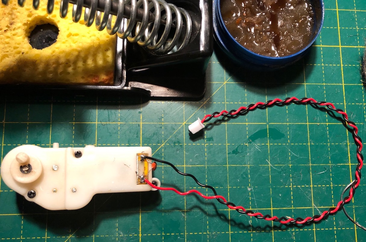

The Elevation unit is supplied without wiring, making it necessary to solder a JST to it.
Elevation unit-supplied without connector
Comet elevation unit wired
I tested to unit to make sure it actual works, but I'll also have to run trials to determine where the optimum position for the unit to be in the turret, in order to elevate the gun properly.
