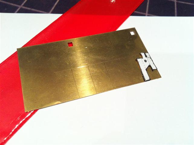

Here is the PE sheet containing the Schurzen hangers.
It's a shame I wont be using these 2 sheets for the side and front fenders.

I annealed the PE sheet by lightly passing it on the burner flame and then started freeing the hangers from the sheet. I learned that heating PE sheets and allowing it to cool slowly will make them more pliable and less brittle. This is useful (as I soon found out
) if you make a mistake and have to re-bend the part repeatedly and don't want to break the metal at the bend.
I followed the below instruction for bending the hangers. I also decided to add a wire at the top of the piece so I can more securely attach it to the plastic fender of the tank.
Here is my first attempt at the hangers with the wire soldered in place. Turns out I made a mistake.
Since the hanger was designed for the included PE fender the default bend line would be too low for the HL plastic fender. It has to be bent on the indicated line below (green) if you want the schurzen plate top to hang flush with the top of the plastic fender.
Here is the hanger with the corrected bend line.
The second thing you need to look out for is if like me you are using a plastic Schurzen plate which is thicker than its PE counterpart. Since the hanger was designed for PE metal plate then make the stock bend higher to compensate.
Another problem was trying to solder the wire on top of the hangers. For some reason the solder would not take hold on the hanger and wire and I could not get a strong bond. This could be the result of the thicker metal sheet of the hanger dissipating the heat (via conduction) of the soldering gun thus not melting the solder fully.
One solution I came up with to address this was dropping a glop of solder on the join, adding flux and using the flame from a burner to fully melt the solder. The result is below. Notice the blackening of the hanger due to the flame. However this method fully bonded the wire to the hanger.

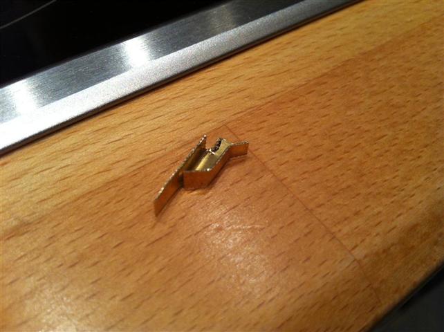

I see you are using quite thick gauge metal sheet for the hanger. How did you cut it? I would think cutting it with just scissors would be hard. And then there is a hole in the hanger that must be drilled as well. I could probably do the 1st and 2nd one to look the same but it would be hard for me to have all 12 pc hangers cut consistently. I think I would need a stamping machine to do that.
I am still amazed how hotte8487 had the patience to cut all the hangers by hand.
