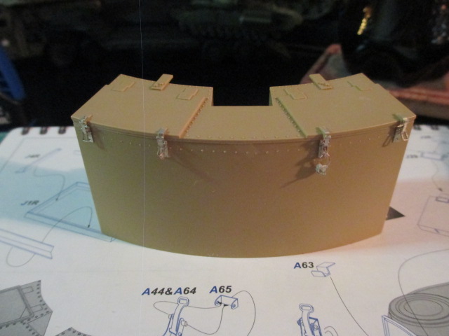

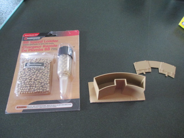

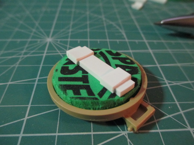

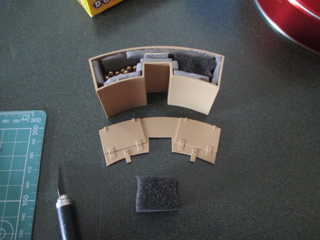

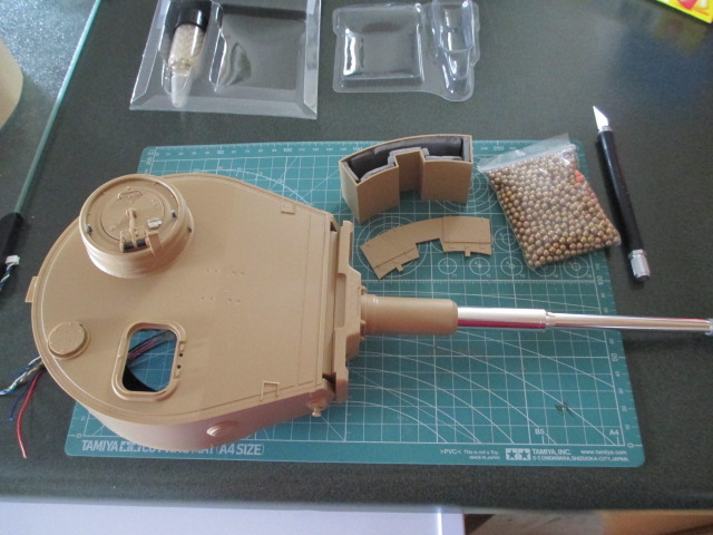

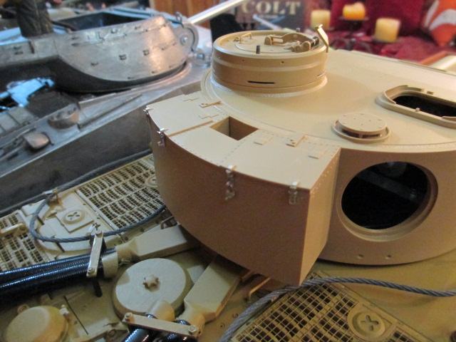

Thank you again, Hotte! Praise from a Master at the Craft gets the blood moving it does. ;o) Today was Martin Luther King Day in America and my Client Account was off of work and so was I. A huge snowstorm had blown in yesterday and we had over a foot when I got around to getting around this morning. The Mate ( who was not off work today ) gave me marching orders to the Grocers so off I went. 60 miles as the Jeep flies and a couple of hours later, I was home and we were well stocked. After lunch and a nap, I got back to the Tiger and decided to do the Rommel box from Tamiya RC Step 41. First off was adding weight to counter the aluminum barrel on this beast. I was going to use self stick tire weights but it hit me that a better solution was at hand. Once the box was lined with foam and ready, I balanced the turret using my steel shot method. I decided to use the Tamiya cover to help keep the weight from moving around, ( half the remaining Rommel box volume ). After that it was ABER time and I just finished up a little while ago. The box is permanently mounted now and has the turret sitting nice and even. Pics:
- ABER fiddly work done with four mounts and two hasps and one lock and key
- ABER fiddly work done with four mounts and two hasps and one lock and key.JPG (81.79 KiB) Viewed 3514 times
- The box interior was foam lined to keep the shot from rattling around. This required some trace and cut.
- The box interior was foam lined to keep the shot from rattling around. This required some trace and cut..JPG (99.59 KiB) Viewed 3514 times

Awww, you're a hard man but Ok. We love our blandishments around here. ;o) That's a great idea with the clear sprue! I was going to do five mini clear resin pours and just fill up the vision block box but decided instead, to cut the little squares out of clear plastic that I had laying around. I'll be looking for pics of your 1/35 and 1/16 Cromwells, sir. Thank you!, I wanted something that allowed me to change the weight I was adding to the turret easily. My eyes fell on some of the many thousands of steel shot that infest my Office and it was pretty simple after that.

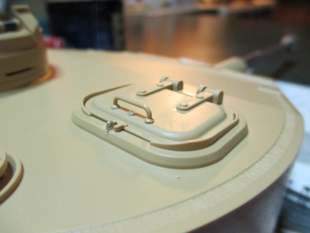

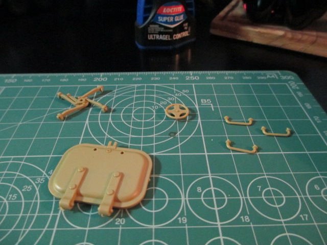

Today after work I looked through the remaining sub builds of the various steps and went with the Loader's Hatch from Tamiya RC Step 42 and 43. ABER added a page and 3 hours or so. While I was looking at detail pics of Tiger tank loader hatches, I noticed another thing that ABER did not provide for. Some wire and the Yankee Drill added some more needed detail. Pics:
- Outside hatch and rim showing lock hasp and key hole slide in place.
- Outside hatch and rim showing lock hasp and key hole slide in place..JPG (76.69 KiB) Viewed 3477 times
- Installed before paint and weathering
- Installed before paint and weathering.JPG (98.02 KiB) Viewed 3477 times
- Completed hatch with the pull handle added.
- Completed hatch with the pull handle added..JPG (83.18 KiB) Viewed 3477 times
- In progress with the ABER hatch stay and key lock interior detail added.
- In progress with the ABER hatch stay and key lock interior detail added..JPG (90.64 KiB) Viewed 3477 times
- I went with the last couple of steps on this page as Tamiya parts had all of the earlier detail added already. I did put in a few nuts and bolts for inner hatch detail.
- I went with the last couple of steps on this page as Tamiya parts had all of the earlier detail added already. I did put in a few nuts and bolts for inner hatch detail..JPG (96.45 KiB) Viewed 3477 times

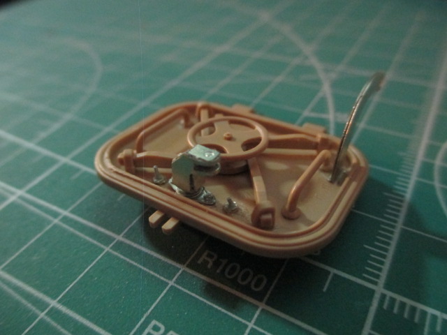

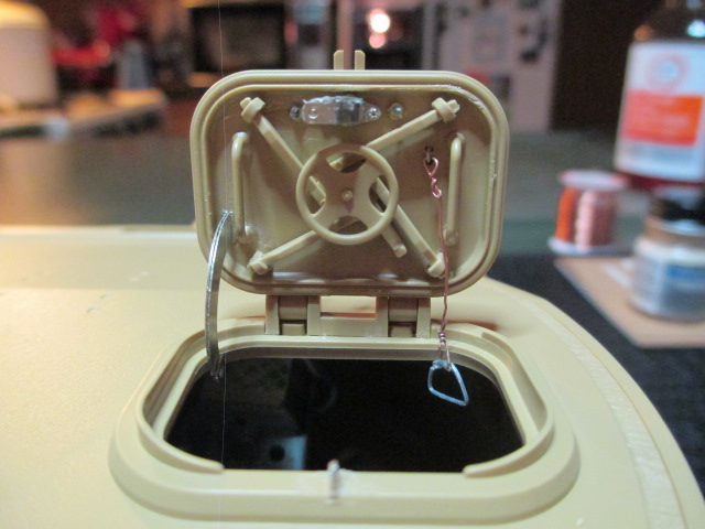

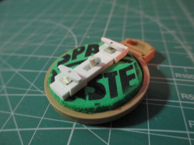

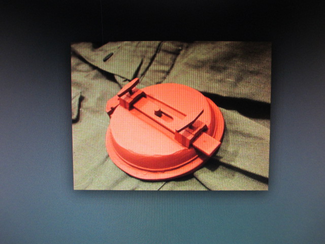

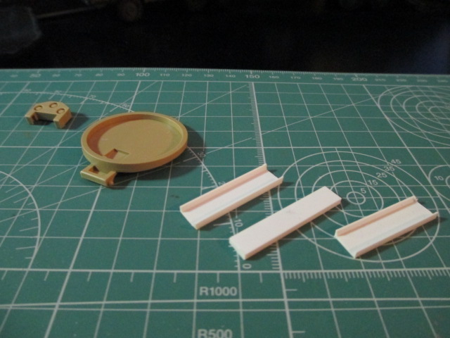

Sat down after work to see what could be done with Tamiya RC Step 43. I went with the Turret Escape Hatch. Tamiya's parts are nice but no interior detail. Amazingly enough, ABER had nothing to offer for this part. I guess they figure that most people just cement it into place. I could have but no dice. Sassgrunt might want to open it one day and since the hinge works, some scratch building was called for. Pics:
- Finished. I'll let it cure overnight and paint and install it tomorrow.
- Finished. I'll let it cure overnight and paint and install it tomorrow..JPG (90.3 KiB) Viewed 3899 times
- Work in progress...
- Work in progress....JPG (96.59 KiB) Viewed 3899 times
