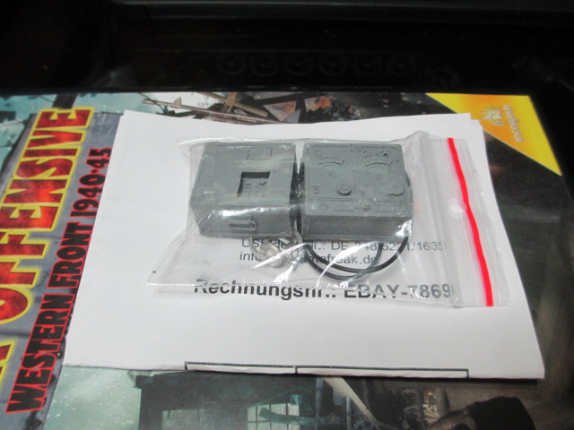

Now that I see it, this radio is too pretty to chop up for the face plates.  I think it will have to ride up top beside the Loader or Commander.
Now that I see it, this radio is too pretty to chop up for the face plates. I think it will have to ride up top beside the Loader or Commander..JPG (97.53 KiB) Viewed 3443 times
Diorama Freak aka An-Bri-RC.  I think.
Diorama Freak aka An-Bri-RC. I think..JPG (87.04 KiB) Viewed 3443 times

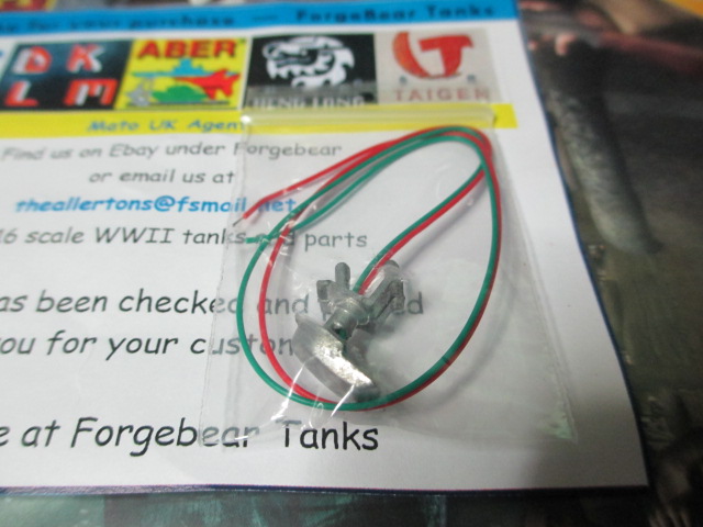

Forgebear comes through with the right kind of LED for that Convoy light in the rear.

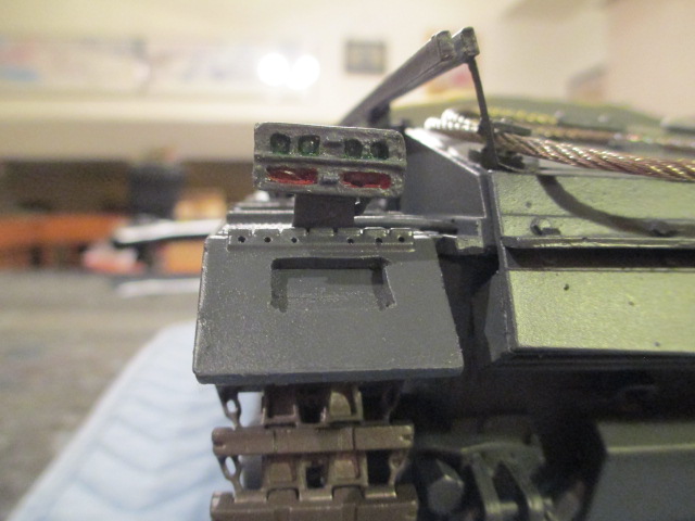

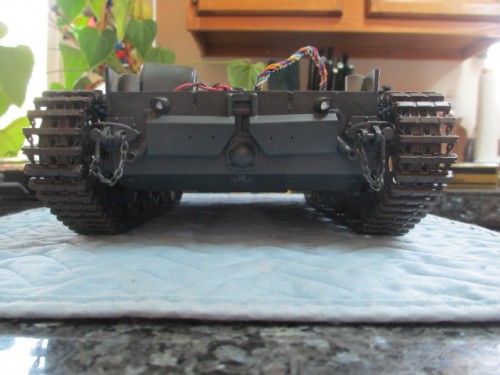

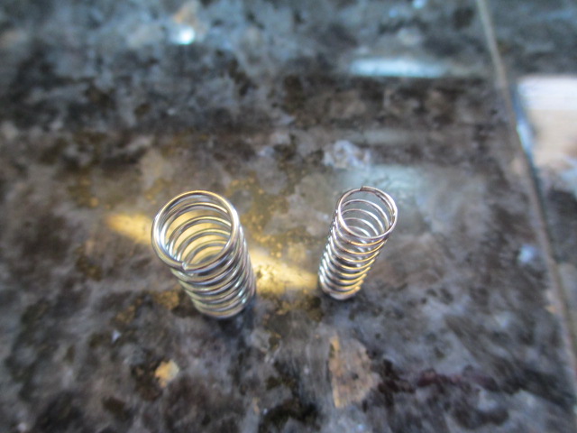

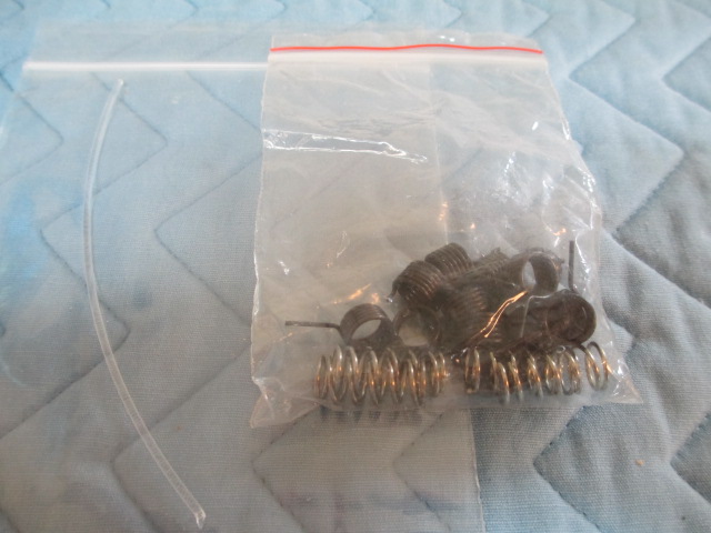

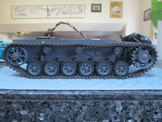

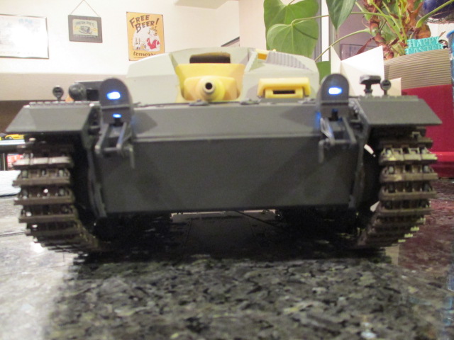

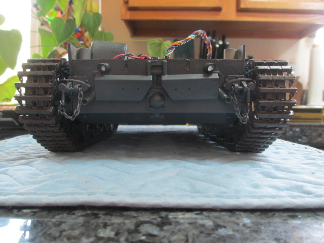

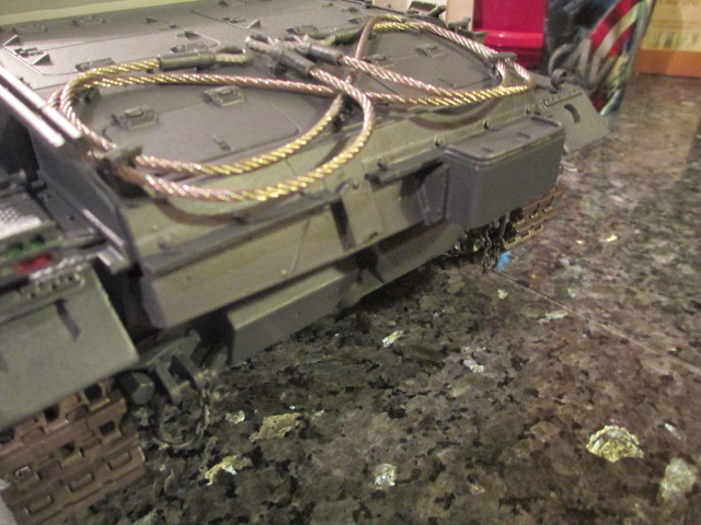

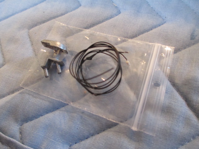

Post brought in the Fiber Optic piece from Welsh Dragon on Friday and the MATO replacement springs for the lower hull on Saturday. Today was finally quiet around the house so I put the time to good use. I wanted to revisit the deck and see if I could get the rear Convoy light cleaned up and working as well as correct the lower hull's tendency to 'sit down' in the rear and not rise back up when pressure was released. I did the suspension springs on the rear shock mounts first since they were clearly the issue. Of course, the replacement shock springs were much too large. I salvaged the fix by extending the stock spring a bit and putting the HD suspension springs on those two arms also. The Convoy light took the rest of the afternoon. I removed the light body and disassembled it to see if I could find out why it hadn't worked. It turned out that one of the wires was loose from the micro LED. I took the opportunity to clean up the housing and make a lens for the light by using clear double stick tape. The Glue Monkey had apparently been on loan to MATO as it took a while to free the replacement LED from the extra front tarn light without ruining it. The new LED was attached in the fixture by simply sticking it on the rear of the 'lens'. Reassembly, glue and paint saw the piece remounted and looking many times better than before. Solder and a two pin plug were followed by a successful test. When driven in reverse, there is a warm green and red light there. Worth every minute spent. Pictures:

Left over Tarn light housing and non functional bulb.
The redone rear Convoy light.  A big improvement.
The redone rear Convoy light. A big improvement..JPG (92.49 KiB) Viewed 3428 times
Rear springs right back up when depressed now.
Even stance front to back

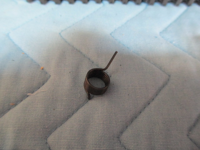

A couple of these replacements used in tandem with the stock shock springs resolved the issue.
A couple of these replacements used in tandem with the stock shock springs resolved the issue..JPG (94.88 KiB) Viewed 3428 times
As noted by others, the replacement springs are far too large to fit in the shock housing.
As noted by others, the replacement springs are far too large to fit in the shock housing..JPG (98.14 KiB) Viewed 3428 times
Fiber Optic from Welsh Dragon and the Spring set.
Fiber Optic from Welsh Dragon and the Spring set..JPG (94.06 KiB) Viewed 3428 times

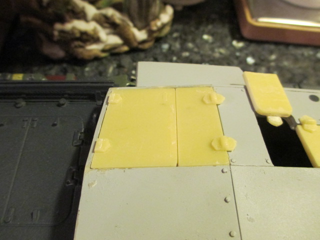

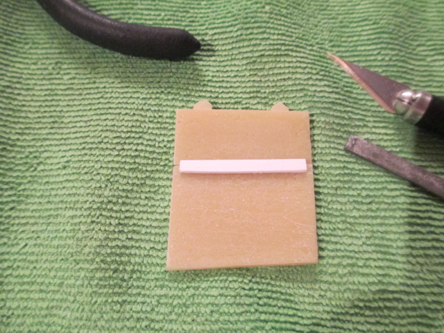

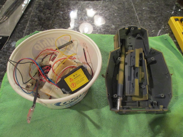

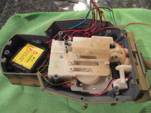

Alpha, It will be in the mail on Thursday. Last night saw serious work on the casemate get underway. I redid the hatch brace on the Commander's hatch and _carefully_ removed the recoil and flash mechanism from the PzIII turret. I will need to do some scratch thinking to get the components remounted in the resin casemate but it looks like everything will fit. One extra task that popped up is to get the metal main gun barrel drilled out a bit to accept the flash unit from the original metal barrel. I have a friend with a drill press and should see that work done this coming weekend. Pics:

A much better fit.
A much better fit.
A much better fit..JPG (84.58 KiB) Viewed 3370 times
New hatch brace from styrene.  The brass piece was too thin and fragile.
All removed and working, even the warning light.  I thought that those only came on the Airsoft versions
