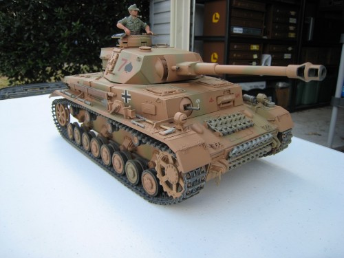

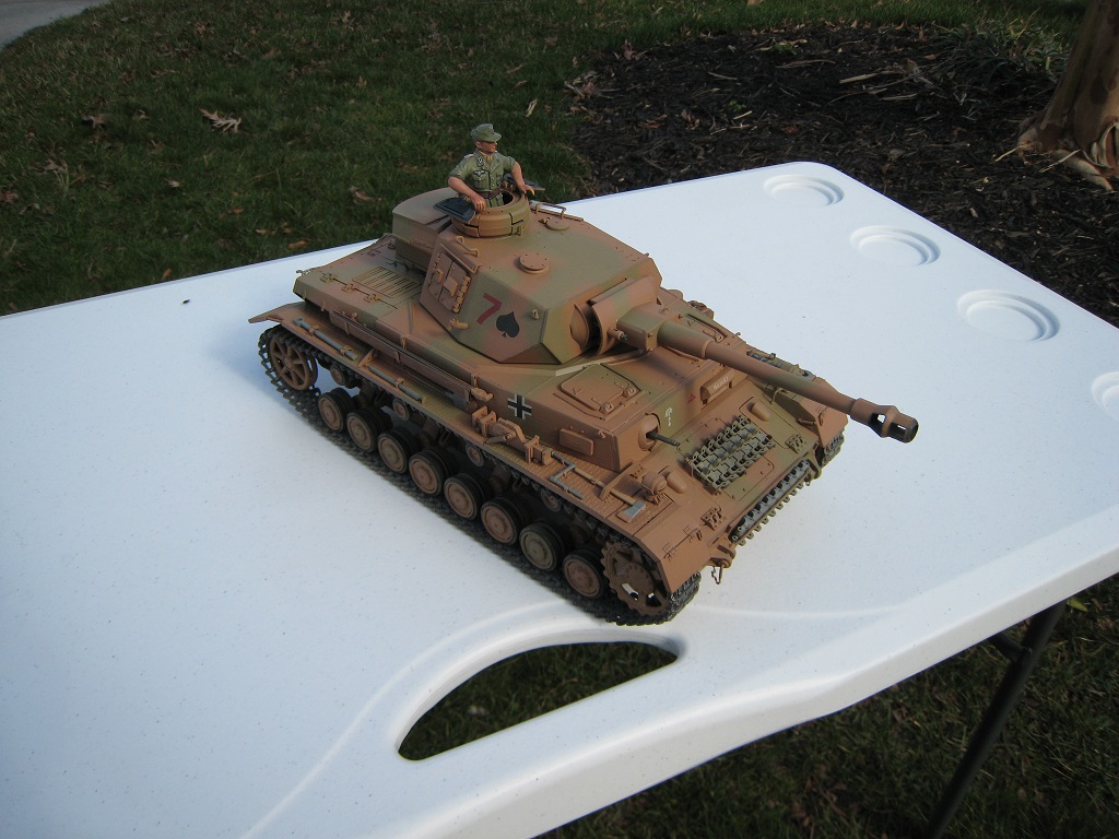

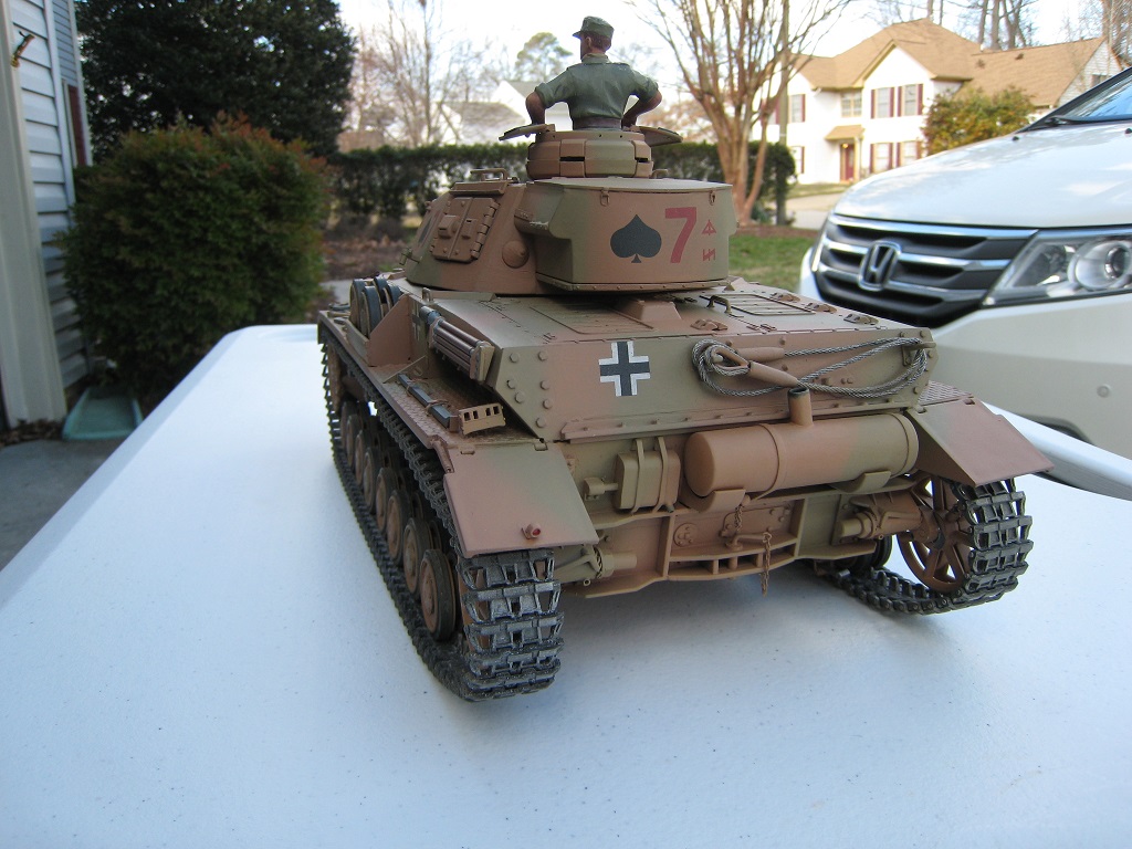

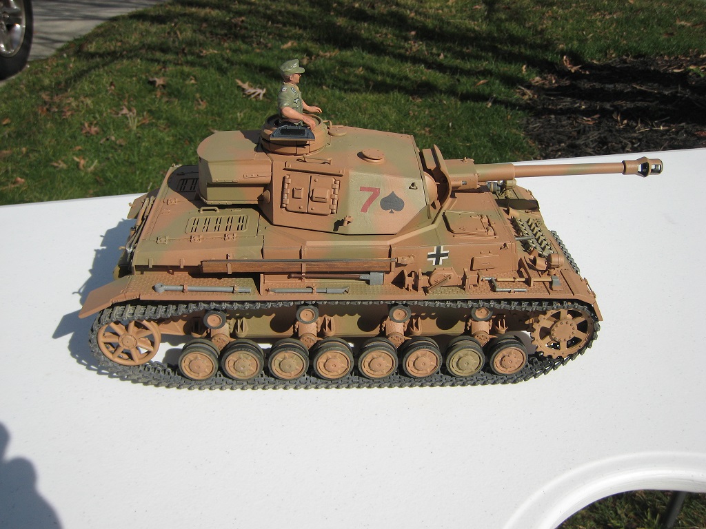

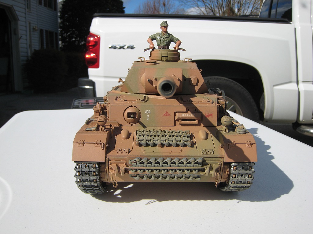

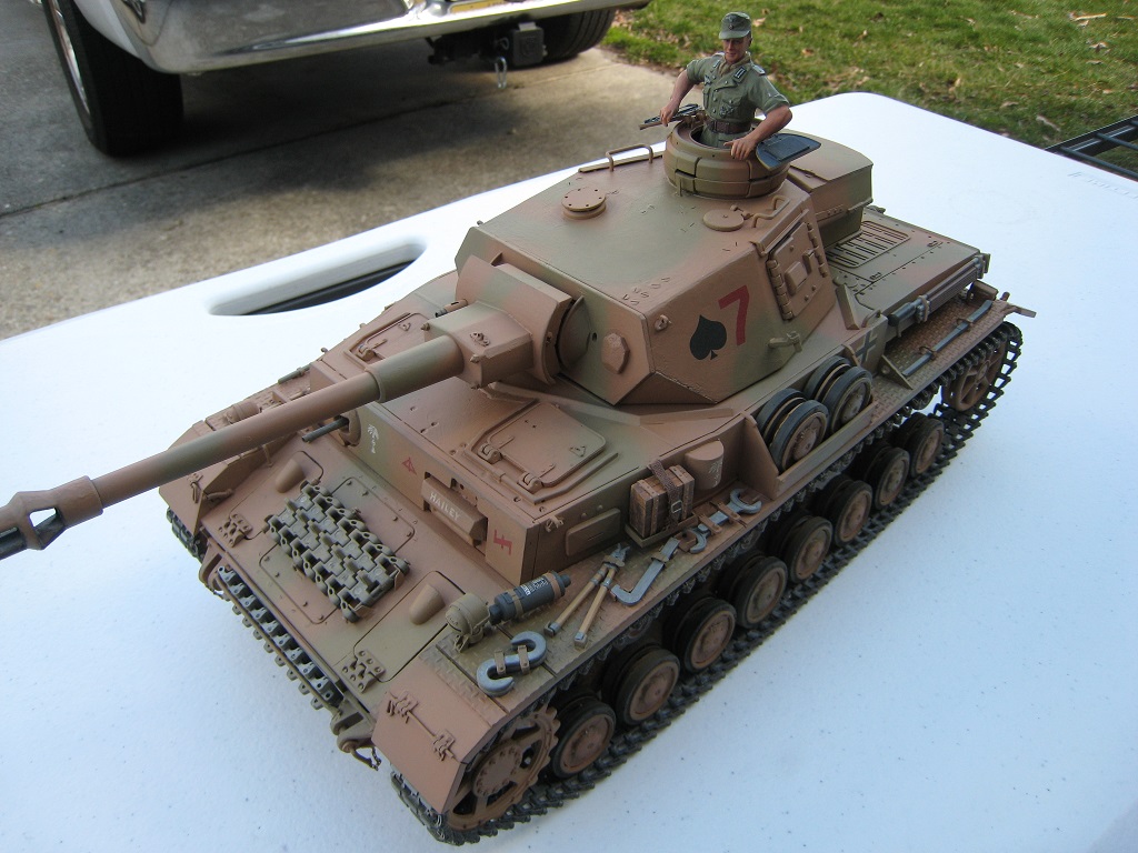

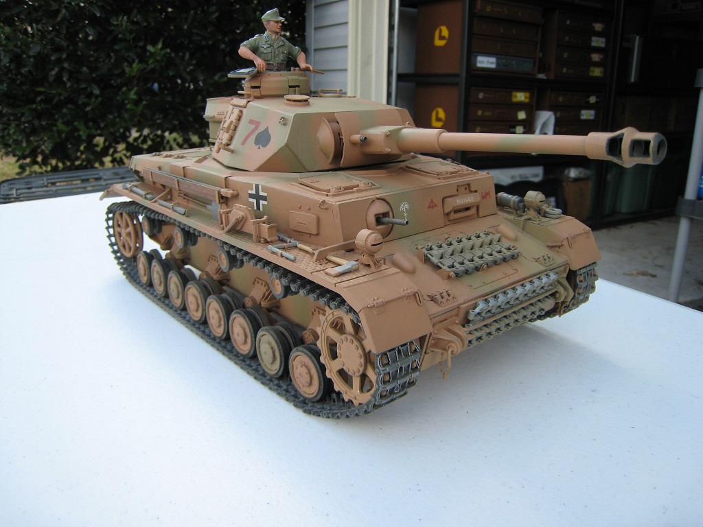

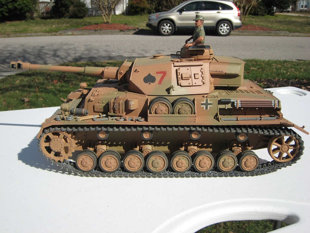

I think I’ve finished. I don’t know about the whole chalk-dusting-thing. I’ve given the entire tank a very light dusting using Tamiya’s Desert Yellow (XF-59). Basically, I used a mixture of 2:1:1 (Tamiya acrylic solvent : rubbing alcohol : paint) and then airbrushed it from about 12" away from the tank. It kept the overall color of the tank, but softened the color and the sharper contrasts of the pristine tools, rubber tires, machine gun barrels and markings.
I think it looks pretty good. I’m tempted to just leave it as it is. You can see the difference the dusting makes when you compare the pictures of the last post to the ones in this post.
In mid-afternoon sun:
In mid-afternoon cloud in front of the sun:
Mid-afternoon shade:
Hope y’all like it.

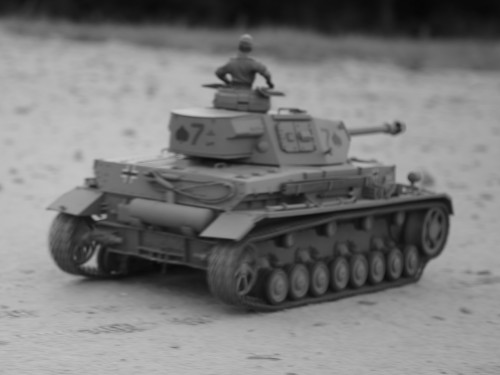

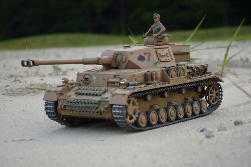

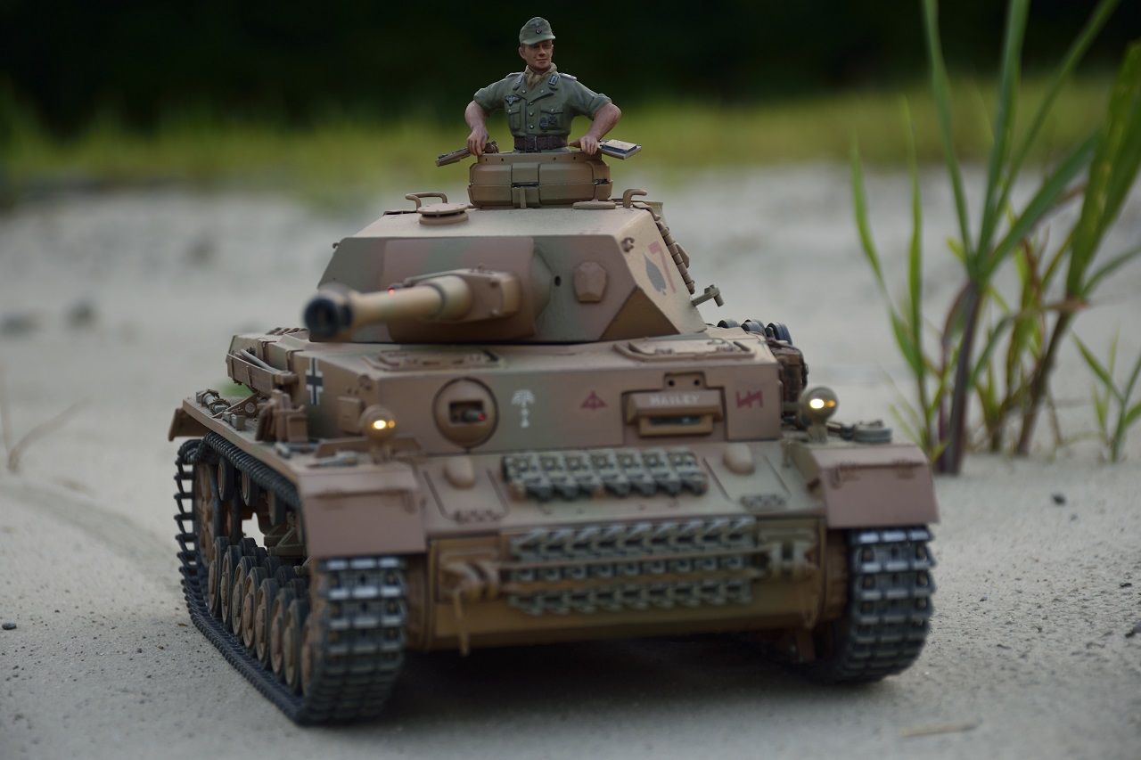

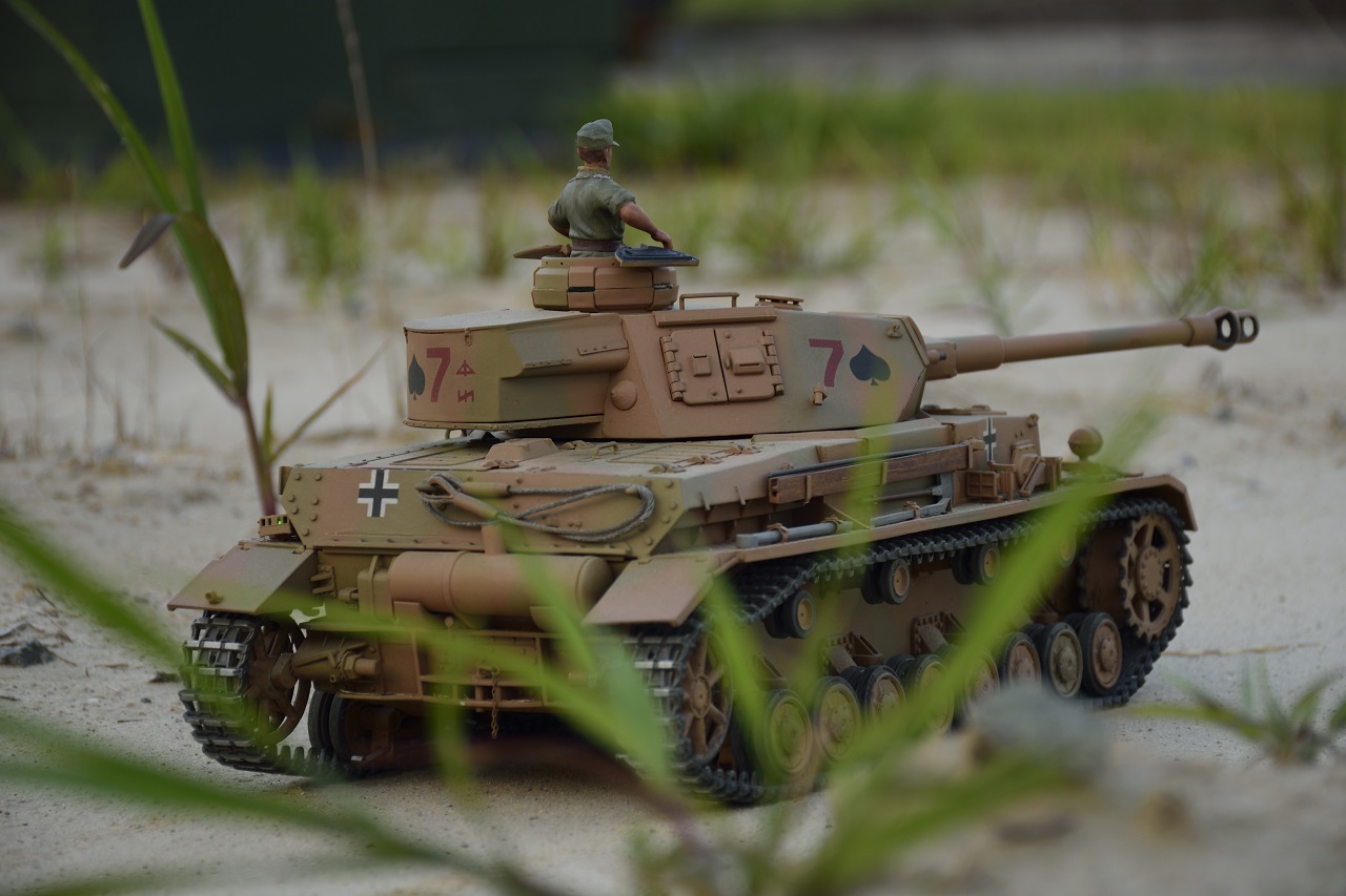

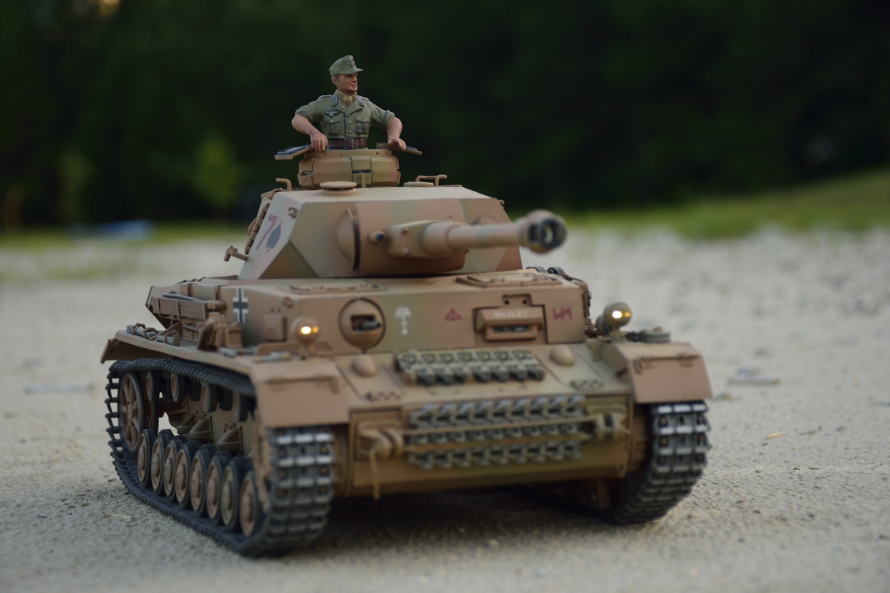

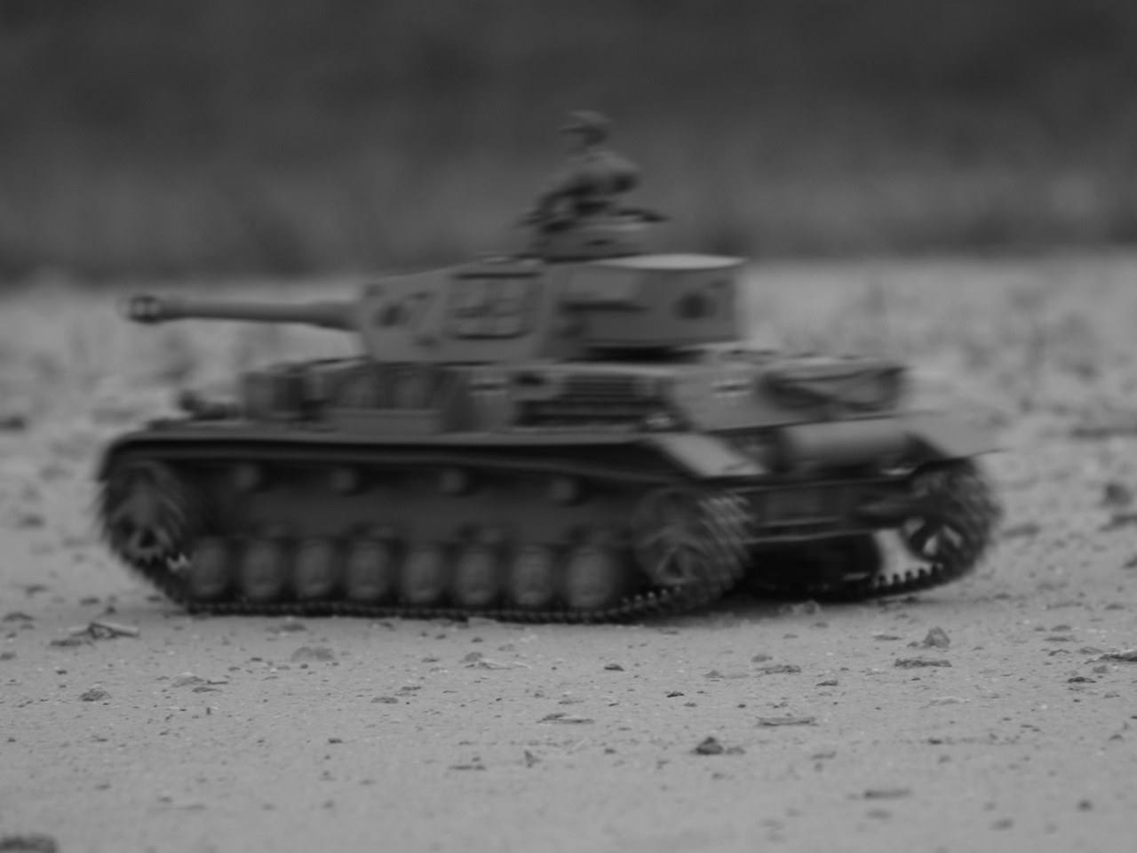

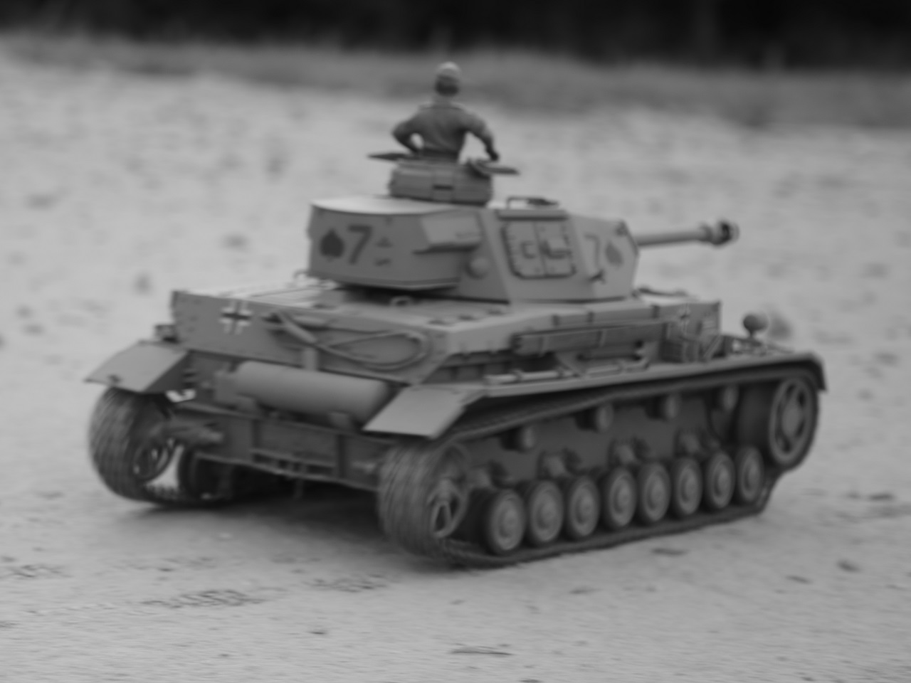

She runs well. But, the imitation leaf spring suspension makes it very susceptible when driving on rough terrain, especially if you try to back up. The metal leaf gets caught up and then bends. So, I try to keep it only going forward in the lawn. I use reverse on solid, smooth surfaces, or reasonably close to that.

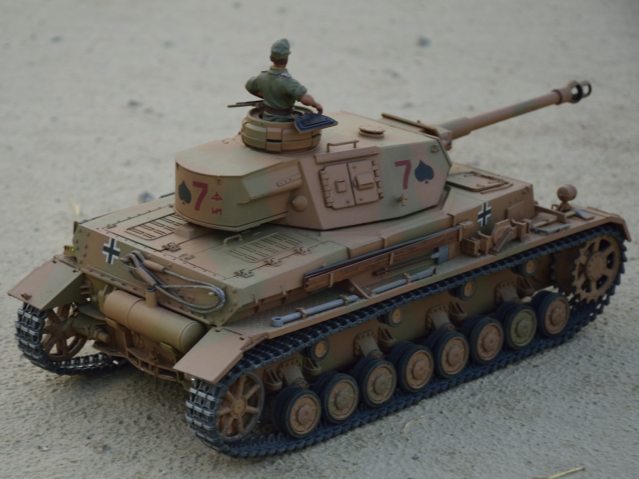

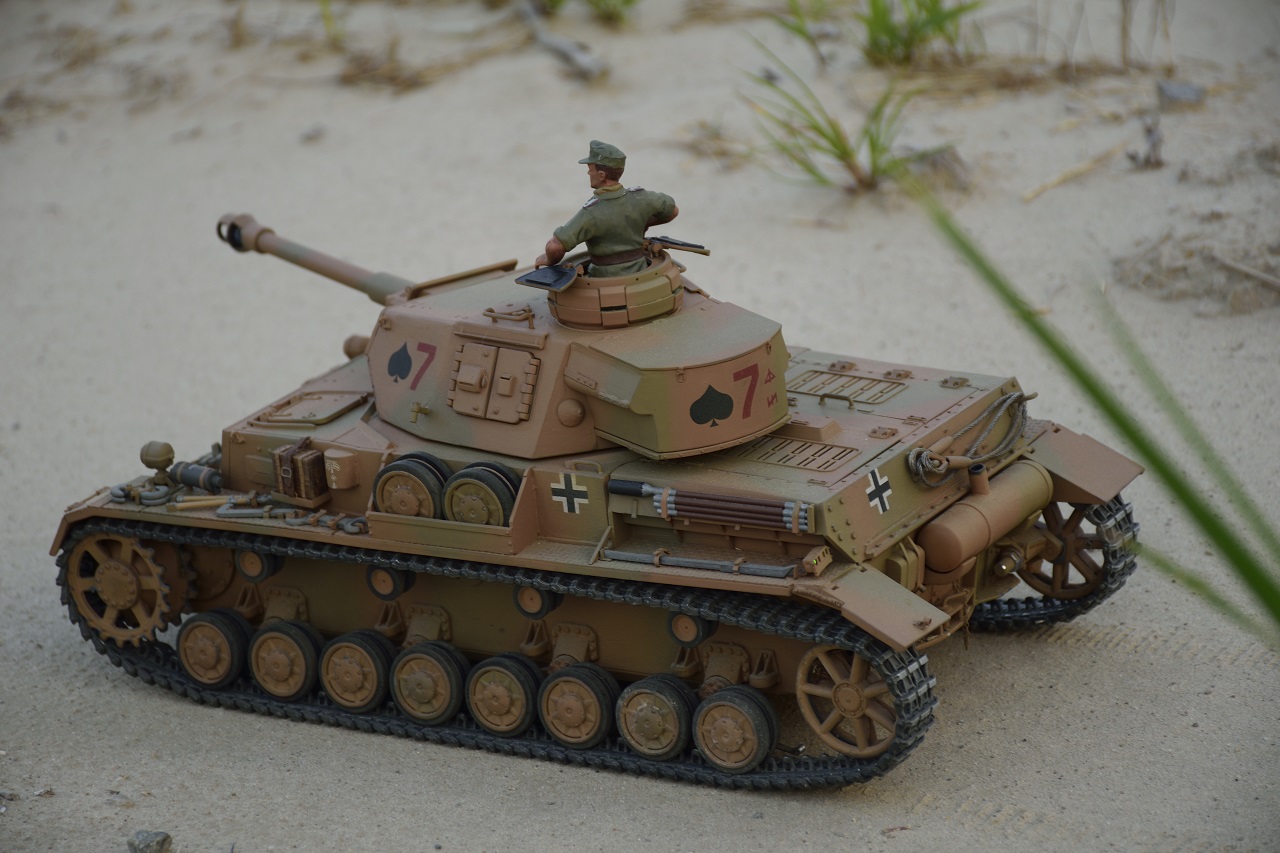

And...I finally got some photos in the field. 8)
philipat
Posts: 530
Re: DAK Pz IV Ausf G Build
Post by philipat »
Period photos?
Maybe...
