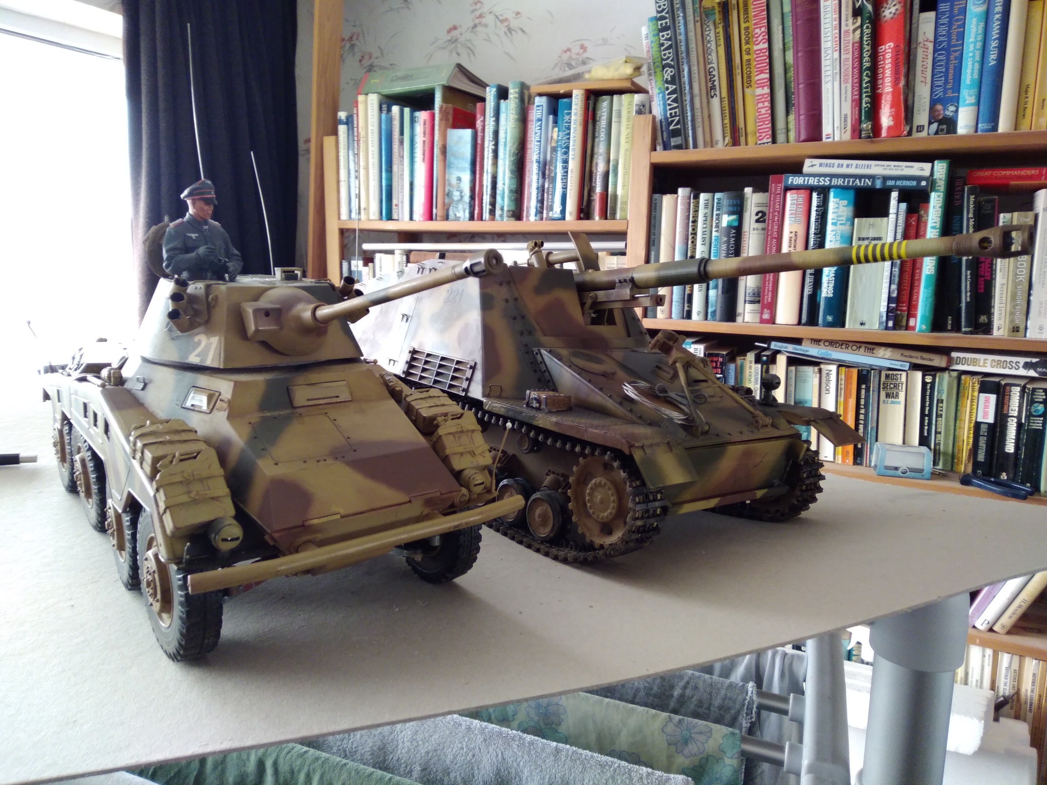

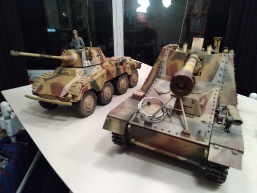

For Herman as promised. If you would like a different pose, just say.HERMAN BIX wrote:Oh God I love it![]()
Could you do a heat-stressed Antipodean a favour ?
Put the Puma next to it for a group photo ?..........pleeeeese
SdKfz 164 Nashorn by Alwyn Turner

Very smart.
Two very rare afvs right there.

Yes I'm very surprised to see the size of the puma. Both fantastic models
Tanks alot....

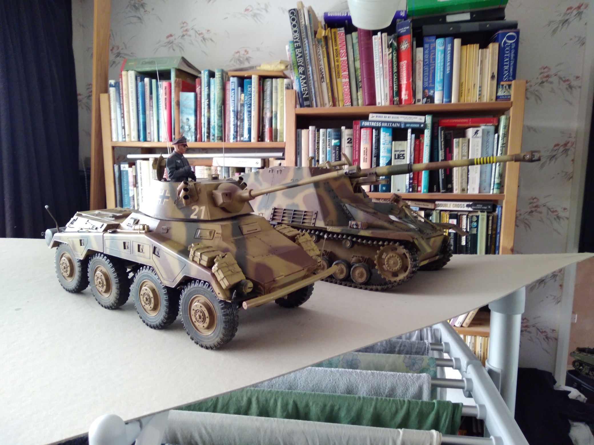

I think my phone camera may have exaggerated the perspective. I took this from a different angle and the Puma looks a lot smaller, I think.
Richard
