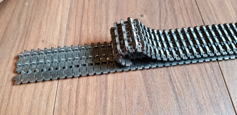

Hi all, only been a year but I am back. How time flies when work gets in the way of your hobby.
I am thinking of toning down the tracks ( see page 7 of thread ). Any suggestions on a real world Tiger track colour?

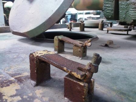

Looking at reference pictures and at the Aber and Voyager etch I have, the etch looks very thin for the brackets so it looks like I will have to use the etch for dimensions and scratch build from plastic sheet!!! ARSE!
I am not sure on the thickness of the top bar of the bracket, but I imagine its in the region of 12mm, so that would suggest styrene sheet thickness of 0.75mm. Anyone agree?
Tracks have been repainted and sanded on the guide horns for wear. They will be weathered but as this is a Snow Tiger there will be masses of snow crammed inbetween the treads. I am thinking of using micro balloos for the snow. Anyone used them?

Re: ABE'S EARLY TIGER 1 BUILD
Tracks and real brackets
Hi Y'all
Is there any reference for the dimensions of the tool and cable brackets/clamps? I have mooched the net but found not a sausage.
And considering I am the Sausage King of Chicago....thats really annoying!
