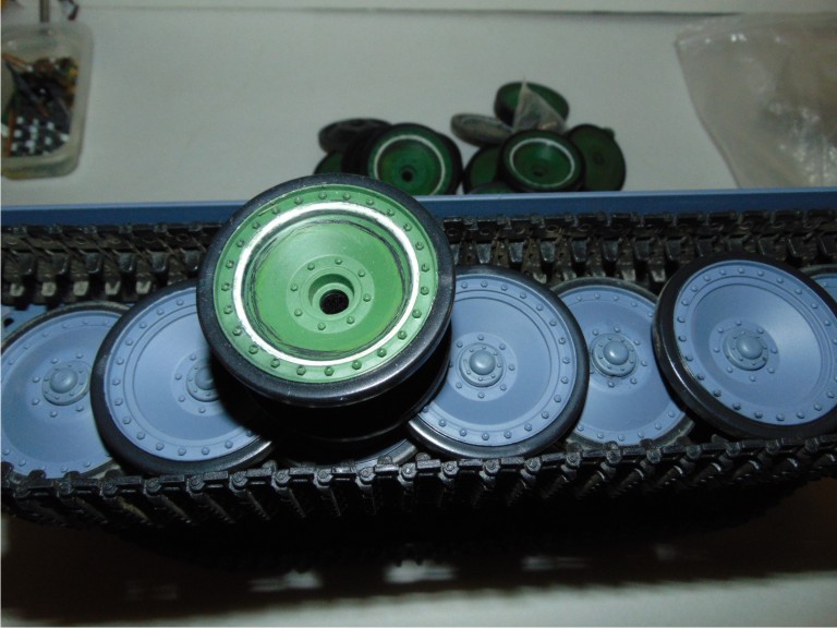

That triggered my memory, yes, what I did was cut the 2 posts out of the HL mantlet and remounted them inside the new one and then filled it with 2 part epoxy to hold in place. So back to the present. I had not looked at my wheels in a couple of years and forgot I did get rid of that annoying ridge on the rims. They look far more accurate without them.

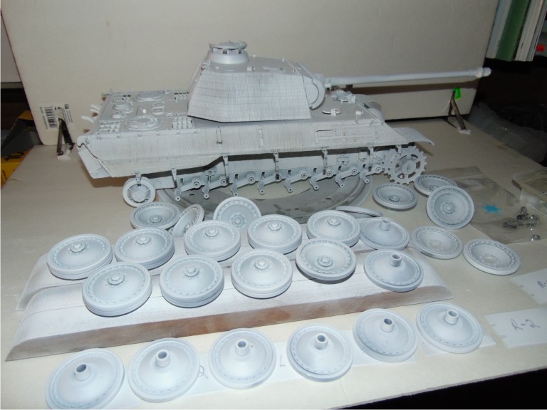

WE NOW HAVE PRIMER!!! On little secret for new guys using Tamiya primer. The fine white is about the best overall primer I have used in 45 years of modeling. BUT, do NOT be in a hurry to add paint after using it. The lacquer needs at least a couple of days to set up. I leave mine for a full week if it is humid like it is now! you will find you use less paint to cover and it sticks better...
Next up base dark yellow or Dunkelgelb

Thanks for the advice on the primer. I tend to get lazy and use cans for priming as well instead of firing up the airbrush. Also the coats tend to be more even this way. :thumbup: Yes, tell us about your camo ???
Your wheel mod is a fantastic idea and the first time I see this.

So, that's not rattle-can primer? In the pictures it looked like the Tamiya light grey primer that comes in small cans. How well does that stuff stick to the brass and other metal attachments?
I didn't have much luck with the Tamiya grey (rattle can) primer on my PzIII. So, I used an automotive primer on my PzIV, which seems to adhere to the brass and pot metal better.
Wheels look awesome!

It is actually the white small can Tamiya primer. Just looks greyish because it is covering dark surface. It doesn't need to be a thick coat. Metal it is pretty good. The trick is to get all the oils off everything. I use rubbing alcohol and an old paint brush. Again it really does need time to set up before paint. I have used auto primer and a couple of others too but find they are to heavy for any detail work I do.
