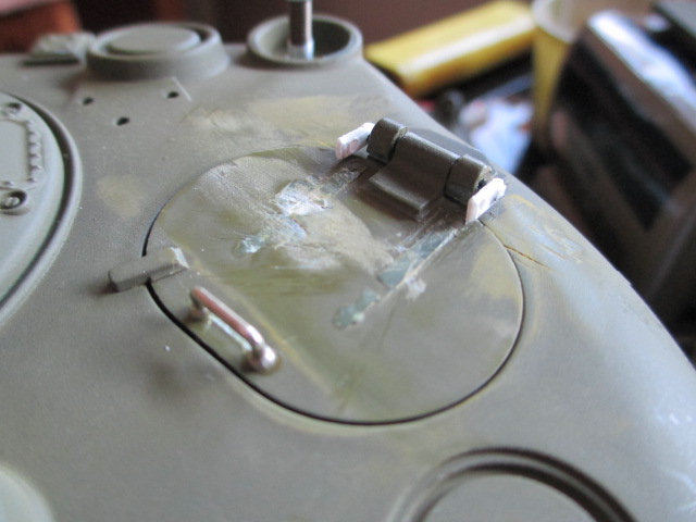

I cleaned up the tabs a little more with fine grit sand paper so they look better. cleaned up the hatch as well. It has to look like something after I paint it. *chuckles* I will do the cast surfacer too. That's a nifty product and makes the Sherman turret and transmission cover pop. Easy to brush on. Phil used it in his build and I was really impressed. This is a 1944 M4A3 so I will look at what came ashore on D-Day just to see. Panther, Yes, I got looked at early on and took some severe meds so my Pneumonia is 90% better than last Friday. I can see being fully recovered in another week.

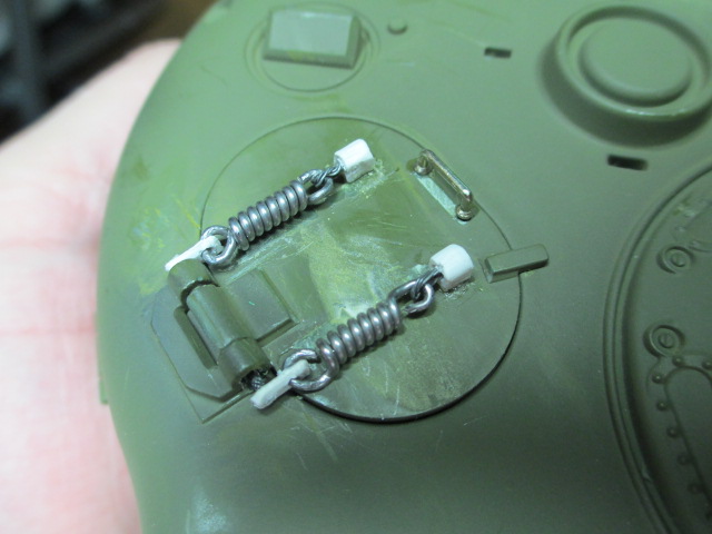

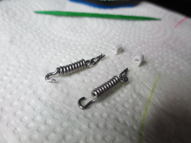

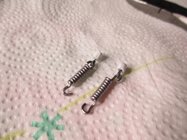

35th Day: Thank you for the vote of confidence, Alpha. I'm in no rush. This sort of 'fun' is best enjoyed when in good physical health. ;o) Springs are finally mounted on the Loader's hatch. I used some white pvc blocking for the hatch mounts. Rounded off the tops using a fine file. Drilled out the center hole with a #61 and used some picture wire for the loop holding the spring in place. The springs are made out of solder, stiff when wound that small yet flexible on the connecting loops. If I want to get really finicky about the finish, I'll add a couple of tiny nuts on the reverse side of the block from the loops. Pictures:

Assembled pieces were too long on the hatch so I removed two winds apiece

Spring components

PainlessWolf wrote:35th Day: Thank you for the vote of confidence, Alpha. I'm in no rush. This sort of 'fun' is best enjoyed when in good physical health. ;o) Springs are finally mounted on the Loader's hatch. I used some white pvc blocking for the hatch mounts. Rounded off the tops using a fine file. Drilled out the center hole with a #61 and used some picture wire for the loop holding the spring in place. The springs are made out of solder, stiff when wound that small yet flexible on the connecting loops. If I want to get really finicky about the finish, I'll add a couple of tiny nuts on the reverse side of the block from the loops. Pictures:
I tend to agree Painless... there is just something about making your own detail parts...there's a different feeling of satisfaction once you finish and install them...than buying them and putting them in place
nice job on those springs...it is how I imagined they'd look...better in fact
Take care my friend ...go easy :thumbup:
