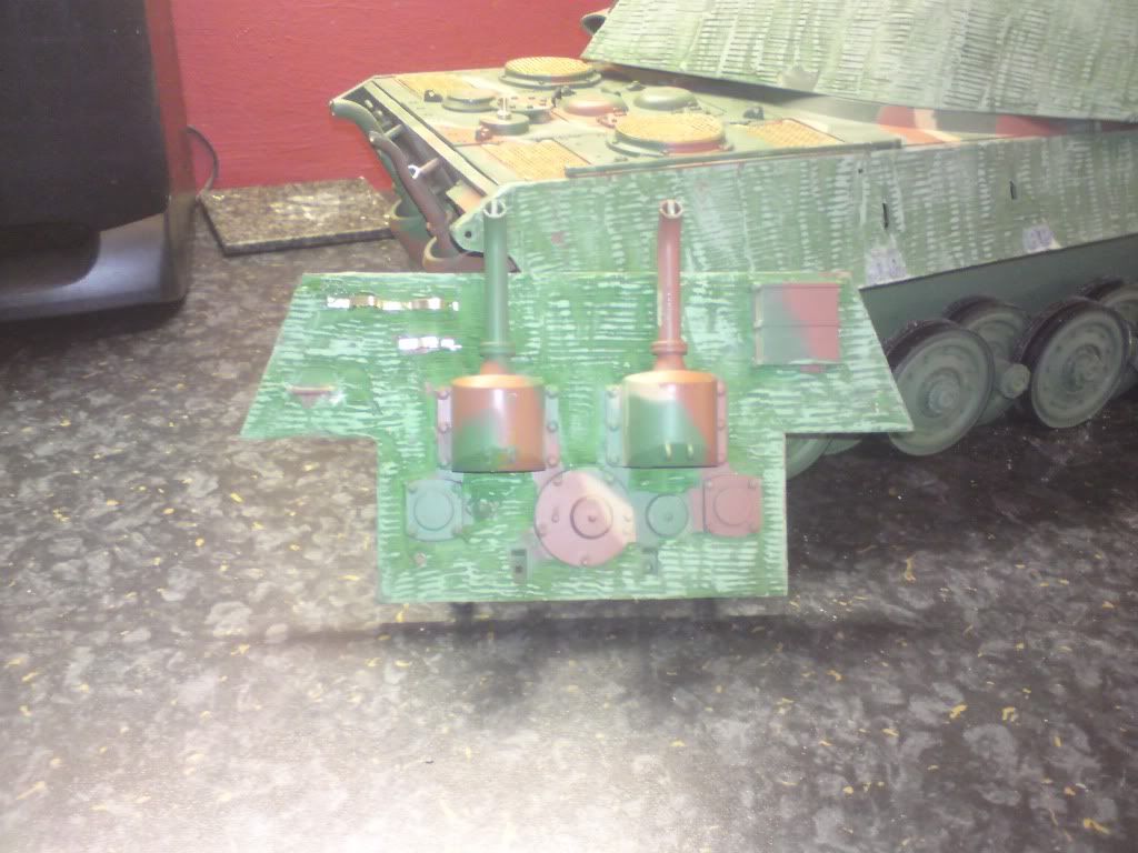

just working on the rear panel now just a few things i want changed ie no mudflap holes removing the shackles and some detailing to the exhaust

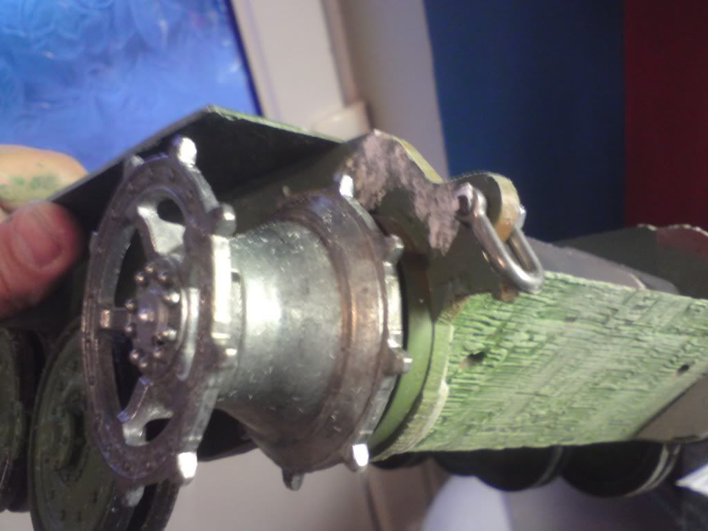

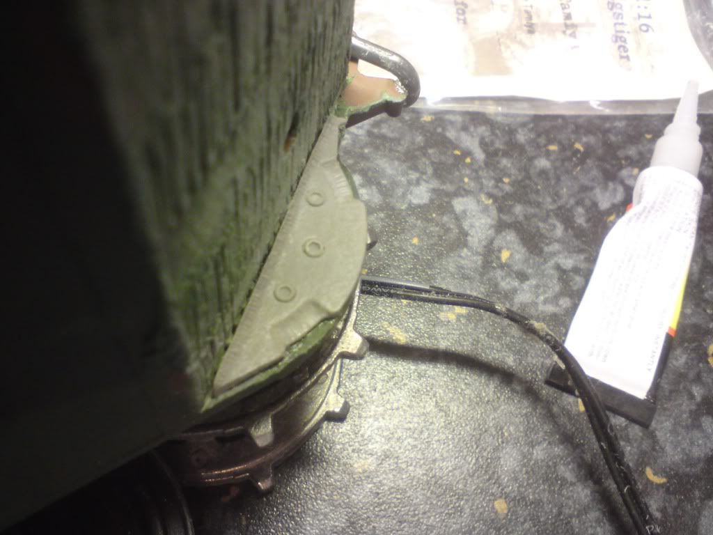

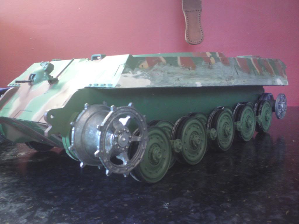

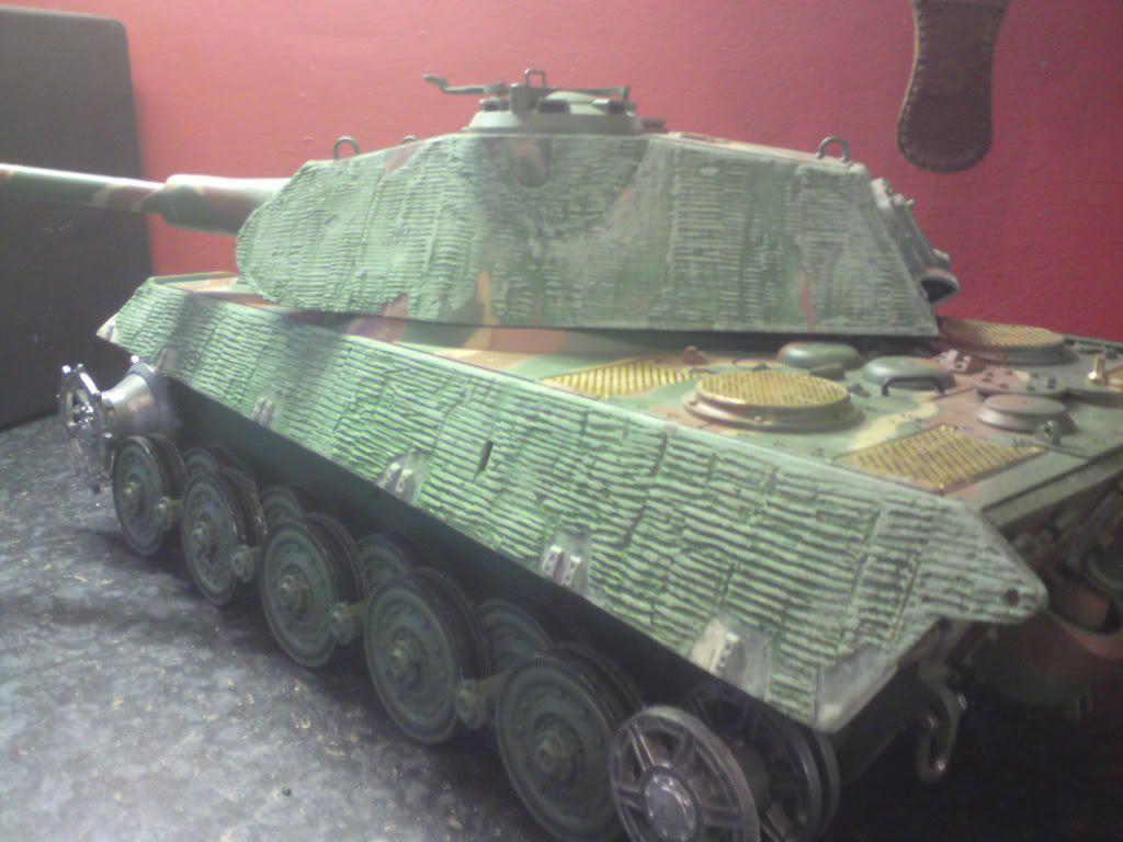

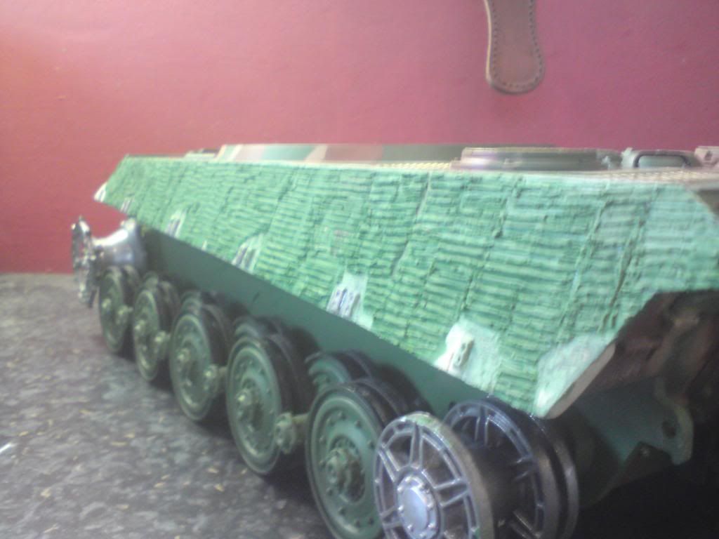

ok after finishing the sides so they are flush and straight as i said had to fill in some minor gaps with milliputtImage

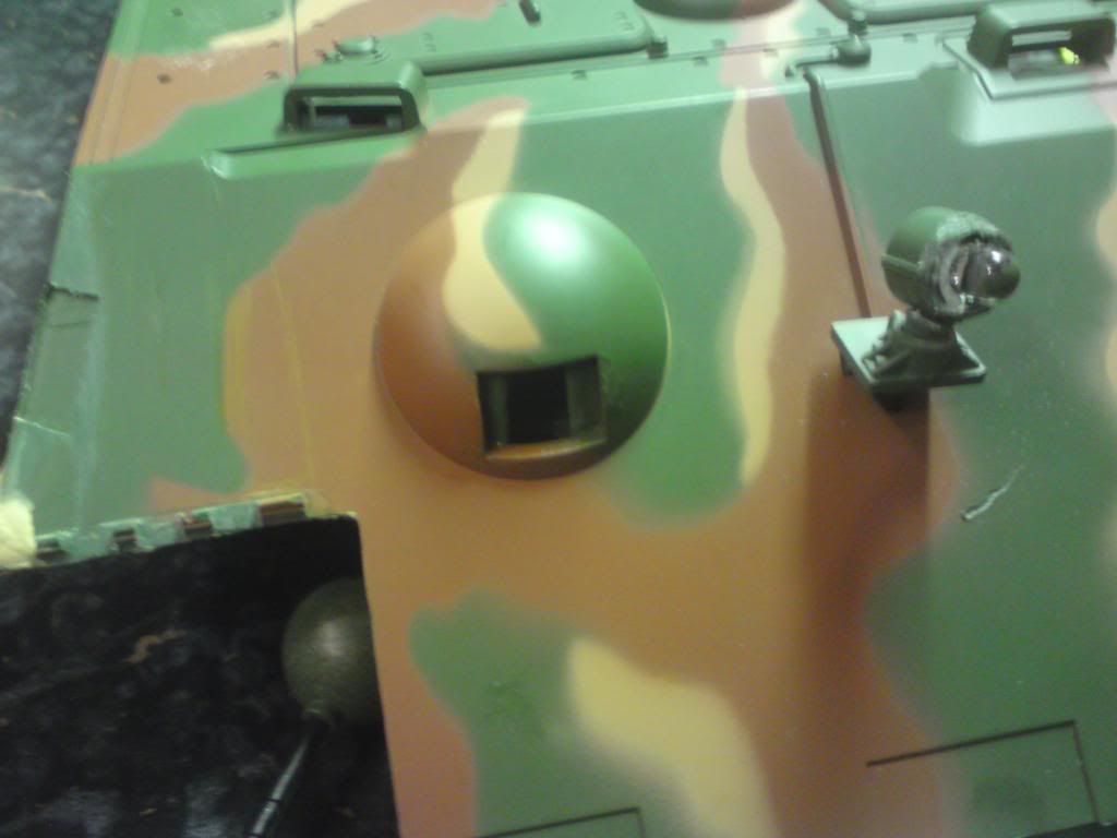

Imagealso a small mod to the inner gun port

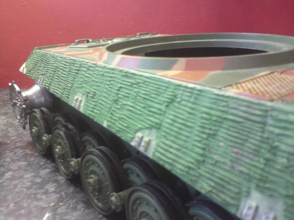

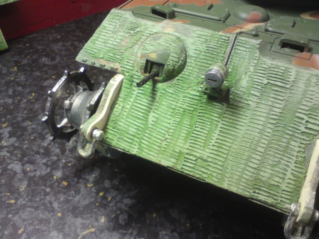

after that it was the zimmerit MC recommended green putty he was right it done the trick never done this before came out ok needs to be sanded slightly but the trick was to just do it slowly also added the armoure hanger brackets one side took me around 65mins just had to get the hang of it
with a bit of luck i will have time to do the whole hull on sunday if my kids give me a break lol :'(

oh! and a big thanks to MC for the info on the zimmerit :thumbup: :thumbup:

Your welcome......If you want the seperations between the lines, try this........
drag the hacksaw about 5mm side ways, then without lifting the blade ,slide the blade up and down...and then drag it another 5mm....this will give you the Differance in the "rows" created with the hand width trowl.

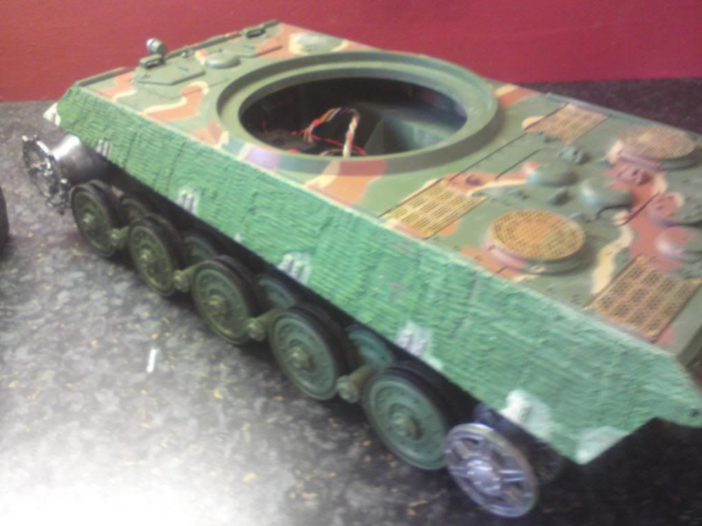

ok more detail done all zimmerit complete ...thanks god MC was right about having patients ...now has metal shackles ,more rear panel detail transmission detail that heng long dont have is on ,also want to mod the drivers viewing port like the mattorro model it looks better .even scored the bulk heads to look like a blow torch cutter been through them.. pictures will follow .my aim is to have it as nice and detailed as a static but usable ..will be preping for its undercoat tomrrow will post pictures before i do this so the work can be seen....and after seeing MC having a few sets of tracks on the turret i decided this was a must for me

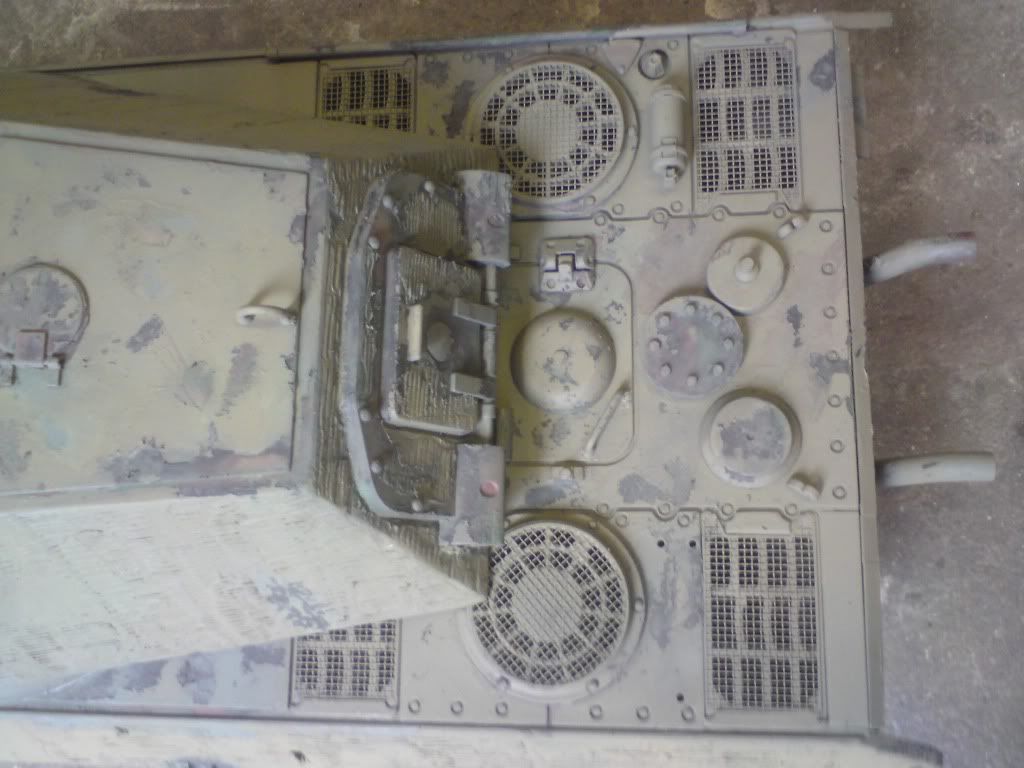

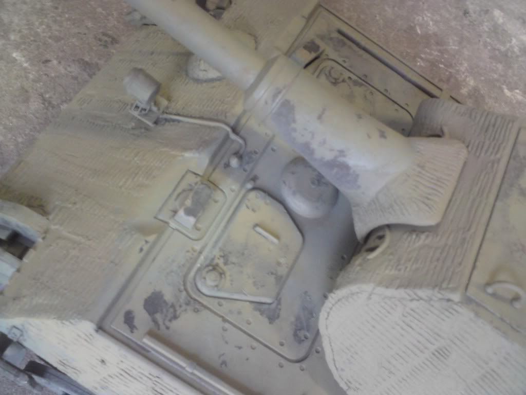

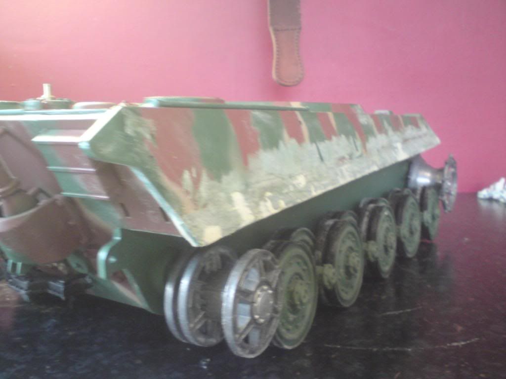

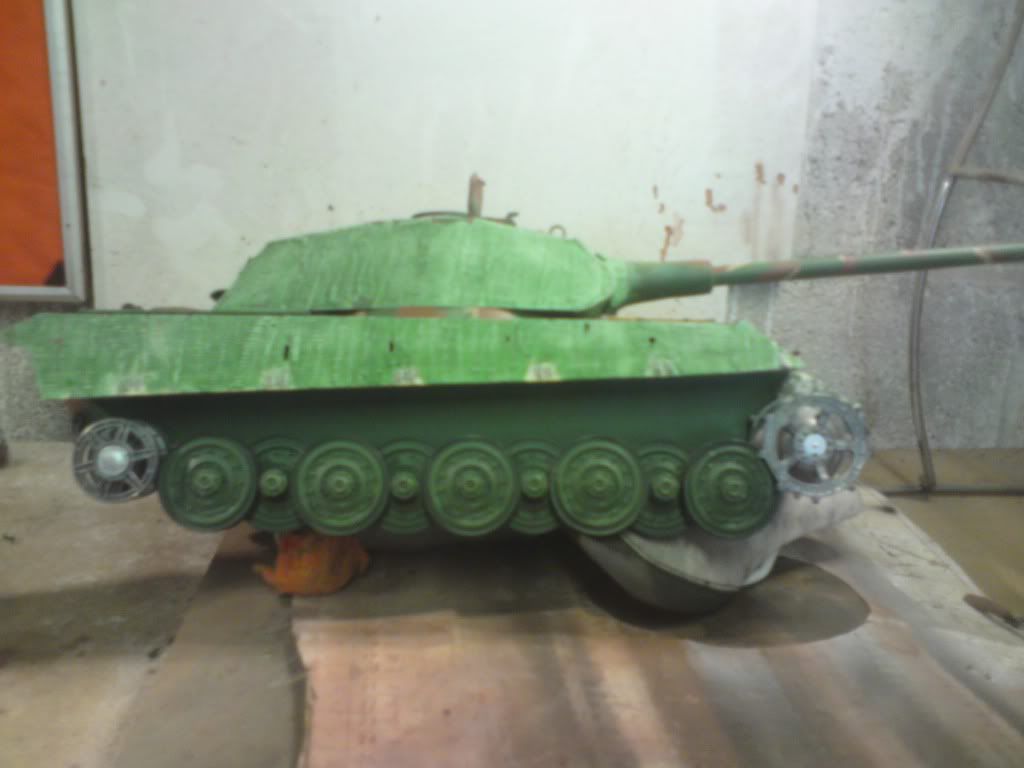

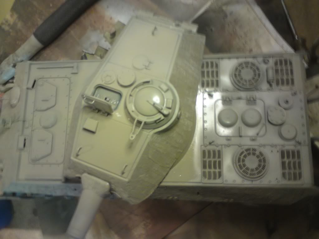

gutted today expected to be starting the base coat but it took far longer building up the front bulk heads but now is totally ready ..already chose my coloure scheme
added some filler for mud on the outside by the track
then buit up the area
her she is ready for paint

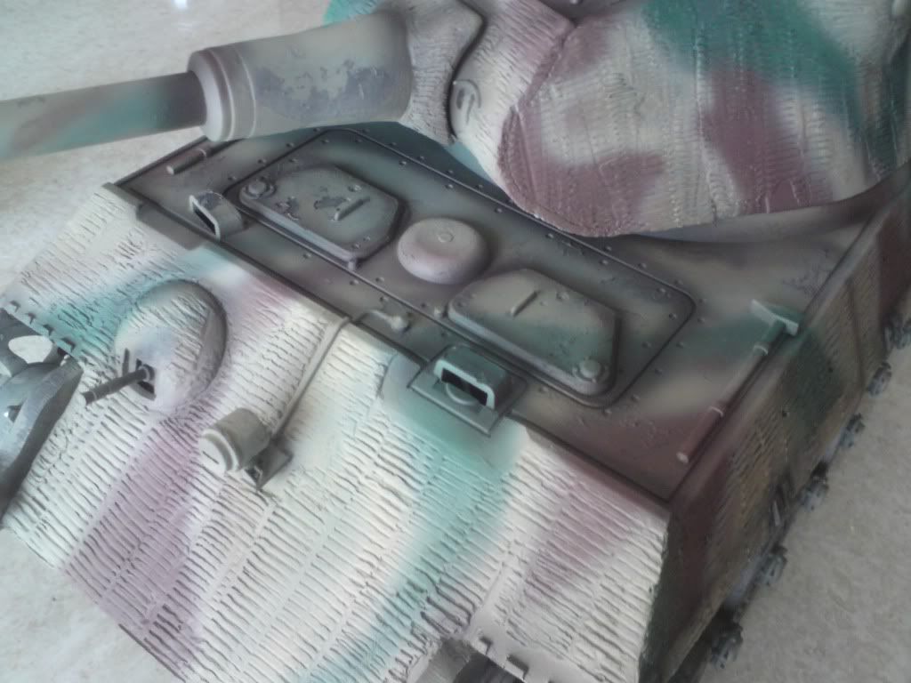

rear detail

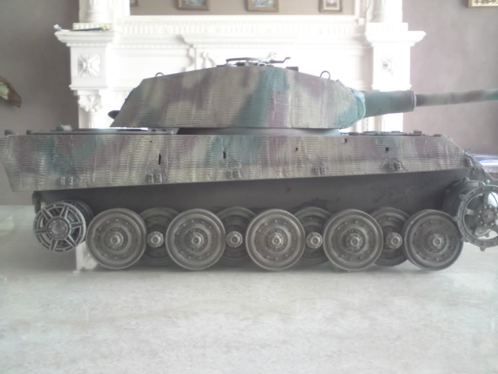

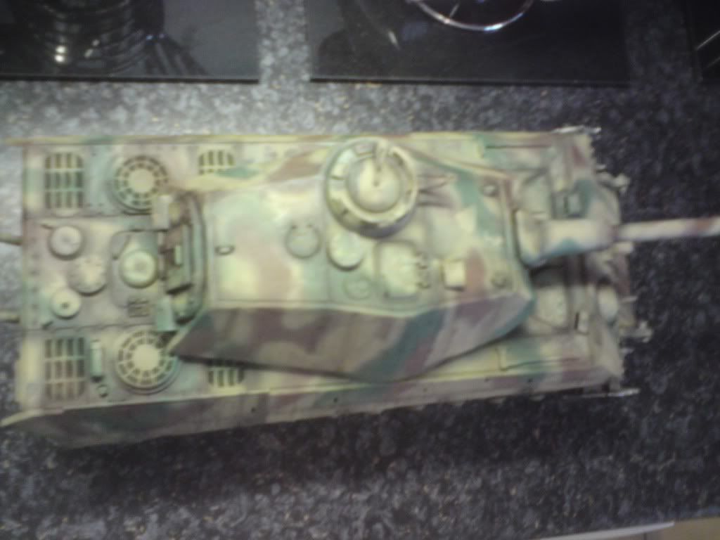

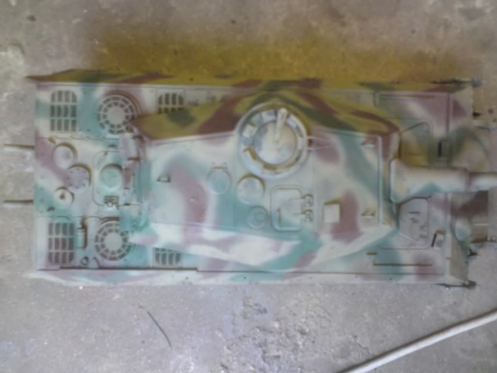

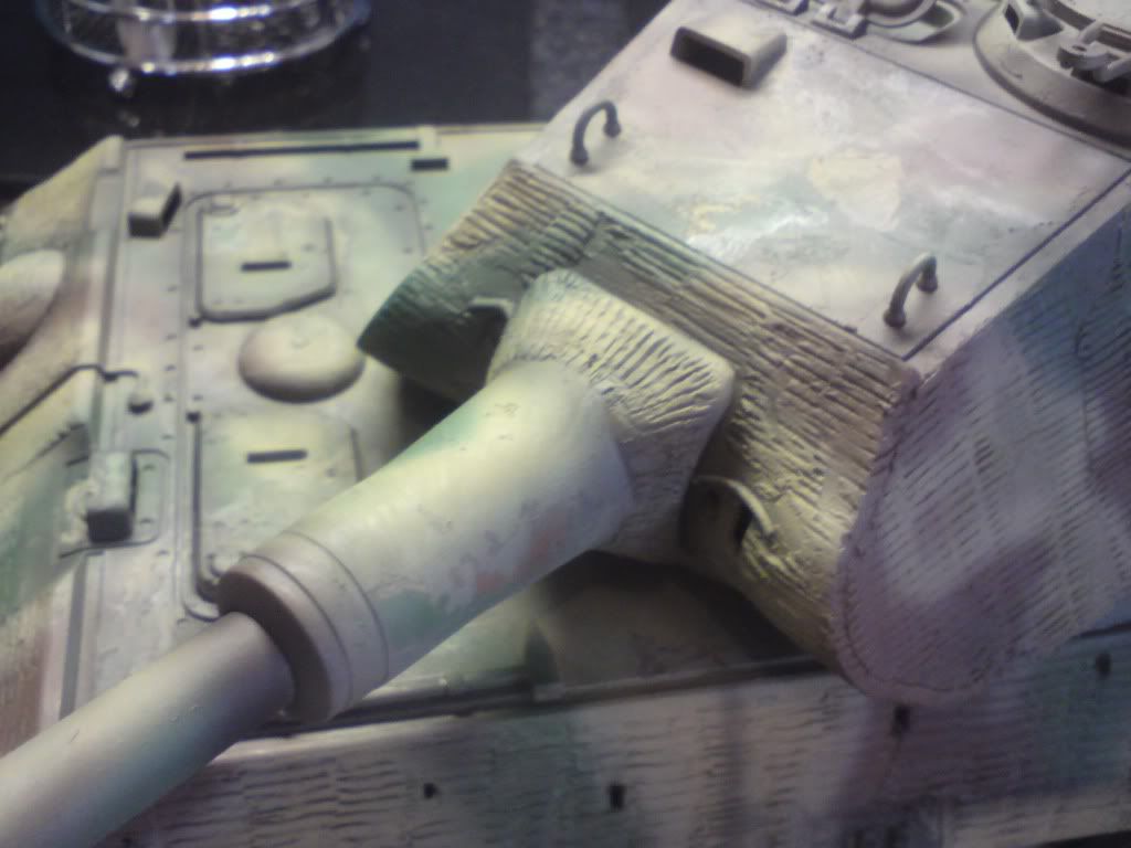

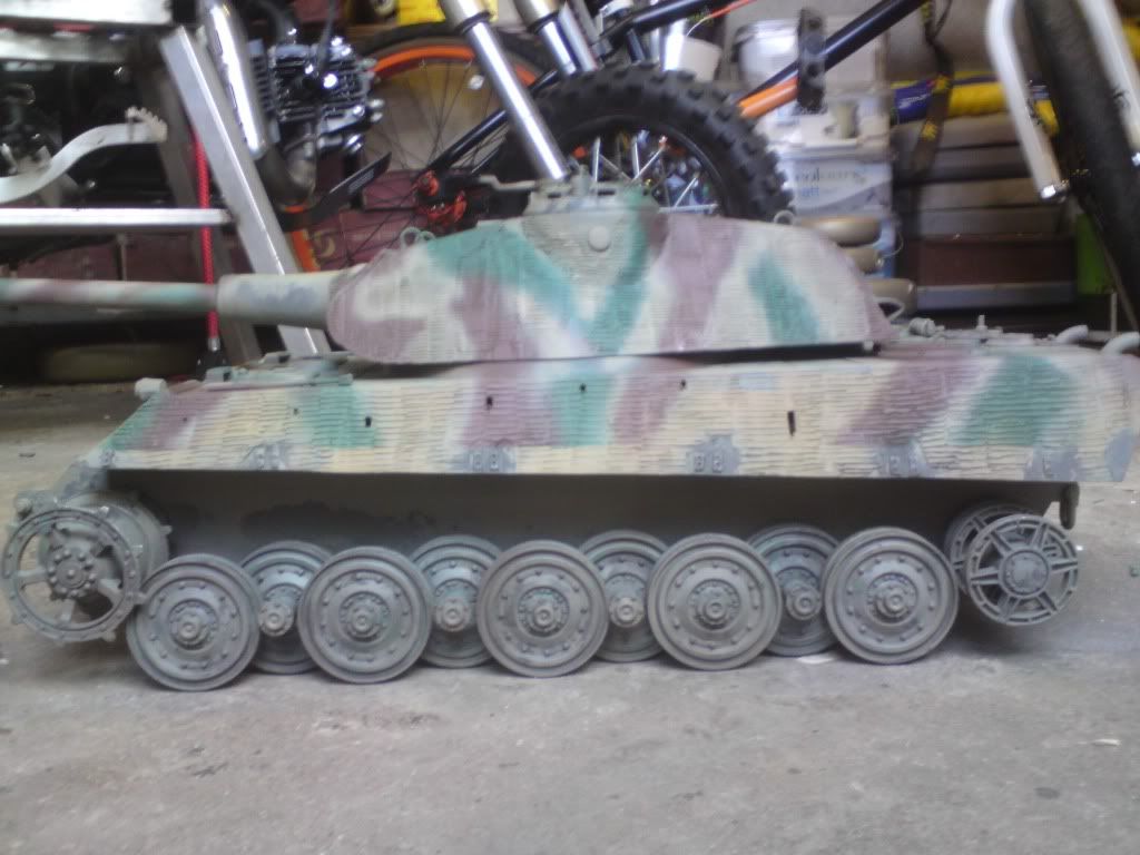

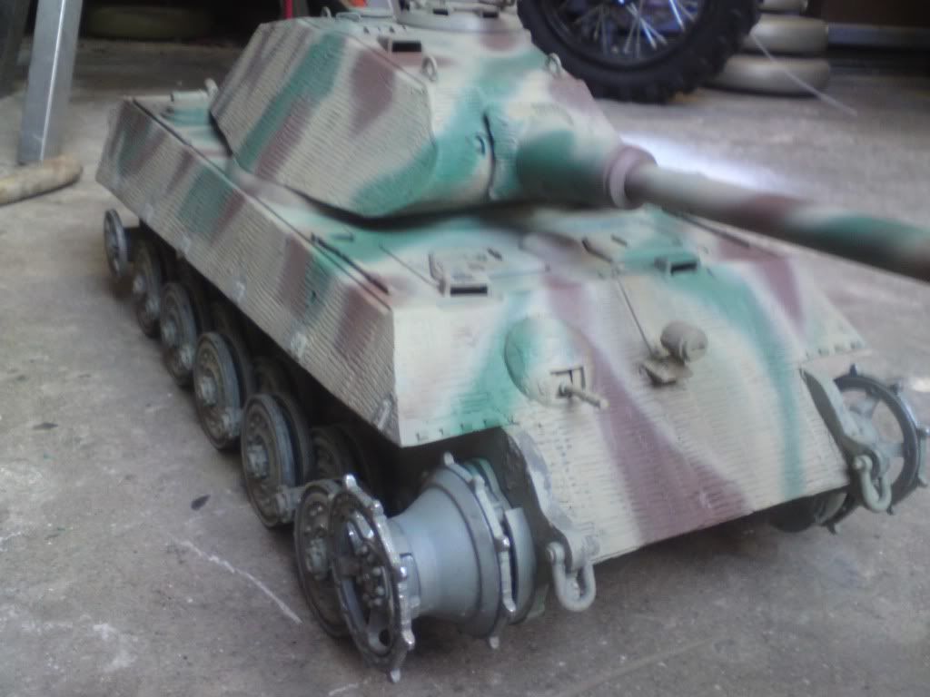

ok kids went to a party so i had time to paint the kt
first coat!
then my own patented ;) paint cipping and mottle effect
came out nice at thise stage i didnt want to camo the tank but :crazy:
then first camo stage
then came the highlighting and some detailing

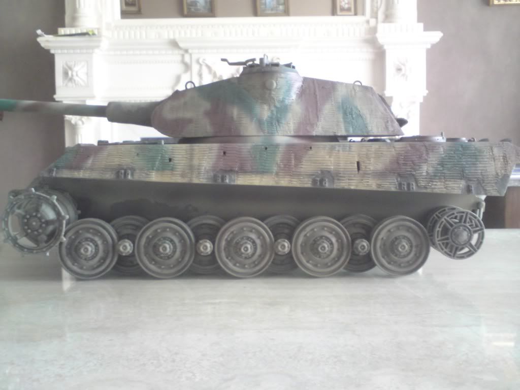

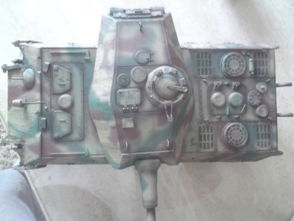

more detailing :D
now just hand painting the detail put the tracks on and a tiny bit off waethering oh!
