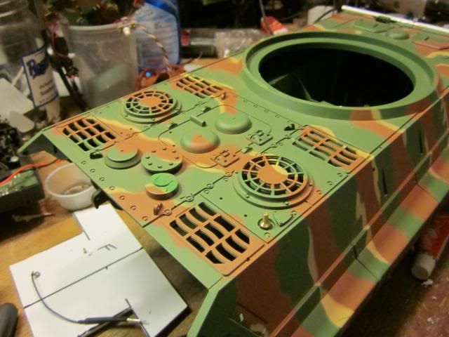

You say that but have you looked at the rear deck? The turret mounting rings? Here I might add that the hl kt has the best turret mounting setup that I have seen in a rc tank. There is zero turret bob with this tank. I have seen guys spend days getting the truuet mounting right...going this rout will save me a bunch of time.

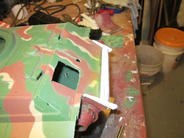

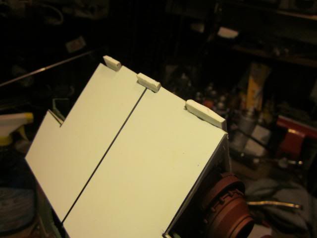

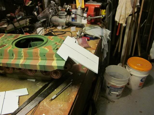

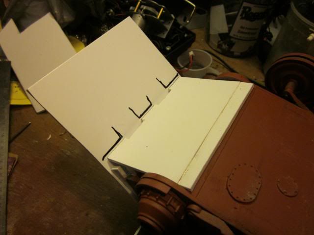

The thing that I am having trouble figuring out how to do is the front armor seam....I want the upper and lower armor plates fit togather like they were designed with the knotches and I want the fit to be tight enough so when the upper hull is in place, it does not look like a seam....

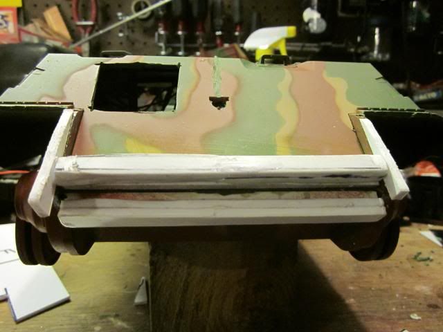

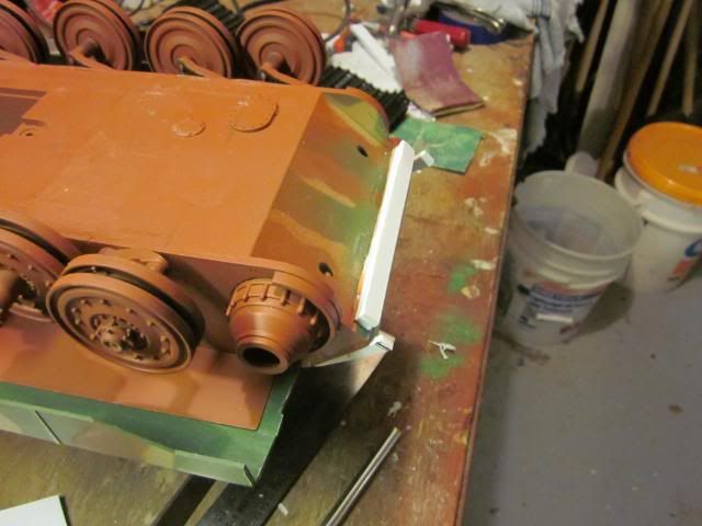

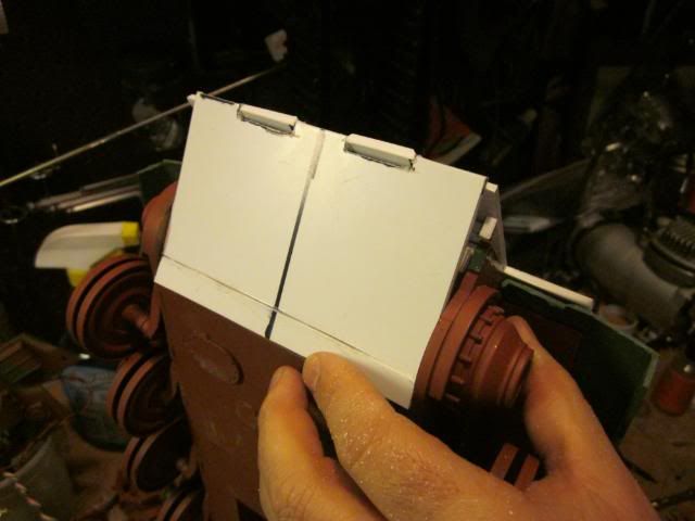

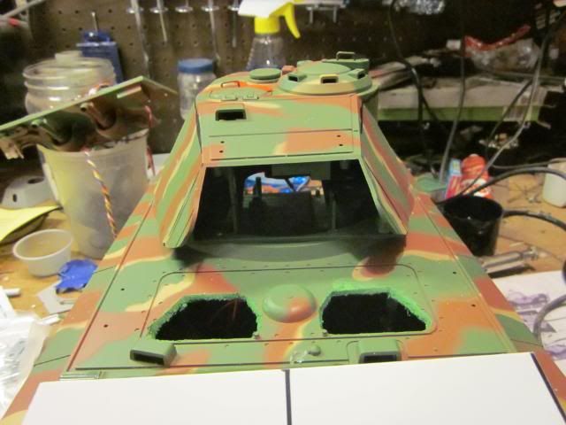

Well, got some more work done with the e50/kt .....first thing I did was get the side plates to the same angle as I wanted for the front upper plate......
then i put in the lower plate spacers....
next I temp glued the upper front plate to get the seperation point.....

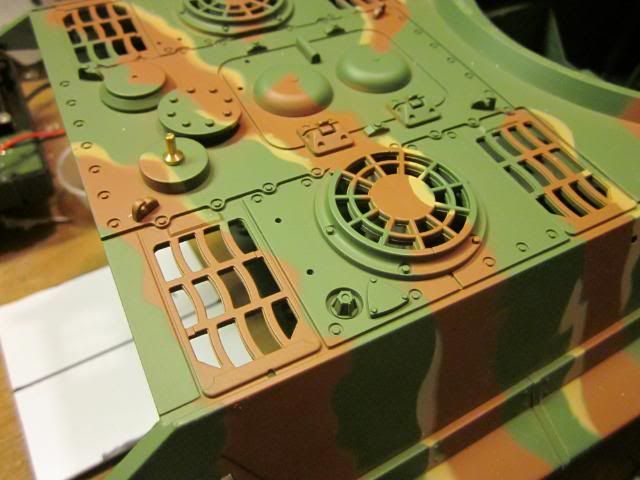

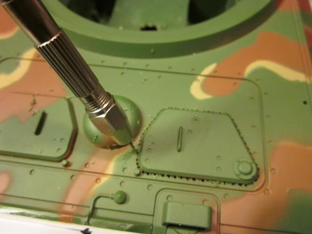

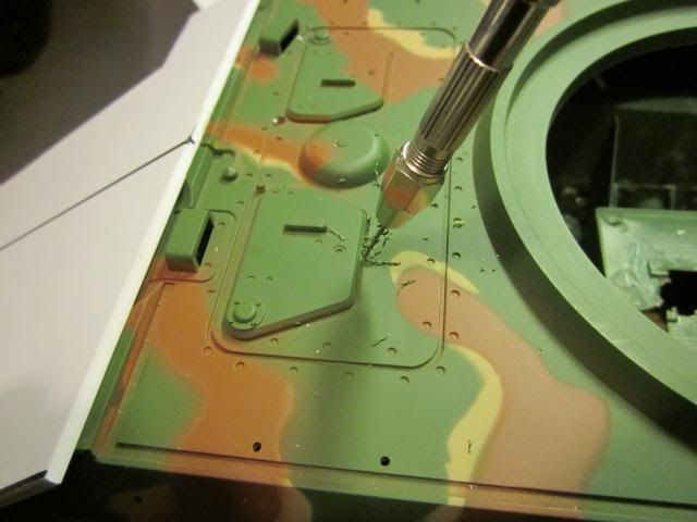

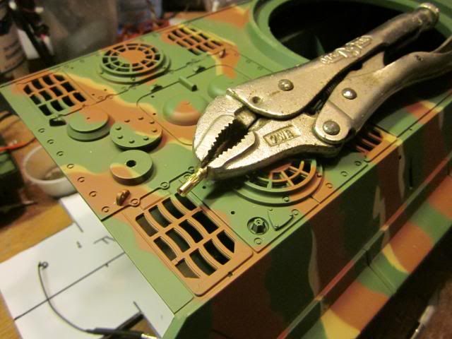

...then I got totaly distracted....I hate where hl mounts the antena....they even get the antena mount in the right place but they mount the antena on a motor access point???!!!....so i drilled the proper antena mounting point....
then I pulled out the antena mount fter unscrewing the mount wire...
A little glue, a little filler and boom....

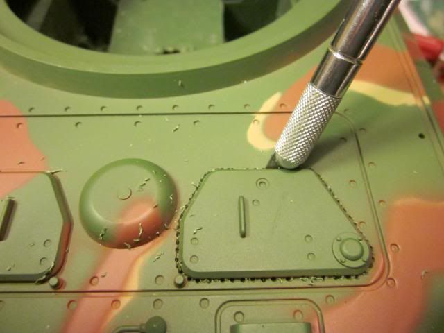

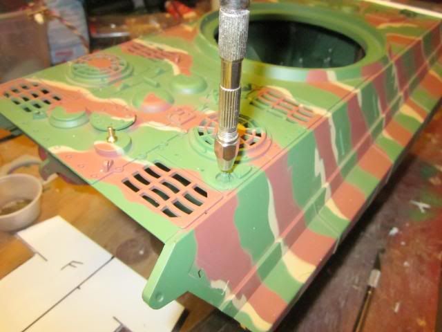

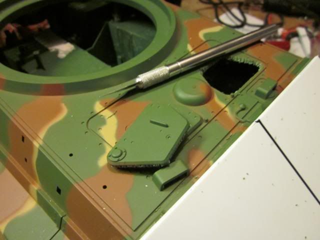

then I continued getting distracted and went after the hatches....since the drill was out and all......
then its connect the dots....with the razor knife...

Well, I spent about 2 hours working on the seam between the upper and lower armor plate....what a pia....might take a couple more hours...thinking about the turret. The tinny turret panther f turret is not going to cut it, to small for the kt 88mm...here is a diagram of the gun in the f turret...

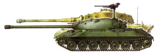

see the shell aganst the turret ring?....Nope, this tank needs something else...here is a pic of a king tiger behind a is7...

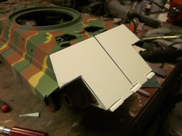

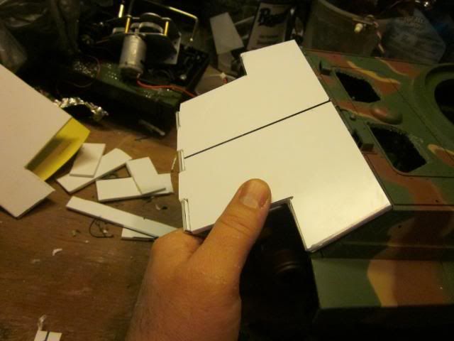

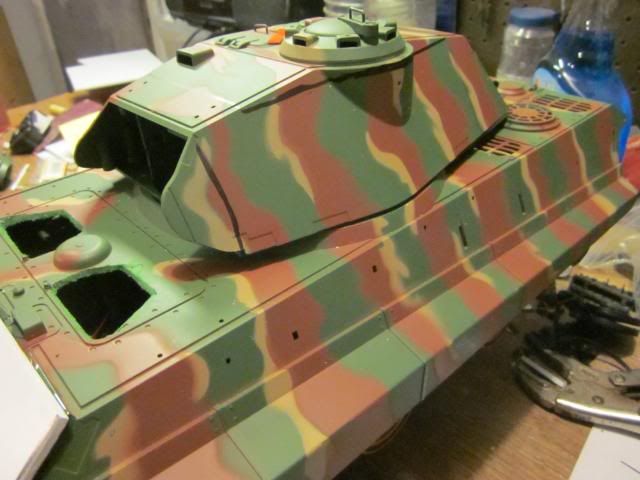

Well, been cutting and chopping again.....starting the redo on the upper armor plate....

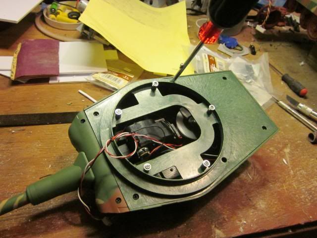

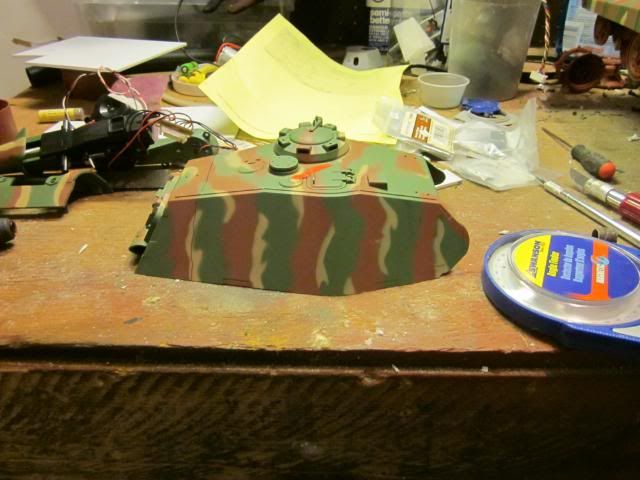

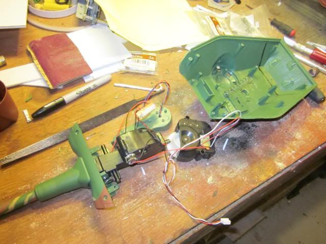

and let the glue sit....but I still have some more time so its on to the turret....time to brake down the sucker...
note that all of the workings of the turret are mounted on the roof....

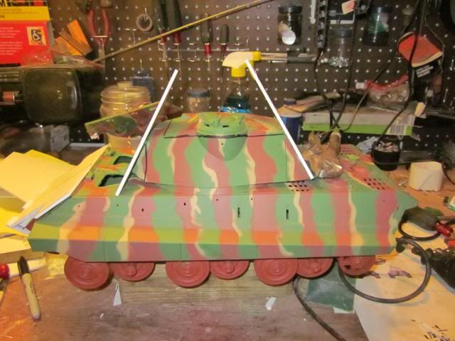

Well here is what i have to work with.....
The lines I have marked on the turret are how much I can cut off the turret with out hitting something I need in the roof of the to make the guts work....

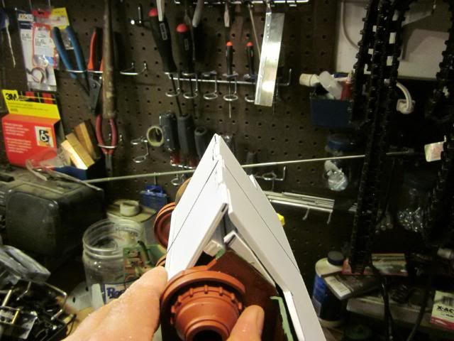

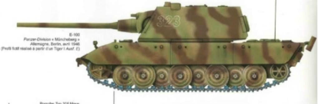

So what should I design? I am kinda thinking that if the germens had had time, they would have chosen to design something that was easy to produce...so the curver king tiger sides would not be an option imo. I think they would have gone with something like on of the E100 designs...just smaller for the king tiger 88mm... some thing like this....

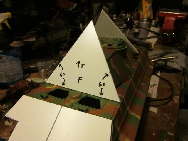

So off come the ends of the prosche turret...and on go some triangles with the slope I want for the turret....
Why triangles?...because I am not sure how tall I want the turret to be....on to more thinking.....
