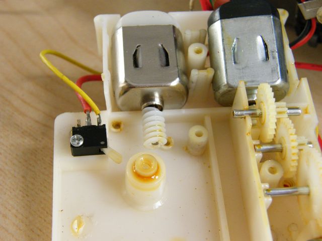

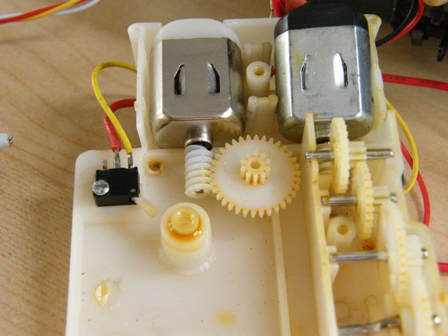

I finally got around to fixing the recoil, dropped in the replacement motor from Tankzone and everything is back to how it should be. I also found a source of replacement springs for the recoil, thought it might be an idea after the tip from Carnage, http://cgi.ebay.co.uk/ws/eBayISAPI.dll? ... 974wt_1175" onclick="window.open(this.href);return false;.

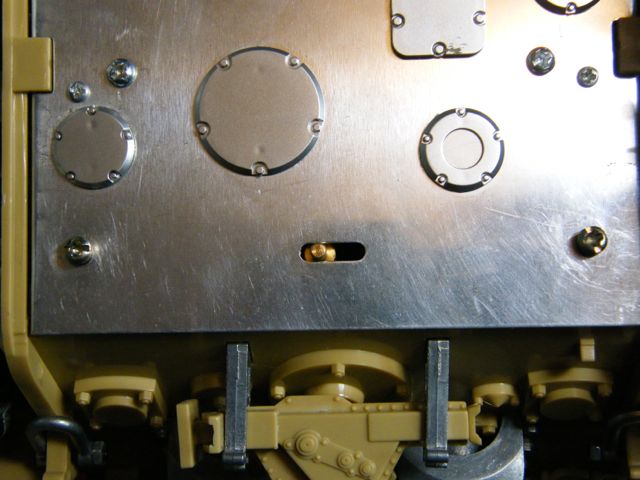

jukebox--i posted under "re-paint of torro king tiger" and received a response from caddyshack that refered me to your post on "torro 1/16 kt build"--i have just bought a torro kt in three colour cami--the panzer is good but i hate the colour and want to re-paint--i want to remove the upper hull and turret to protect the electronics from the spray off the paint---your first picture shows exactly this--my question is how is the upper hull and turret secured to the lower hull--there are two screws at the front and also two at the back end in "deep holes" ??????????---i do not want to take out screws unless i am sure of the resultant effect for obvious reasons--many thanks --best wishes---hue city

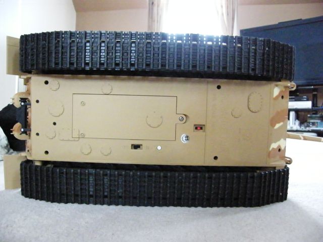

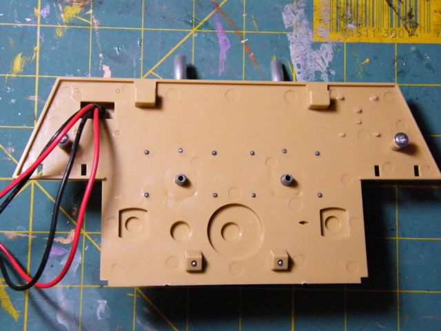

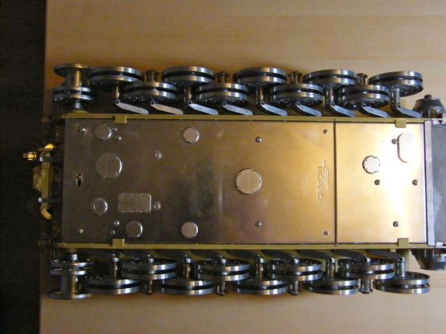

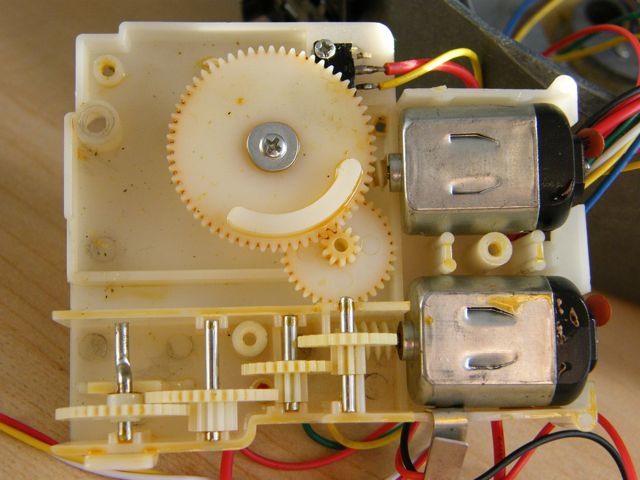

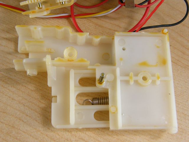

Hi Hue, not sure we are looking at the same tank here ??? , the upper hull on the Torro King Tiger has a quick release mechanism and is not held in place by any screws, the first picture below shows what the hull looks like from below, if you look at the second picture below you can see a small brass post in a slot in the centre of the hull at the rear, this is the quick release catch. It sounds like you are talking about the Heng Long/Waltersons King Tiger with the Porsche turret, the third photo below shows mine and the fourth photo shows the lower hull viewed from underneath, this has the deep holes you describe, there are also two more deep holes in the centre of the hull, you have to remove all six screws to remove the upper hull; once the screws are removed you raise it gently at the rear and slide out the front upper glacis plate from the lower hull sides. Don't remove the three screws grouped together at the rear, these hold the smoke unit in place. Take it easy the first time so you can judge how tight the internal cabling is as you need to tilt the upper hull to the side to get at the cable connectors so you can disconnect them. You will also need to disassemble the turret for painting, just go slowly and take photos at each stage for reference when you come to re-assemble the tank. :thumbup:
Torro metal hull
Torro metal hull
Torro upper hull quick release catch
Heng Long King Tiger - Porsche turret
Heng Long King Tiger - Porsche turret, lower hull

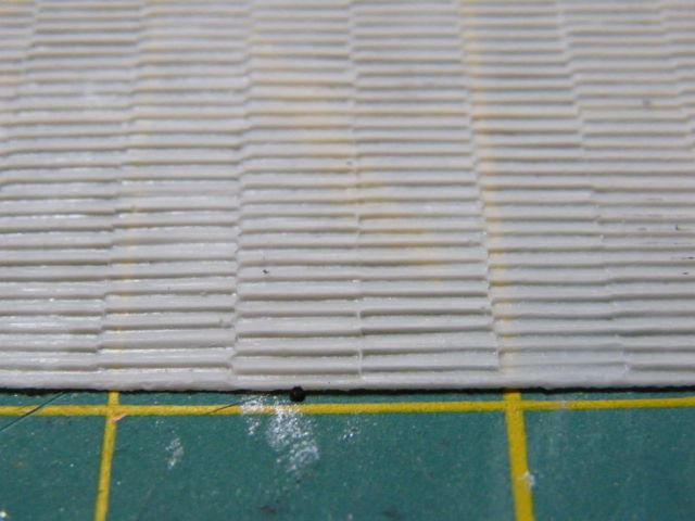

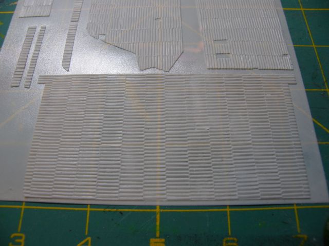

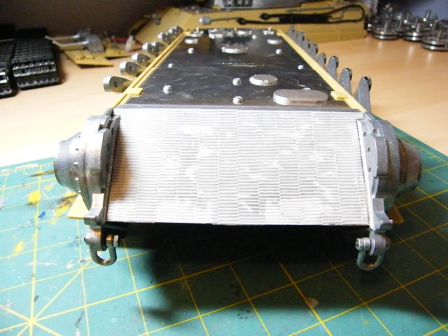

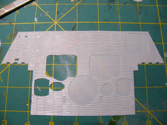

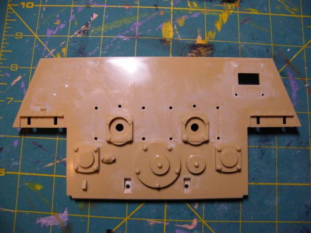

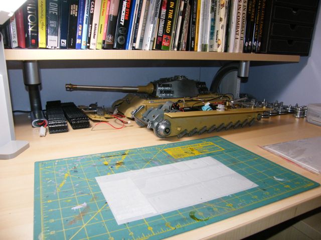

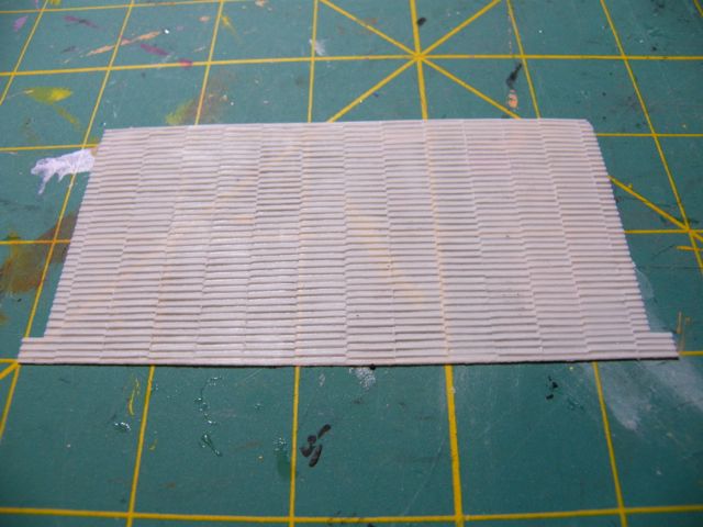

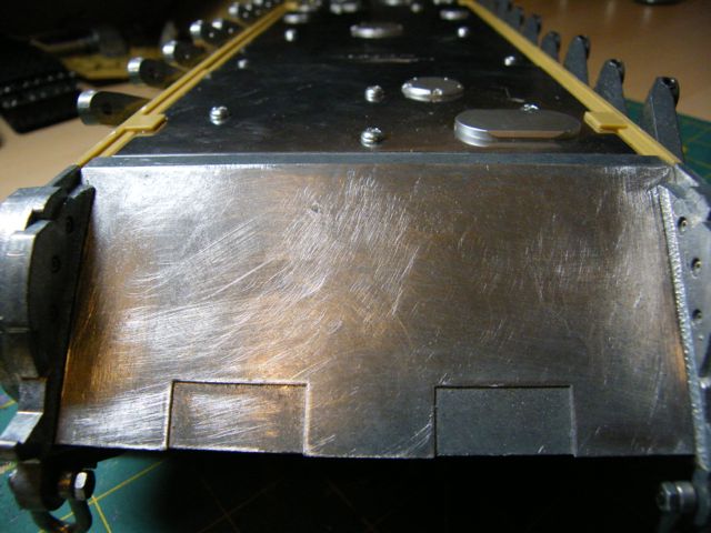

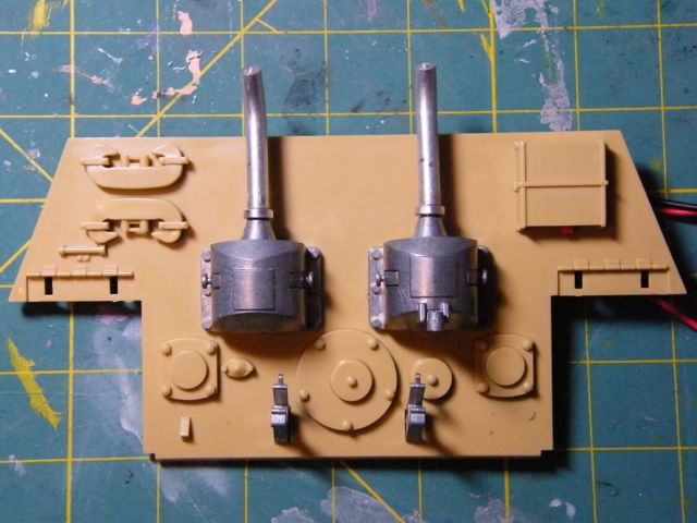

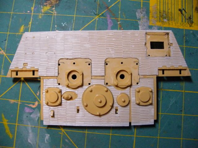

Finally had a bit of time to get the KT back on the bench, next job is to fit the Atak resin zimmerit to the lower glacis plate and the rear of the hull. The lower glacis piece is a good fit, can't say the same about the rear hull piece, but then it is designed to fit the Trumpeter kit! The Atak zimmerit is a good match for the moulded on zimmerit on the Torro upper hull, just looks like it'll need a bit of trimming and fiddling with. I used Zap Z-7 Debonder to soften the adhesive holding the various bits on the rear hull, still had to get a bit brutal with the metal bits to get them off though. I used epoxy resin adhesive to attached the zimmerit, that gives enough time for adjusting the position before it sets. Anyway, here's some pics.
Steve

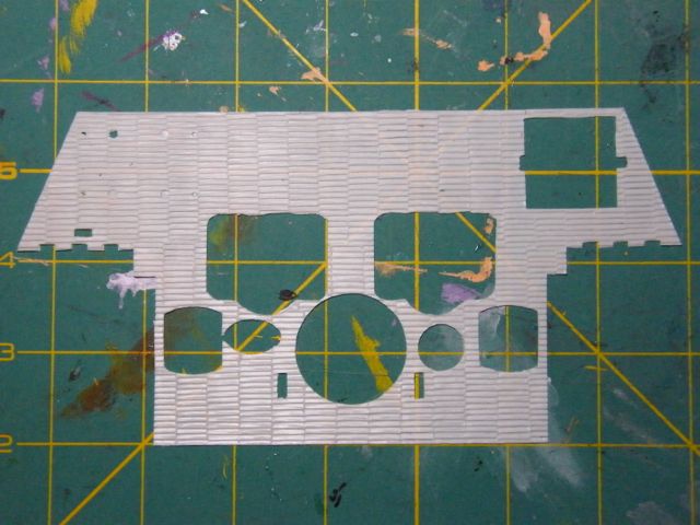

jukebox
Posts: 110
Joined: Sun Mar 13, 2011 10:50 pm
Location: Great Yarmouth, Norfolk, U.K.
Re: Torro 1/16 King Tiger build
Post by jukebox »
And a few more pics. Still a bit of trimming and filling the gaps to be done once the adhesive has cured.
Steve
