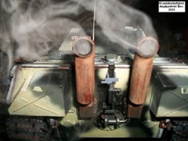

15ohms,.25watt ceramic wire wound resistors are the type and value in the supper smokers,fog fluid is the best for a nice smoke that is heavy,tends to stay together and sink behind the tank,Dan did alot of work developing the units.Also the matt for fluid retention is Kevlar.
This you guys may of seen,it's my Jagdpanther just sitting still,
Jagdpanther running
Jagdpanther running
Jagdpanther Smoker Test 002.JPG (93.92 KiB) Viewed 2648 times

Just checked and RC TANKWARS has pulled them from the site,I know the guy that makes these,he sent 10 to a vender in the UK,that person refused the shippment because of the VAT,the smokers never were returned so he has had issues with the UK postal system.
I know the design was last sold at half the size of the original units,I have three and Dietrich has one or two,he built one for my 1/200 scale Ariizona,I tested it,and it really poors out the smoke.The unit in the picture is,maybe 1.5 years ago,still works,their proportional,the picture is at idle. here is a picture of the unit as sold,for 50.00us or 32.50 uk.
