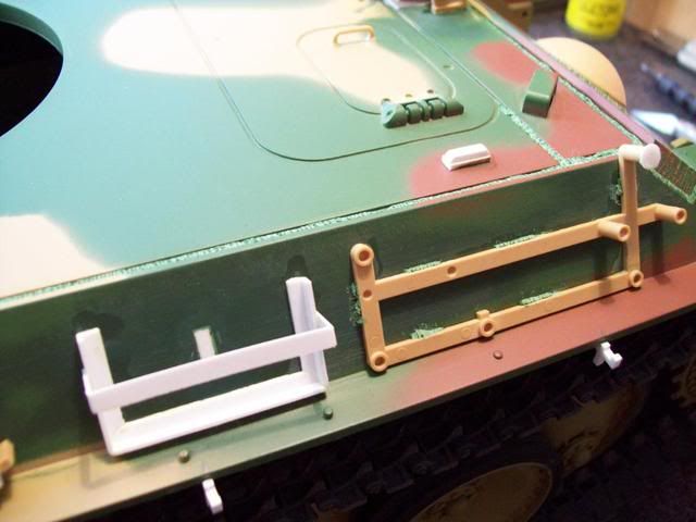

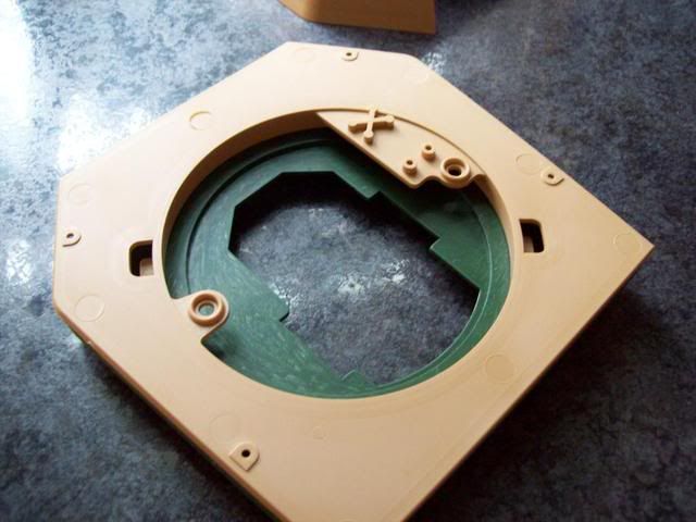

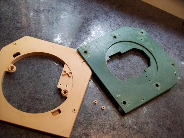

Just couldn't stand seeing the styrene just laying there :P
I didn't really care for the way the Tam part looked. Soooooooooooo........
I figured if I was going to go this far, might as well try making the handles right also...
More to come!!

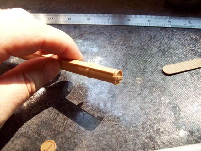

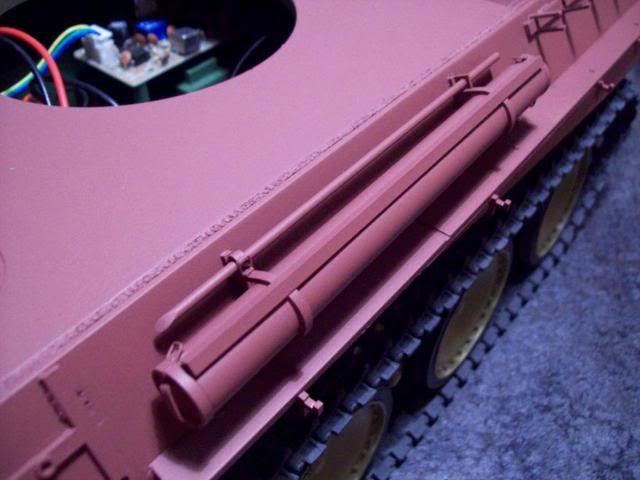

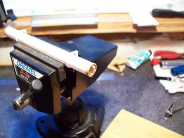

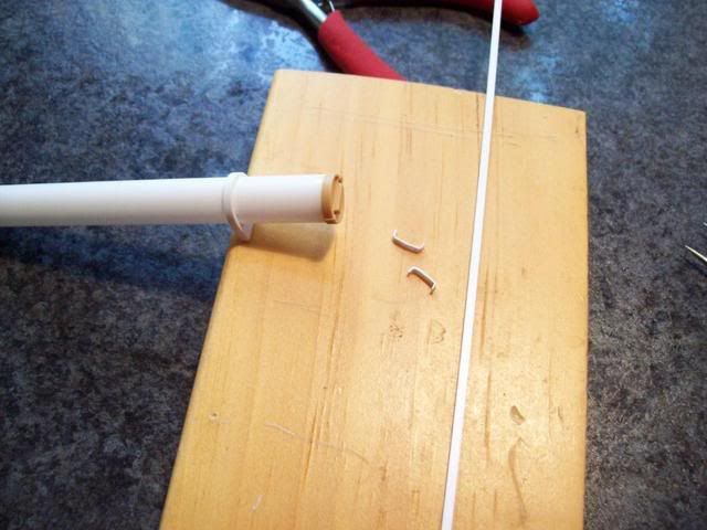

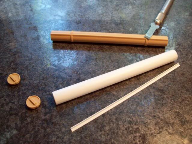

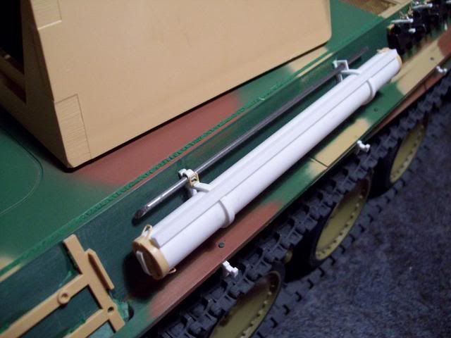

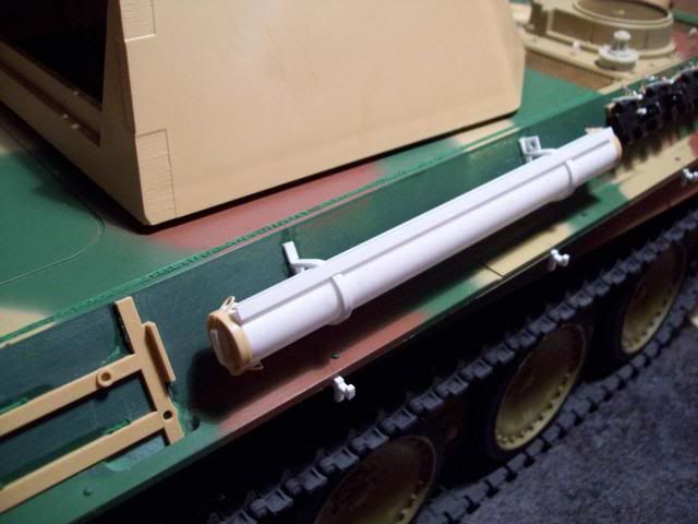

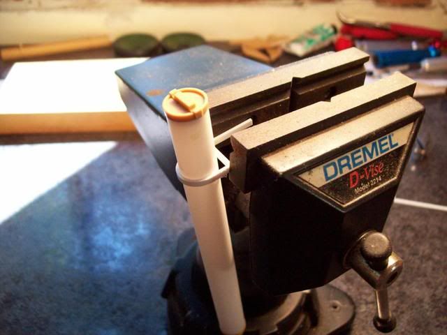

Storage tube complete!
I used stretched spur for the latch handles, and strip styrene mostly. The pry bar is 1/16" steel rod.. I will add the cover chain tethers berfore I shot the color.
Should have time to get to the jack block mount tomorrow... :thumbup:

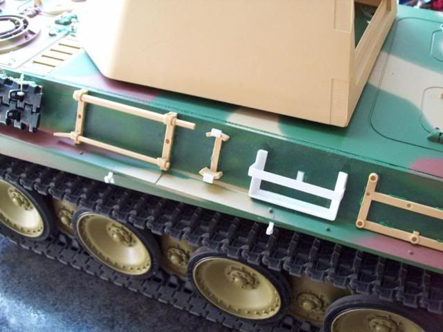

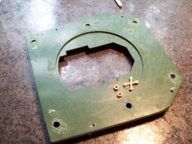

Turned into a lazy weekend but did manage some more minor detail work on the front fenders, reworked some of the weld lines and finished the jackblock mount.
I did start on the turret, but am going to hold off for a bit to get the Schumo early mantlet later in the week. The bases are almost the exact same height so once the holes were transfered I moved the standoffs from the tam plate to the HL one. I still have to open up the middle of the HL plate yet to make room for the tam recoil
More to come! :thumbup:

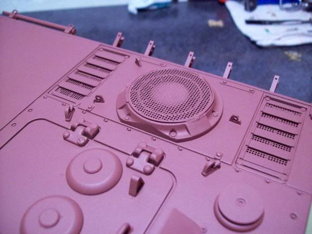

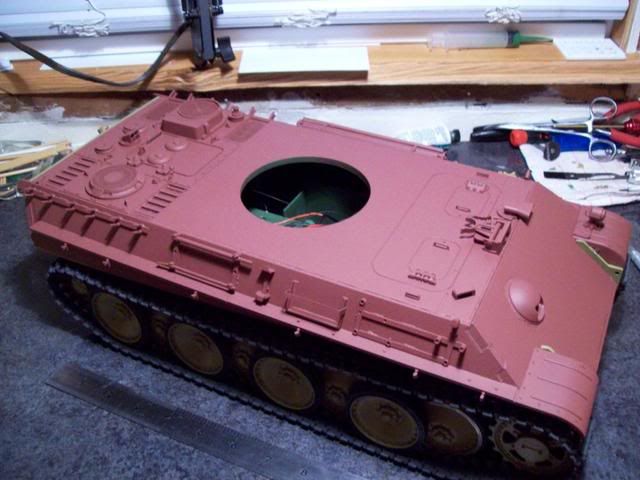

The calico look was gettting a bit hard on the eyes so I decided to shot the red oxide on it to check how the details and weld lines looked. I have been using Floquil acrylic scale primer and love it.
http://www3.towerhobbies.com/cgi-bin/wt ... I=LXG586&P" onclick="window.open(this.href);return false;
I took and modified the grill screen but narrowing it up with the dremel and running some stretched spur around it to get more of a scale look to it..
I have to drill some small pin hole where I intend to fasten the pin chains later on then will shoot it with a coat of Dunklegelb tomorrow..

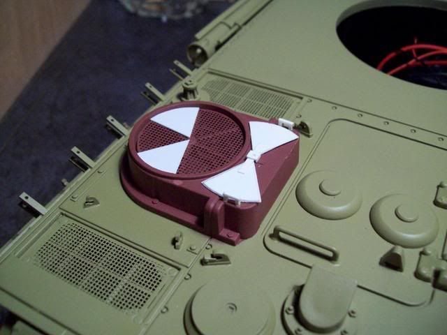

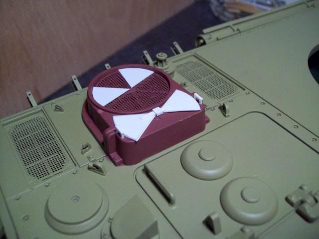

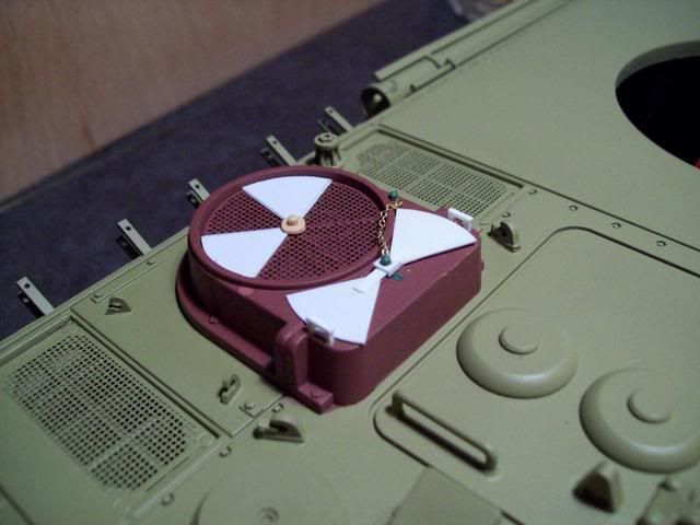

I can see this will be a never ending battle of details.. :haha:
I was surf'n the amortek forum for some ideas and came across some crew heater hood stuff that I just had to do. Now originally #321 did not have a hooded fan, which is why I left it red oxide and will be numbering it to give the look of a in the field addition. But I think this will set it off even more so now.
parts fitting..
and finished ready for recoating..
