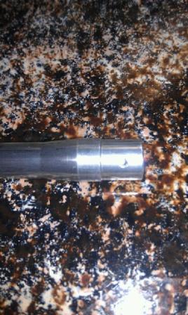

What would you like to know about the recoil? I took a pretty good series of pictures, especially the mantlet modification of Nick Aguilar's M34A1 unit and Ethan from DAK's rotor shield.
I also have pictures of the the turned down lip on the Tamiya/Impact barrel to allow recoil. This website doesn't allow files large enough to post a short video of the recoil, however if anyone wanted to see it I would be glad to send it to them via E-mail. Just send me a PM with your address. As a matter of fact, I will go ahead and post the pictures of the barrel/mantlet while I'm responding to this thread.

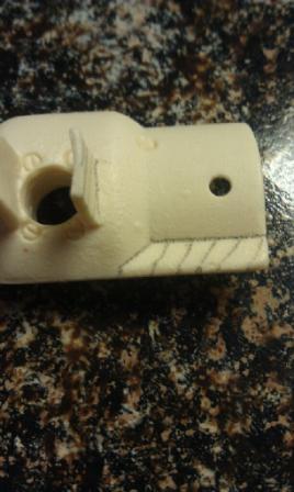

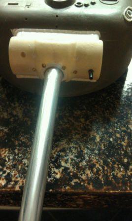

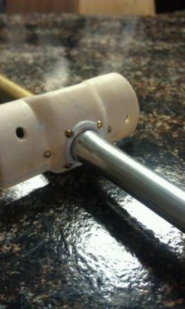

- There is a large ridge on the Tamiya/Impact 17 Pounder Barrel. This has to be machined down. The end is .488. It's slip fit for 1/2" K&S tubing. I used 17/32 tubing for the barrel with the brass extention to slide into. It also functions as a support for the mantlet as it protrudes through the 1 1/4" tubing supplied with the rotor shield. I will provide more detailed pictures of the assembly if needed. I will have to disassemble the turret when I do the texture and paint it. I will be glad to take a much more comprehenside string of phtotos for the asking.
- Turned down breech 17 Pndr.jpg (33.56 KiB) Viewed 5489 times
- I used miliput rolled out and formed around the tube I used for the outside sleeve of the recoil mechanism. I then used a small Dremel steel cutter bit to remove the Miliput for the 080 filister screws.
- Side View Of Completed Mantlet.jpg (23.33 KiB) Viewed 5489 times
- This shows how to extend the slots so the retaining bolts to the outside of the mantle allow articulation of the mantlet/gun in prototypical style.
- Rotor Sheild Converted.jpg (19.12 KiB) Viewed 5489 times
- I lined off how to cut off the mantlet bottom to follow the curve. It's then sanded to shape. The lip is used on the left side to extend the mantlet, then sanded to shape.
- M34A1 Mantlet Cut Guide..jpg (21.26 KiB) Viewed 5489 times
- Coverted Mantlet and Barrel.jpg (20.14 KiB) Viewed 5489 times
- Barrel 1.jpg (20.26 KiB) Viewed 5489 times

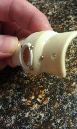

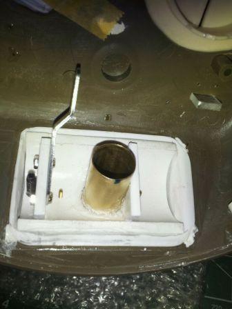

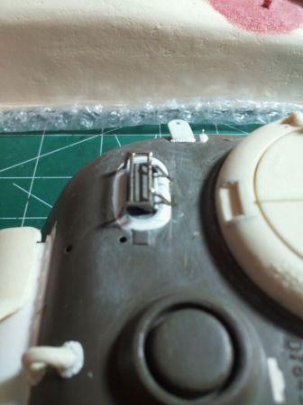

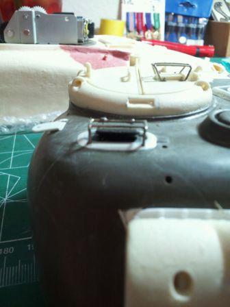

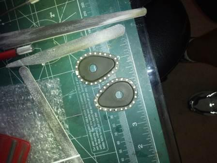

I completed the turret periscope guard installation today. As you probably know the gunner/commander's periscope has a different shaped guard than all the others.
Being I changed to the early style I needed five periscope guards. Buy the Pershing set, it'll save you about 15.00 over two sets of Sherman guards. You get five instead of three guards for about 8.00 more. I had to cut one of the guards up and solder the legs differently and straighten the front out. They solder well with silver solder. Here is the completed work.
-Dan
-Dan
- Open Periscope, Gunner's side.
- Open Periscope.jpg (19.46 KiB) Viewed 5455 times
- .50 M2 Early bracket.
- Open Scope and Commanders Coupla.jpg (19.72 KiB) Viewed 5455 times
- Modified Periscope Guard
- Above Commanders coupla.jpg (19.48 KiB) Viewed 5455 times

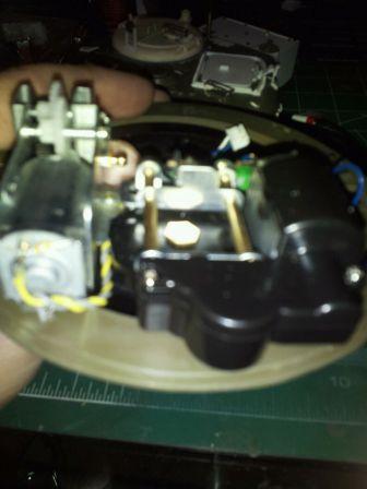

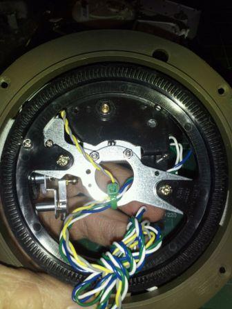

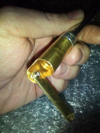

I have a few pictures to give you an idea of how I did the recoil. I hope this helps.
-Dan
-Dan
- Turret bottom
- Underside of Turret.jpg (29.23 KiB) Viewed 5450 times
- Turret Electronics
- Rear of Turret with electronics.jpg (18.43 KiB) Viewed 5450 times
- Barrel with recoil extention
- Barrel with recoil componets.jpg (25.34 KiB) Viewed 5450 times
- Mantlet Recoil Assembly
- Back side of mantlet for recoil.jpg (20.98 KiB) Viewed 5450 times

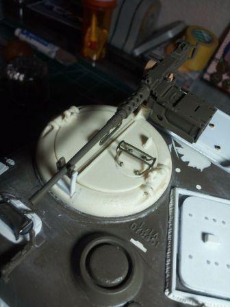

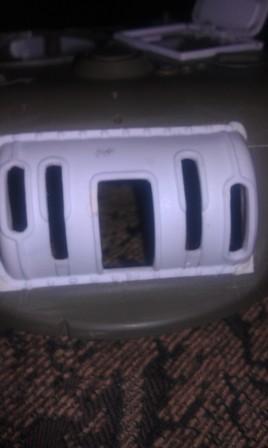

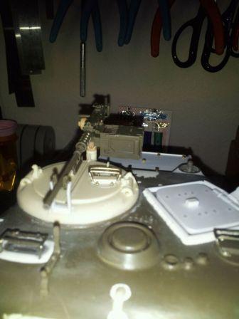

Well, in the few minutes I had to work on my AFV todayI finished the M2 .50 machine gun and the transmission covers. I still have to detail the .50. I did get the barrel drilled out, however I still have the pin locks and retaining chains to do yet, not to mention scavenging the pentle lock lever from the Tamiya kit and attatching it to the base of the cupola. In my haste I lost the original cradle, so I had to steal one from Super Sherman VW parts sprue.
As I had mentioned previously I am doing the VVSS suspension modification. I purchased an entire lower hull, so being the cheap bastard I am at times I used the old thread trick and removed the transmission side covers using the aforementioned method. I removed all the cast "titties" that were a poor attempt at making bolt heads and replaced all 56 in total on both with .080 hex rod bolt heads.
Anyway, here it is.
-Dan
Anyway, here it is.
-Dan
- Modified Mato side covers.
- Side Covers Transmission.jpg (24.08 KiB) Viewed 5441 times
- Front View, M2.
- Mounted .50 M2.jpg (18.55 KiB) Viewed 5441 times
- View from above. .50 M2.
- .50 M2 in rest.jpg (21.49 KiB) Viewed 5441 times
